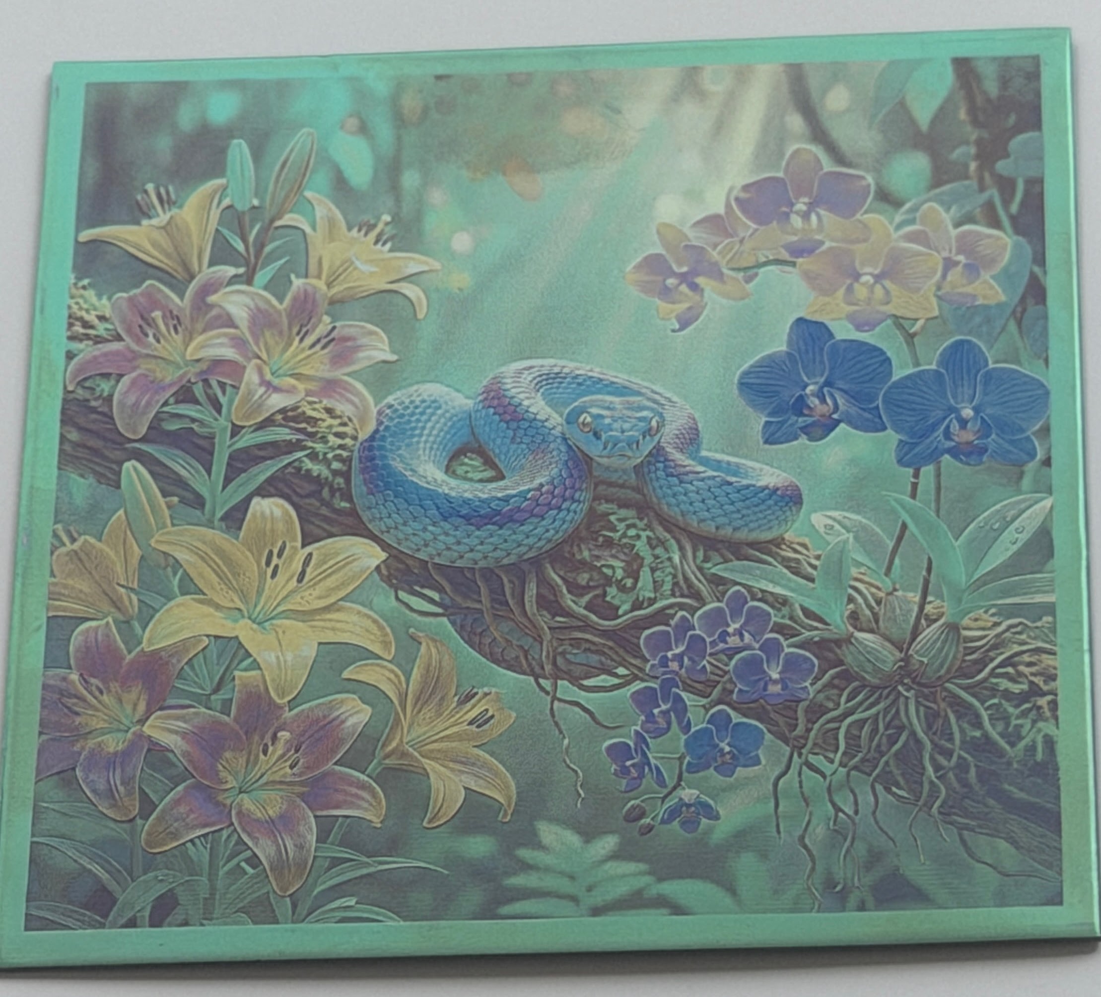

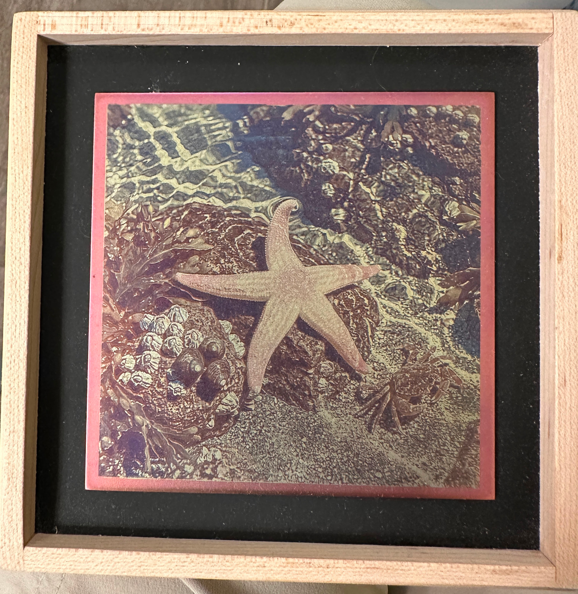

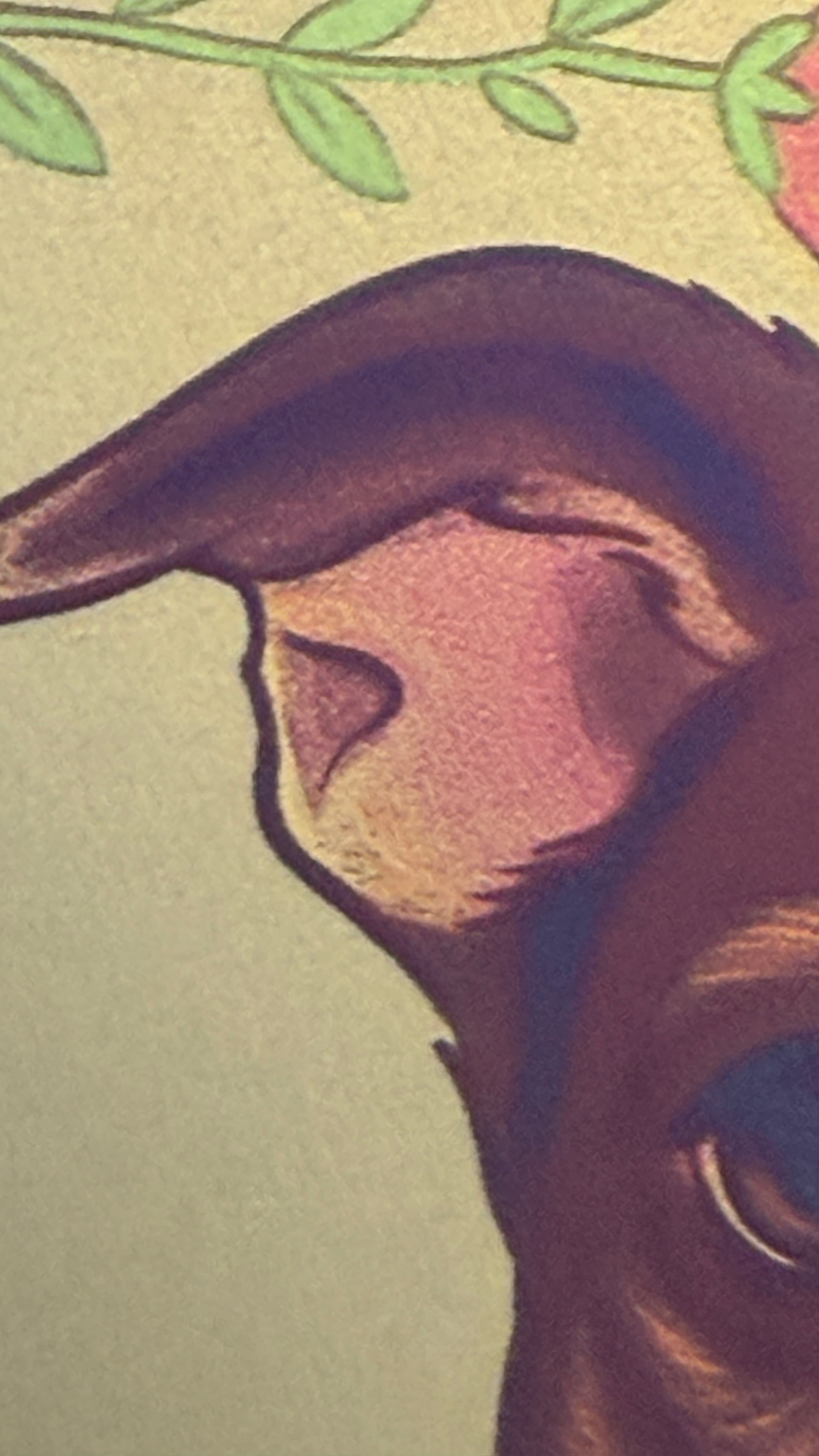

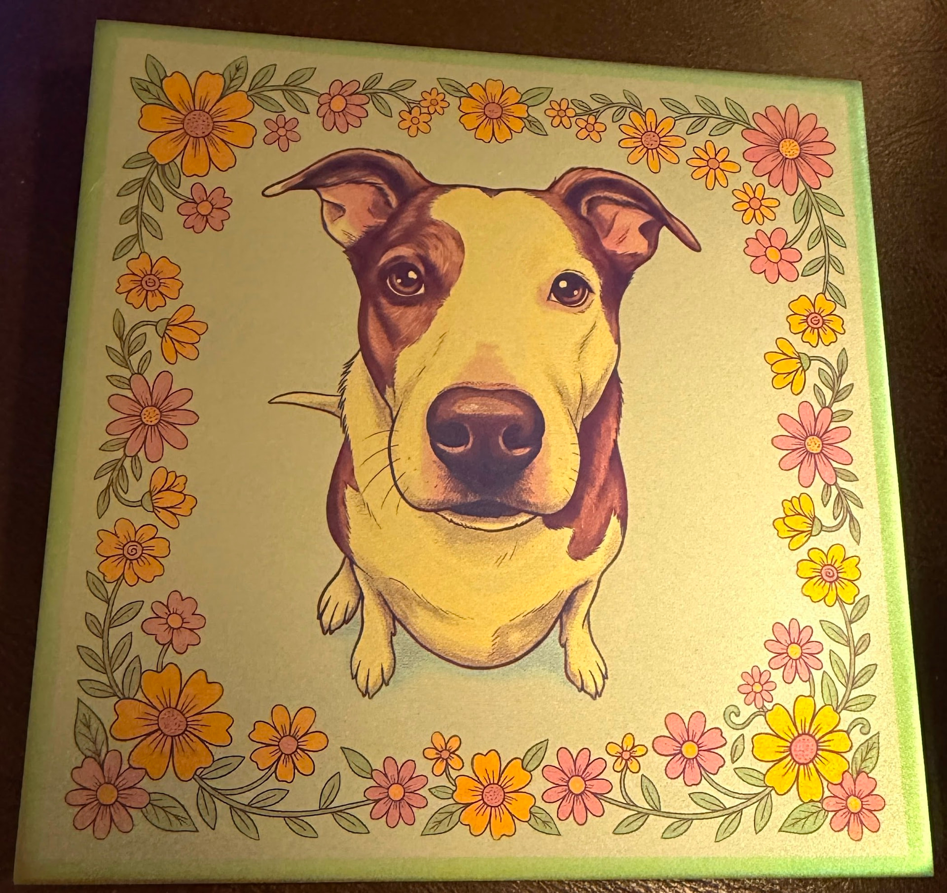

I am having a blast developing a way to use my xTool F1 to anodize/ablate full-color dithered mosaic images onto titanium. The images are 508 DPI, and I use python scripts to process photos or AI images into PNG files to ablate for the different colors. I anodize the bare metal to the highest voltage color, ablate the oxide off in the areas that should have the next color, anodize at that next voltage, ablate again, etc. The software blends the 5 to 10 anodized colors dots to make it seem like there are way more colors.
[Here’s](https://photos.app.goo.gl/ok9C2kT2osUa5ug76) an album of the dog showing the source images each ablation and anodization, and the resulting image.
[Here’s](https://github.com/markjernf/titanium-images) my GitHub site with a gallery and a lot more information about how I do this.
I would love to find collaborators if others are interested in doing this!

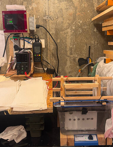

I forgot to explain that the last photo is my anodizing station: power supply, temperature control, and anodizing rig to facilitate dunking the sheets in TSP solution with voltage (up to 91 volts) applied.
Also, I should note that I find the pieces difficult to photograph. The thin film effects tend to freak out my phone camera. The pieces actually look better in person, especially when the angle to the light source is right and the anodized metal has a lovely glint. I put a video trying to show the glint in [my GitHub site](https://github.com/markjernf/titanium-images/tree/main).

Peter,
Thank you (and the others) for your positive feedback!
You ask an excellent question. The anodizing is actually what fully produces the color. The anodized oxide is the result, not an enhancement for the laser producing color.
The F1 isn’t very powerful, and I’m not using it to directly apply the oxide at all. Its role is to remove oxide in areas that will receive the next color oxide layer from the anodizing. This is a relatively low power operation so it goes pretty fast using the galvo laser (IR). All the ablation does is remove the higher voltage oxide(s) in the right areas for the next color so the resulting bare metal anodizes to that color. Your two watt IR laser should work fine for this.
There is some texture in the metal left by the laser, so the anodized layer is a little matte, but it still has a lovely anodized glint that I don’t think direct oxidation would replicate. And the colors are quite vivid and very consistent. Also, I think the matte metal surface helps me get a robust oxide layer. The sheets really light up with light from a full spectrum source when the light and piece are aligned so the source’s light reflects directly to the viewer’s eye. Off angle isn’t as vibrant which gives the pieces a dynamic aspect. The glint is more diffuse from the slightly matte surface which makes the pieces look better from wider angles
The oxide layers have no inherent color, it’s all derived from the reflection, refraction, and interference of the light interacting with the nanometers thick oxide. It’s called thin film interference which is also what gives bubbles and oil slicks their rainbow colors. The exact colors are entirely a result of the voltage I use for anodizing (with many other variables carefully controlled). During anodizing, the thickness of the oxide keeps increasing until its resistance is high enough to stop the oxidation process, so higher voltage makes thicker oxide. Different thickness oxides make different colors. To me, it all seems quite magical.
I too am a humble diode laser user. The F1 has two diodes: blue and IR. The IR is is technically a DPSS (Diode-Pumped Solid-State) laser, not a standard direct diode, but still a diode. 🙂
I really appreciate your question!

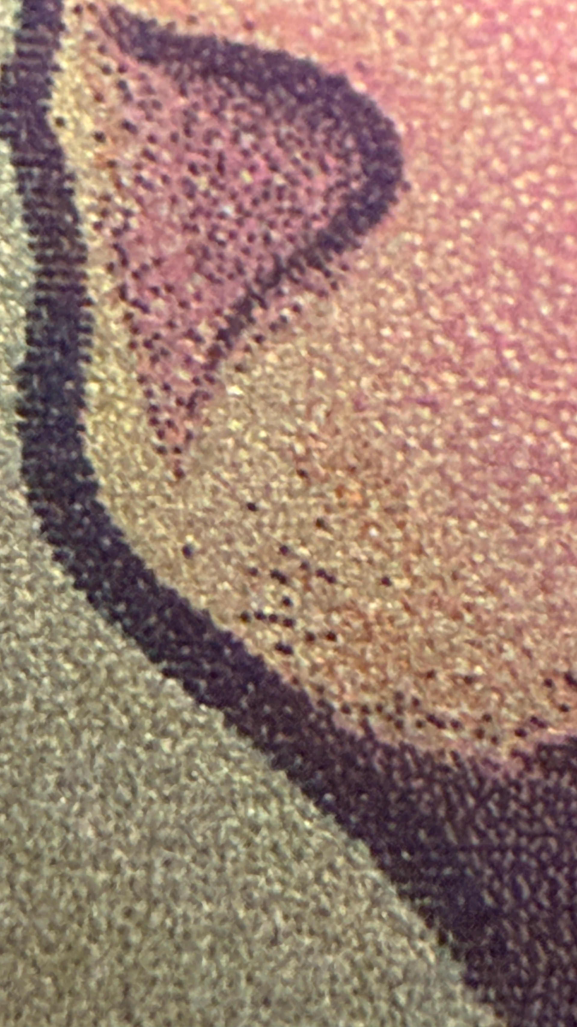

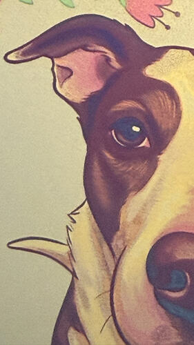

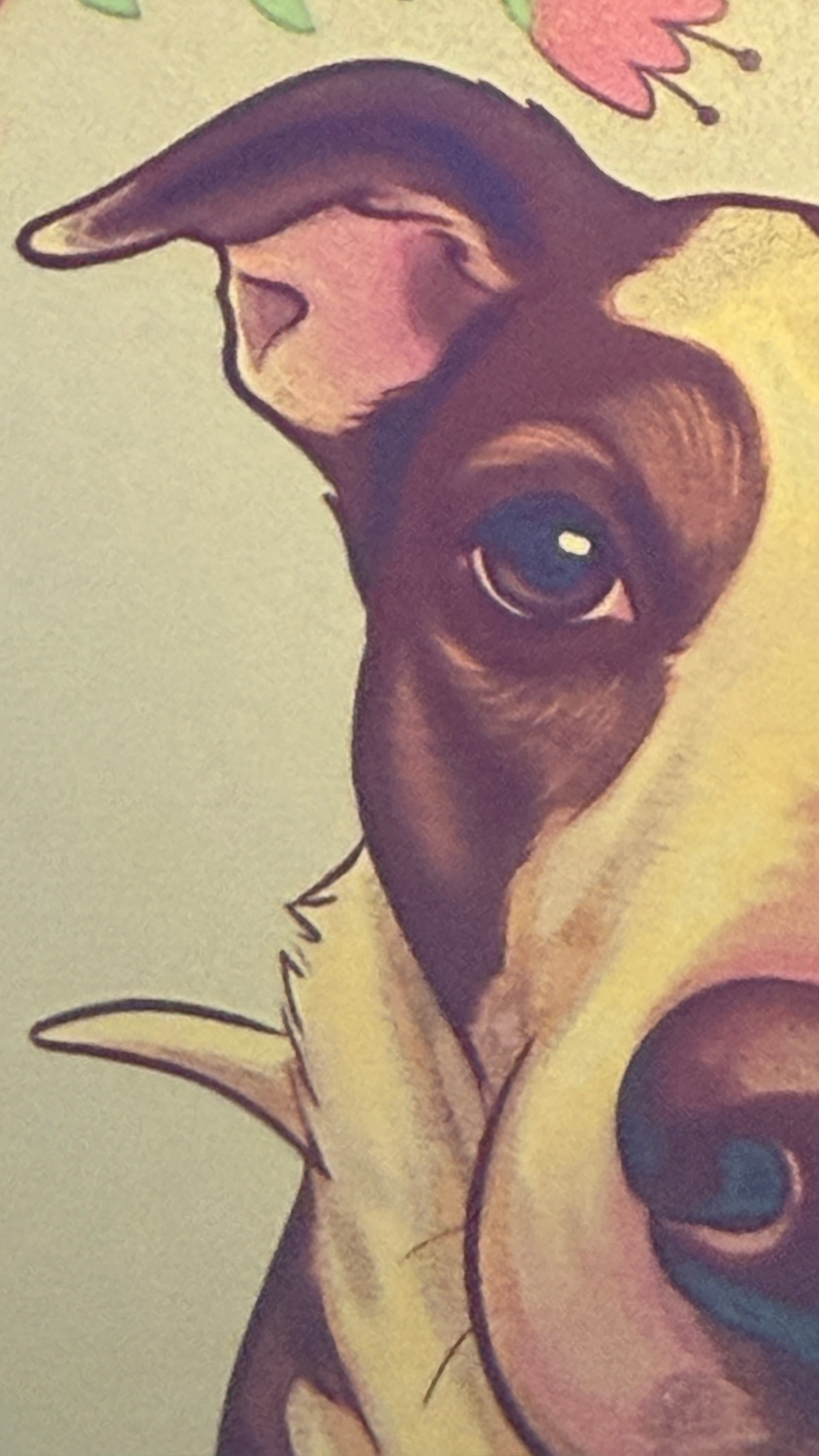

Tony,
You got it right! 😀
It’s a mosaic of single color “tiles”, and the tiles can’t overlap or combine colors. So there are literally only as many colors on the metal as anodizing dunks. The apperance of many more colors comes from dithering (Floyd-Steinberg) those few colors together. I attached three progressively closer images of a slightly different dog image (I already gave away the better one) to show the dithering. A lot f the work in this project has been finding better ways to control that dithering to get good results.
I experimented with CYMK-like ideas, but that ended up with separations that required a lot of adjustments and tinkering to look ok. The newest “colorimetric” separation engine tends to get much better results without tinkering. It knows a palette of 13 colors I can anodize and calculates how to blend those to get the right appearance (if possible given the palette and luminance the oxide layers can provide) for each local area. Claude knows the details of this much better than I. If you’re interested, I can ask Claude for a description of that engine.
One way I think about this is that it’s a subtractive process. Each layer removes areas on the metal left by earlier layers and put its colors in those areas. If you look at the Google album linked above, you can see this evolve.
A recent breakthrough was the realization that the dots are actually bigger than their 508 DPI area (ablation seems to have a threshold for single dots and once that threshold is broken, there is a radius around the dot that also ablates). I think there are other sources of dot gain like heat from nearby dots just ablated causing the ablation to be more vigorous. I had a piece that had disappointing results: bands in a sky that should have had smooth gradient, aquamarine areas that should have been a different color, and a dragon that came out darker than desired. I reported these issues to Claude, speculated that maybe dots were bigger than we thought, and asked if there might be a way we could compensate for that. Claude responded that this was a “textbook dot gain situation” and claimed with confidence that we could add a feature to the separator to address that. Claude was right. I now have a --dot-gain feature (1.6 is a good value: 1.6x the 508 DPI radius). This feature generates a second “metal” proof that predicts what the piece will look like on metal. It actually predicted the issues I had just observed on the disappointing piece - a very happy outcome! A second --dot-gain-compensate feature adjusts for the dot gain. After compensation, the metal proof is a much more reliable predictor of what the image will look like on metal.

I remember now, it was a previous topic about creating a standing wave in the oxide with a measured distance peak to peak and pitch angle..and some reading on oxide formation, all very interesting.
Maybe you could try some diffusion of the camera light/flash with some frosted plastic or other, to help with getting the best images of your work.
Thanks for the close-up’s Very cool, and a little hint of line interval. Did you try adjusting pixel dimensions to cope with the spot blooming.
<div class="post-metadata">
**Author:** ![markjern](https://forum.lightburnsoftware.com/user_avatar/forum.lightburnsoftware.com/markjern/32/125022_2.png) [@markjern](https://forum.lightburnsoftware.com/u/markjern)\
**Post date:** [September 18, 2026, 10:52pm UTC](https://forum.lightburnsoftware.com/t/i-invented-a-way-to-make-508-dpi-full-color-images-by-alternately-anodizing-and-ablating-titanium/192576/14 "2026-09-18T22:52:40Z")
</div>
Wow! Standing wave in the oxide sounds very sophisticated! I’ve only had the laser since February and know just enough about engraving to realize that I know very little. Yes, I too see a little line interval. I’m not sure how to adjust pixel dimensions (perhaps related to DPI?), and it may not be possible in XCS. I wanted to switch to LB to get away from XCS’s very bad habit of dithering my PNGs (ruined the whole point of what I am doing), but I made the mistake of updating the F1 firmware shortly after I bought it, and that firmware and LB are incompatible with each other. The published solution is to downgrade the firmware, but I found a way to get XCS to never dither before I downgraded, so now it’s not high priority. But maybe I should switch to get more control over the laser part of my work.
The dot gain adjustments greatly reduce the problems from the dot blooming, but I’m intrigued by the idea that pixel dimensions may be a variable I might be able to dial in to control that variable too. Compensating helps, but reducing will probably help even more, especially when still paired with the compensation.
Claude claims 508 DPI is about the finest resolution I can reasonably do on the F1, but your question makes me think perhaps I should challenge that assumption. It created PNGs carefully calculated to strictly fit 508 DPI so XCS wouldn’t dither when I set it to 508 DPI. That worked perfectly, and I haven’t revisited it. But I’m pretty sure the laser is doing more than 1 pulse per “dot”. Again, I’m not very knowledgeable about lasers, but perhaps that’s a good area for me to explore further. My dot gain success makes me realize that the physics of what’s actually happening on the oxide and metal matter in sometimes subtle ways. Plus, I’m intrigued with the idea of trying to make the ablation PNGs use the actual resolution of the laser. So many potential experiments and investigations and so little time!
I think using my SLR with manual settings and (as you suggested) consistent and more mindful lighting could help. I expect it would at least make my photos more consistent. Another potential experiment.
Thank you for your ideas!
