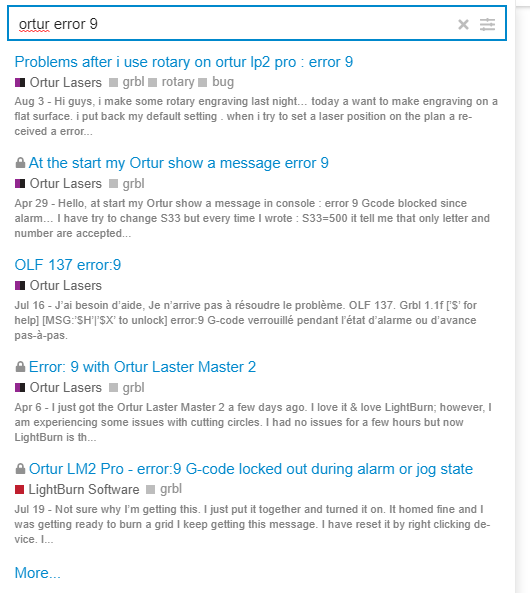

I keep getting error # 9
I keep getting an error code 9. My machine is firmly mounted to my desk and it is not getting bumped. What am I missing? The wheels and tracks are clean and it seems to be running smooth enough.
If you search for “ortur error 9” you will get the answers you seek.
I fixed the problem. About a month ago, I put one of those adjustable Z axis things on and I think the added weight added enough mass to cause the inertia to set off the shock sensor. I put the original adjuster back on and it’s doing much better. Do you have a list of all the error codes for an Ortur LM- 2?
