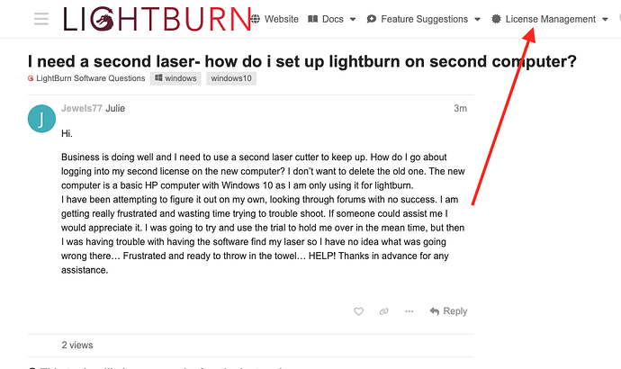

I need a second laser- how do i set up lightburn on second computer?
Hi.
Business is doing well and I need to use a second laser cutter to keep up. How do I go about logging into my second license on the new computer? I don’t want to delete the old one. The new computer is a basic HP computer with Windows 10 as I am only using it for lightburn.
I have been attempting to figure it out on my own, looking through forums with no success. I am getting really frustrated and wasting time trying to trouble shoot. If someone could assist me I would appreciate it. I was going to try and use the trial to hold me over in the mean time, but then I was having trouble with having the software find my laser so I have no idea what was going wrong there… Frustrated and ready to throw in the towel… HELP! Thanks in advance for any assistance.
We got you. Take a look at the link below to start. LightBurn comes with 3 seats, allowing you to use the current key to authorize use on up to 2 additional computers. Run the install, then enter the key to gain access. :slight_smile:
To help with moving / duplicating the current setup over to the new computer, you can use ‘Bundles’ to grab the configurations for transfer to the new system. Please review the following:
