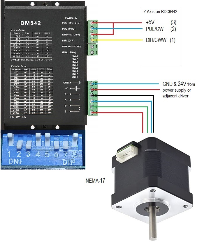

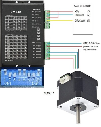

As with everything we do to our lasers, what works for some may not work for others. I have a 50w OMTECH and I got the idea (after doing a lot of research) from a guy on REDDIT who had a 100w machine. I did mine differently because my situation was different.
The REDDIT post that started it all.
I had some parts laying around from other projects like a NEMA-17 motor (https://www.amazon.com/gp/product/B09KC3V4VN/ref=ppx_yo_dt_b_search_asin_title?ie=UTF8&psc=1) with a mount, a handful of GT2 gears and assorted wiring. Some stuff I had to buy:
DM542 Stepper Driver
80 tooth GT2 gear with 7mm bore (that’s the diameter of the shaft the adjustment knob sits on)
https://www.aliexpress.us/item/3256803159093416.html?spm=a2g0o.order_list.0.0.3a1118021KAf8j&gatewayAdapt=glo2usa&_randl_shipto=US
There are some 20/60 tooth GT2 gear sets but I went with 80 tooth to get a finer resolution on rotation.
The picture shows how I wired it up (and the DIP settings I used) for my specific situation. I put the stepper where I did (in post #5) because that’s where it fit without getting in the way (a NEMA 23 was too big). Some have mounted it at the bottom of the cabinet, but I found putting it next to the knob worked best for me. My setup allows me to use the Z/U button on my RDC6442 control panel to access the Z axis and use the left/right arrows to move the bed up and down to manually focus, or run it down much lower so that I can use my rotary. Each situation is different, and you really can’t just say “here are the parts, here’s how you do it”. For about $40 and the parts I had on hand I was able to get something that works very well for me. Good luck.
