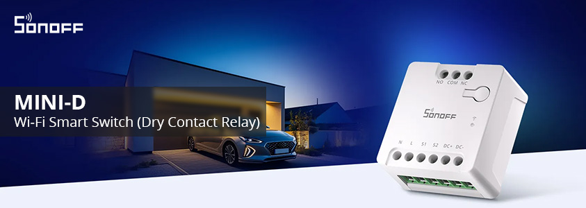

Based on a casual search, I think the S1/S2 terminals on a Mini-D are “dry contact” inputs:
Presumably the switch closure would send a message somewhere.
If so, then use the controller’s Wind output to close a relay connected to those terminals. A solid-state relay might work; if not, then one of these:
https://www.amazon.com/HiLetgo-Channel-Module-Isolation-Support/dp/B00LW2H5GC/
Which would need a connection to the 24 V supply, but that’s nearby on the controller.
