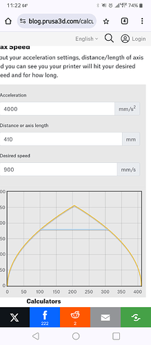

Also, I am having an issue with rapids speed in Lightburn specifically. The K1 Pro can do 54000/mm/min according to iKier. I have verified the latest firmware and machine settings are as such in config.
With jogging, it does not go at full speed in Lightburn. If I close Lightburn, open OpenBuilds Control, it moves the K1 at lightspeed comparatively…
Is this a known problem in Lightburn software as a defect? Or am I missing something?

IMO, jogging wouldn’t seem to be a valid test.
Program a job with that speed and a power of 1% and see what it does.
I have the 24W version of that machine and I can say with confidence that you won’t be doing any work anywhere near those speeds anyway.
That’s a statement based on the matter of power over time and laser PWM response.
As far as mechanical limits, I believe the practically unusable “fast” mode uses an accel value of 4000mm/s². It’s got so much bounce and ringing that nothing looks good. My testing shows “standard” mode (2000, IIRC) is near the practical limit with the much lighter 24W module. Mine still shows ringing at this level of acceleration.
Plugging those numbers into a calculator gives the following… Even at 4000 (which will look terrible) you’re using half of your total bed for acceleration. At 2000 (probably still too aggressive), it reaches full speed for about 5mm before needing to slow down again.
 ![Screenshot_20240508-232258](https://forum.lightburnsoftware.com/uploads/default/original/3X/f/f/ffec41d2dbdf48603254db1af549d1ee36b51ac7.png)
 ![Screenshot_20240508-232413](https://forum.lightburnsoftware.com/uploads/default/original/3X/1/d/1d83ea11910e78caebd5cac1befff9b1f3a1b90f.png)
