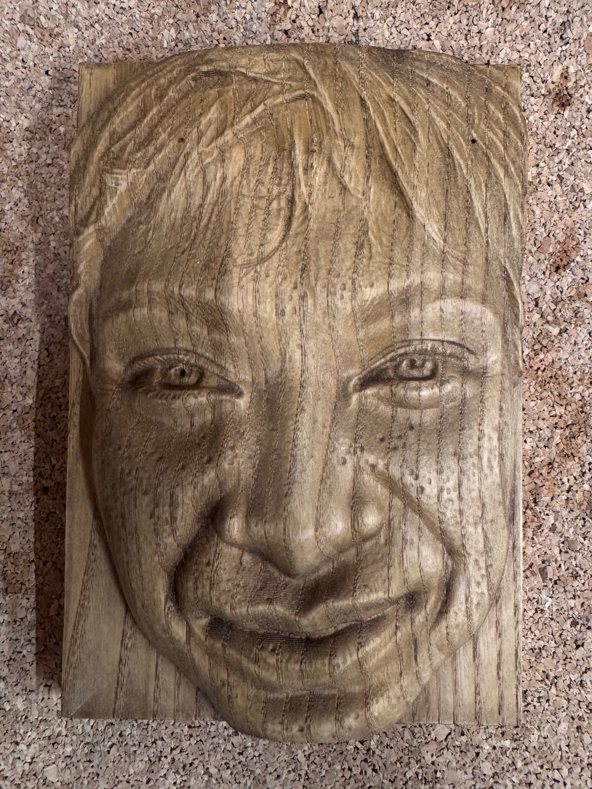

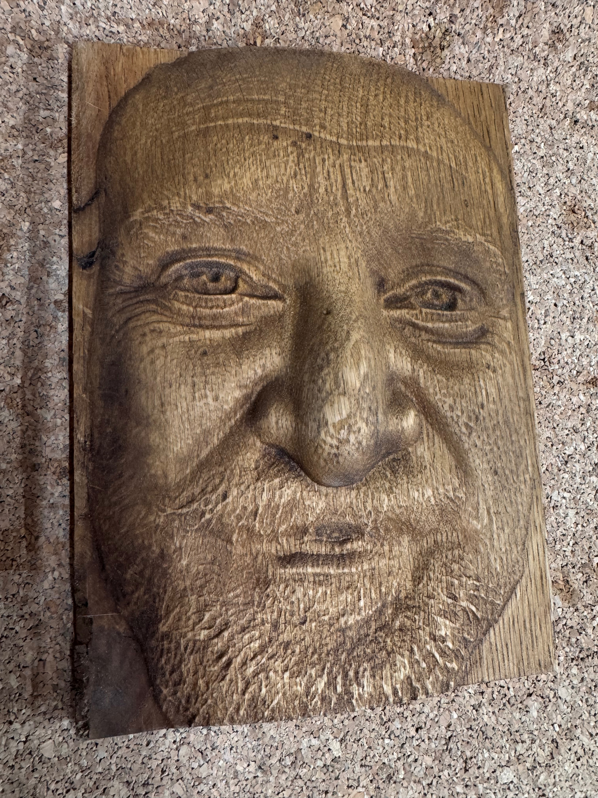

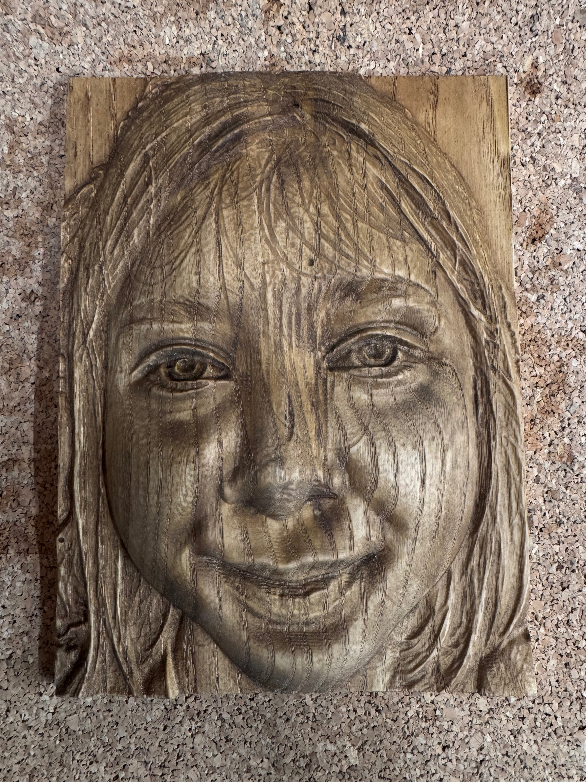

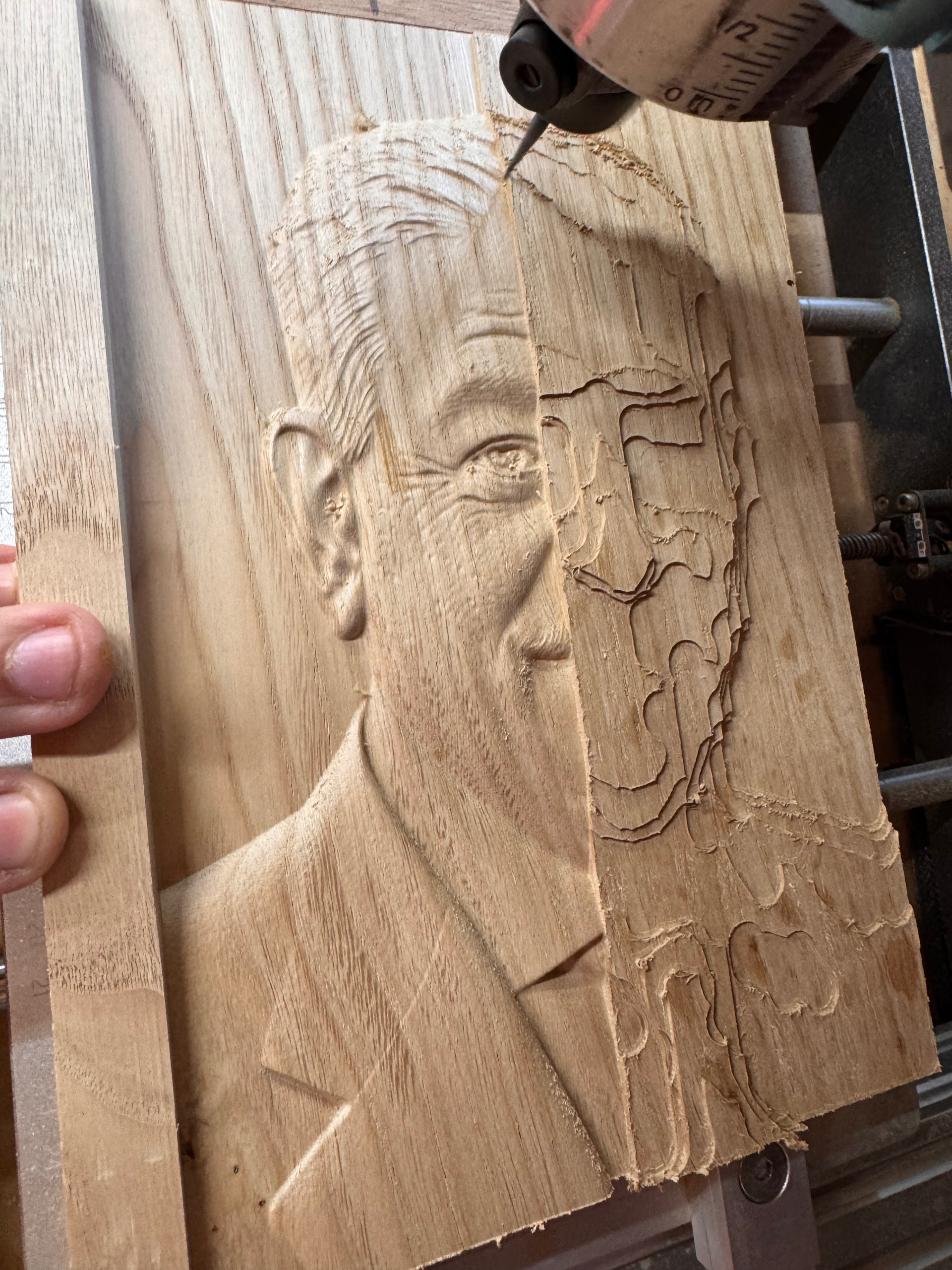

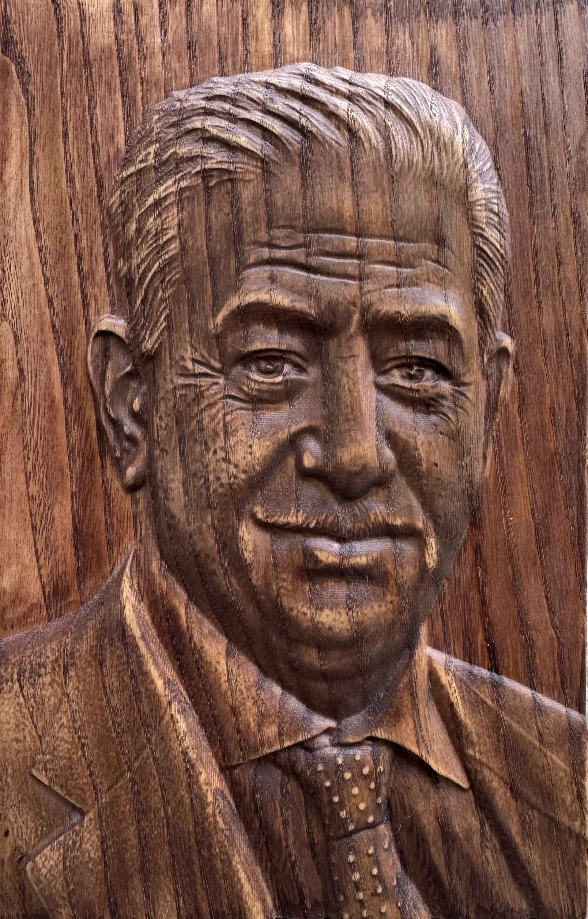

First of all, thanks for the replies; it’s a pleasure to have found this forum, and I hope to learn a lot. I’ve always done woodworking as a hobby, then I got into laser work using LightBurn. Later, I bought a small SainSmart Genmitsu 3020 Pro Max V2 CNC with a 700W spindle (a Katsu trim router) and started doing small, quick jobs. Now, using Millmage and 2.5D carving, things are more demanding; being an enthusiast, I’ve started engraving faces in bas-relief. It’s a massive undertaking, but the final result (taking 29 hours on average) is spectacular—I’ll attach some photos if you’d like. You can imagine that running for 29 hours with a brushed spindle is a recipe for disaster, so I’ve already switched to a 500W brushless model; it has lower wattage but higher torque, and it doesn’t sound like a tornado. I’ve already figured out the cause of the stalling issues: one was the lack of shielding on the data cable (a 6-meter USB cable)—turning on the table saw would sometimes cause interference and signal loss. Another issue (now resolved) was that when I paused the machine and left the PC on, Windows would put the USB ports into sleep mode; I’ve since adjusted the settings to keep the ports active. Sorry for rambling, but I have so much to share. Anyway, as suggested, I need to study some CAM software to understand how to resume from a specific coordinate. The problem is that with 3D finishing passes involving 60,000+ lines, the image becomes hard to read, making it a nightmare to find the exact resumption point—but as I said, it’s all a matter of experience. Thanks a lot, everyone.
Please do. There is Finished Creations section that is just perfect for it.
Thanks, done.
