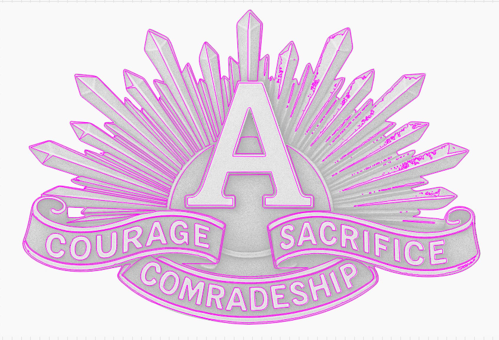

I am trying to trace and edit an ANZAC Day Rising Sun Badge. I’m incredibly new to the industry and my primary business has been bare basic engraving plates on my laser machine.
I’ve tried a few different images but get stuck on refining it to break it to lines and fill. I get some sections ok but then it doesn’t work for others.
The Shading is what isn’t working for me. I tried removing the lettering but that hasn’t exactly helped either.
Attached in the word document are examples of what I’m trying to achieve, where I’m going wrong etc.
I’ve now spent over 5 hours trying to do this. The simple answer is to ask for help. Is there anyone who can help put this in a LightBurn format for me please.
Guidance for figuring this kind of thing out is welcomed too please.
The word document didn’t upload but I’ve attached some examples of my attempts!
I’ve occasionally needed to use various non-vector images, and often I’ve gotten results a bit like yours. I’ve generally found that having a program (LightBurn, or usually Inkscape for me) trace them doesn’t get me to the finish line regardless of attempted settings, but I do have methods, and maybe they might help you…
  1. If I can find an existing vector image (SVG, usually, but sometimes embedded in a PDF somewhere) I’ll use that either by itself or just to get some/most of the image. For example, Wikipedia has a Rising Sun badge page with a SVG that, while different, may be useful.
  2. I’ll take multiple traces and select only the good parts to cut and paste together to compose a “clean” design. (The lower right trace, for example, would be pretty good for cutting the text to paste into the design from the Wikipedia SVG, replacing its text and center element.)
  3. Manually cleaning up little glitches in a trace by node editing is usually a required/desired step, as it’s easier to excise a “bubble” by just editing it than trying to get a perfect trace (which may not be mathematically possible, even). I personally really like Inkscape for this step, but I have spent years becoming fluent in the power of its UI – LightBurn is always getting better, and if you aren’t fluent in either, either should do, I imagine.
  4. If… when… all else fails, I’ve used Inkscape’s bezier curve pen tool to just manually trace a design. There’s really nothing that compares to a human when it comes to tracing, as you inherently know what’s important. It obviously takes longer, but I know I’ll end up with a useful result.
In the case of your image, I’d likely use a programmatic trace to get the text, the Wikipedia SVG for the shapes of general design, and manual editing/tracing to add the tip detail the SVG doesn’t have.
(I’d see what I can throw together for you, but I’ve got to head off to work. If you’re still struggling, perhaps I can give it a whirl later and put together a design as a kind of explanation/tutorial with a conveniently useful result, if I can make some “spare” time.)

It makes sense to analyze an image and discover recurring patterns… for example, the element highlighted in red repeats multiple times. And the elements highlighted in blue are mirrored. Thus, the solution of splitting the image into sections and editing only those is probably the fastest way.

I’m a bit late to this party and not sure if this is still needed but I made a start.
Could do with a tidy up and more node edit tweaking to add extra ‘light’ to the sun rays, which I started on at the left side as you can see…
courage.lbrn2 (1.3 MB)
It was an interesting exercise working with this file as it has a lot of shading/noise which makes it more difficult to get a decent trace.
