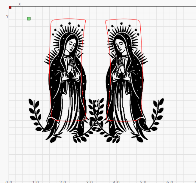

Hey group, is there a way to put this image inside the red area?
Any help is appreciated.
 ![MG](https://forum.lightburnsoftware.com/uploads/default/original/3X/5/9/59d628b92105d5e9123ad7d18769ccc0acb4c092.png)

Look up “image mask” in the LightBurn documentation

Do you mean to scale the image or to crop it to the size of the red area?

Yes, so the image is inside of the red area which is the cut out.

I did this one a while back. It is scored and cut - no engrave.
[OLG.lbrn](https://forum.lightburnsoftware.com/uploads/short-url/b75GsMeo5iYNmCxeuj1D49RCVWL.lbrn) (180.8 KB)
