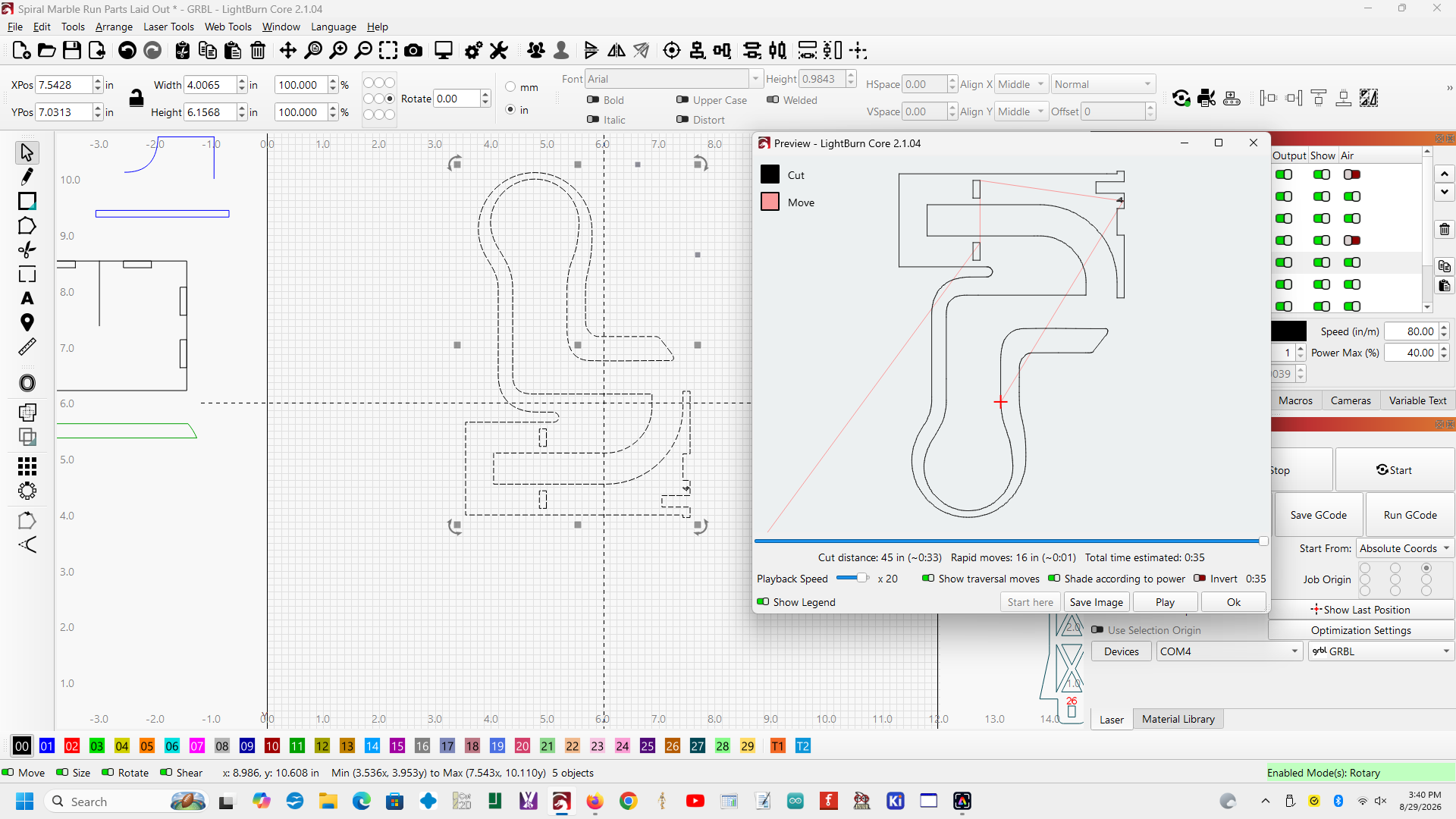

Image inverts when previewing
When I preview an image the image is inverted. This just started happening and I can’t find a setting that would control this. It inverts vertically.
We are going to need an image capture for this one. SHFT+WinKey+S for Windows, I have no idea how for a MAC.
Open the Preview window and slide it over so we can see it and your design. Then capture the entire thing.
Which version number are you seeing along the top bar in LightBurn?
Have you recently changed the location of the origin in the workspace or in the device?
Import the image again and confirm that both images are oriented correctly in the workspace and in the preview.
You have Rotary Mode enabled with Mirror option.
Disable Rotary and try again.
That is the answer! I disabled the laser and mirror and the problem is gone. Thank you very much!!
