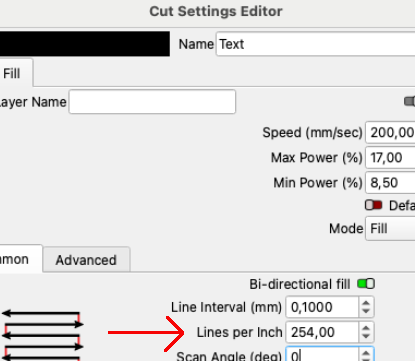

> [@bernd.dk](#):
> example 256 lpi which corresponds to 0.1 mm line spacing
I think one of us is off in the math. An inch conversion uses 25.4mm/inch. If I set mine to 254 dpi, I get an interval of 0.10mm. 256 gives me an interval of 99.22 dpi.
One of the best videos is from Laser everything. I suggest you watch it.
[![](https://img.youtube.com/vi/EB40S6AEVwE/maxresdefault.jpg "The COMPLETE Photo Engraving Guide Part 1 | Fiber CO2 UV and Diode") ](https://www.youtube.com/watch?v=EB40S6AEVwE)
If I remember correctly, it covers what you want including a talk on how to use _ **dot width** _ with the creator himself.
<div class="post-metadata">
**Author:** ![bernd.dk](https://forum.lightburnsoftware.com/user_avatar/forum.lightburnsoftware.com/bernd.dk/32/125208_2.png) [@bernd.dk](https://forum.lightburnsoftware.com/u/bernd.dk)\
**Post date:** [May 20, 2026, 3:59pm UTC](https://forum.lightburnsoftware.com/t/image-pixel-size-and-dot-dimensions/189875/9 "2026-05-20T15:59:18Z")
</div>

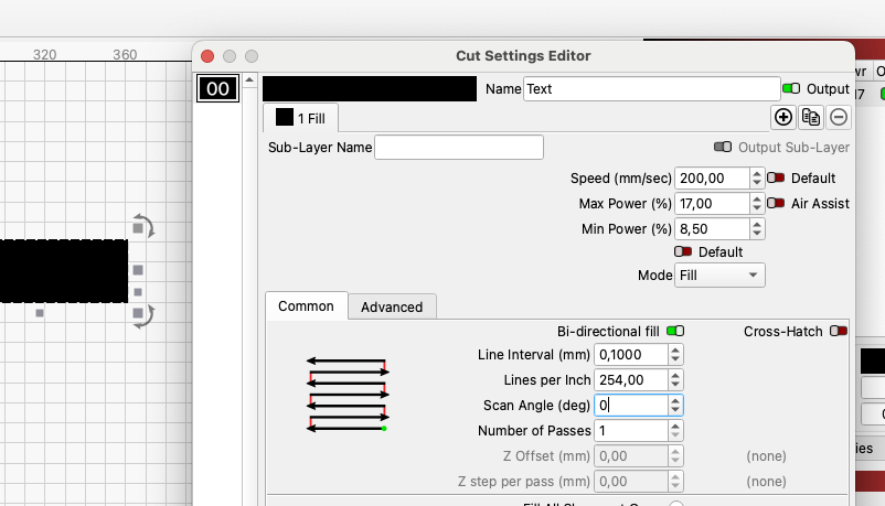

I am referring to lines per inch and Line interval in mm from LightBurn’s Cut setting editor, I have not referred to dpi and am also aware that there is a difference.
 ![Skærmbillede 2026-05-20 kl. 17.43.40](https://forum.lightburnsoftware.com/uploads/default/original/3X/d/1/d1c05ef2e7c1e64ff1e940e60d30d4ee302e466e.png)
**Post date:** [May 20, 2026, 5:28pm UTC](https://forum.lightburnsoftware.com/t/image-pixel-size-and-dot-dimensions/189875/10 "2026-05-20T17:28:42Z")
</div>
So did you fat finger the 254 to 256?
 ![image](https://forum.lightburnsoftware.com/uploads/default/original/3X/4/7/47688ddd45503684db5c973a25fd8da3cda045b3.png)
Your screenshot says what I though I stated.. I don’t think we’re communicating and it isn’t worth the time, as I’m sure whatever you’re referring to is likely correct.
