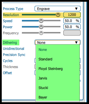

In your Epilog Laser, can you adjust the resolution? LB has that ability
I can. I engrave on 500 dpi, which hasn’t changed. I have kept the settings in LB to be the higher resolution for Inkscape, as my default since I started using it 4 yrs ago. It’s not a big deal, but would like to know if I need to start using Inkscape more for my more detailed engravings.

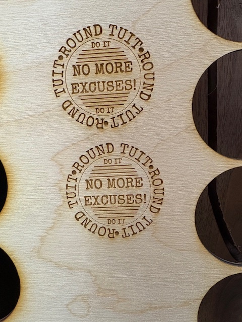

gonna run a test so I can show everyone what I mean.
Ok, so, I’m obviously am kind of a doofus. I just ran at test right next to each other and the quality is too similar to tell the difference. The top is LB and the bottom is the same svg from Inkscape with exact same engrave settings in the Epilog Dashboard. I welcome your thoughts, but the LB one looks a little “oversaturated”, which is I think the issue that concerns me. The clouding is just from the air assist, but not certain why it wouldn’t be the same on the one from Inkscape, but that’s another chat room. LOL

It is a vector and yes, that’s what I’m figuring out. Maybe the difference is simply the variance in the wood itself.
Thats very interesting. At first I thought the font in the LB ver is a fraction bigger.
Then I thought the LB ver is darker so just appears bigger, but your settings are identical for both, so…is the black (color value) in LB darker than the Inkscape version and so giving a slightly more powerful burn.
Its the wood (sounds less nuts!)
I see a difference in the wood color under each engraving. Wood gets my vote too.

It is actually 72dpi for Illustrator verses 96dpi for Inkscape. In my understanding, that has more to do size. When you print to the Epilog Dashboard using Lightburn, you can set the resolution of a vector engrave. You are also provided with similar choices as LB for raster engraving
Yes, I’m familiar with those settings, but on normal vector images I leave the resolution at 500 and the dithering at standard, so the only difference is the image output resolution from LB to Inkscape. Are you using an Epilog with LB as well?
