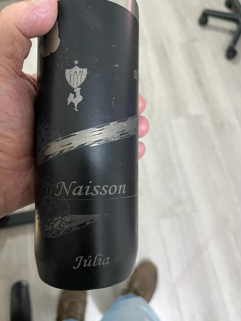

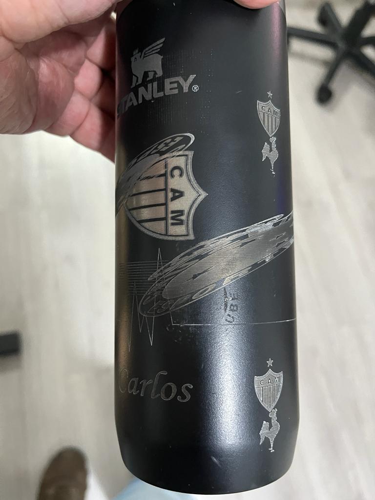

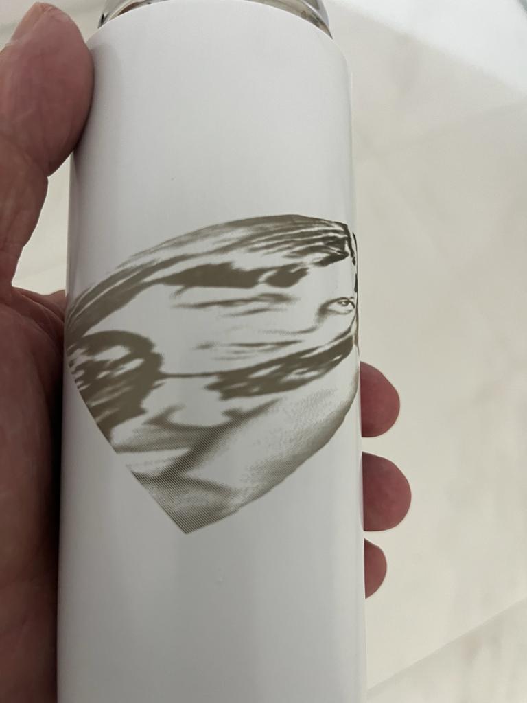

Hello, I’m having problems engraving images. When I configure the laser to make the lines diagonally, the image distorts. If I use vertical or horizontal lines I don’t have this problem. What can it be? images attach.

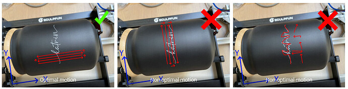

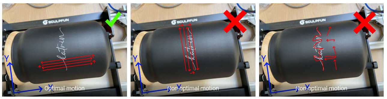

You should never use the laser scanning across the rotating object, always only scan along the object. This will reduce the risk of the object slipping.
Ok, tank you for your help.
