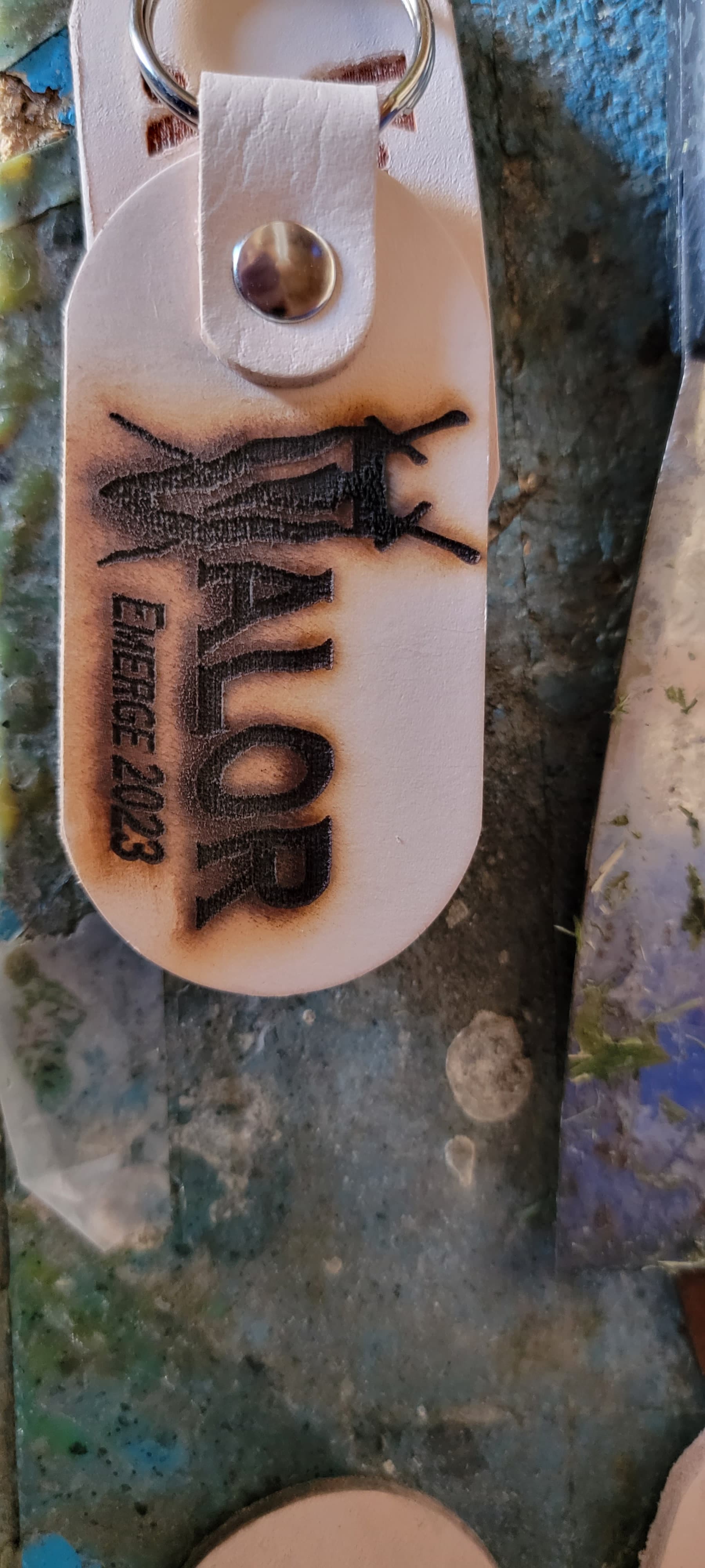

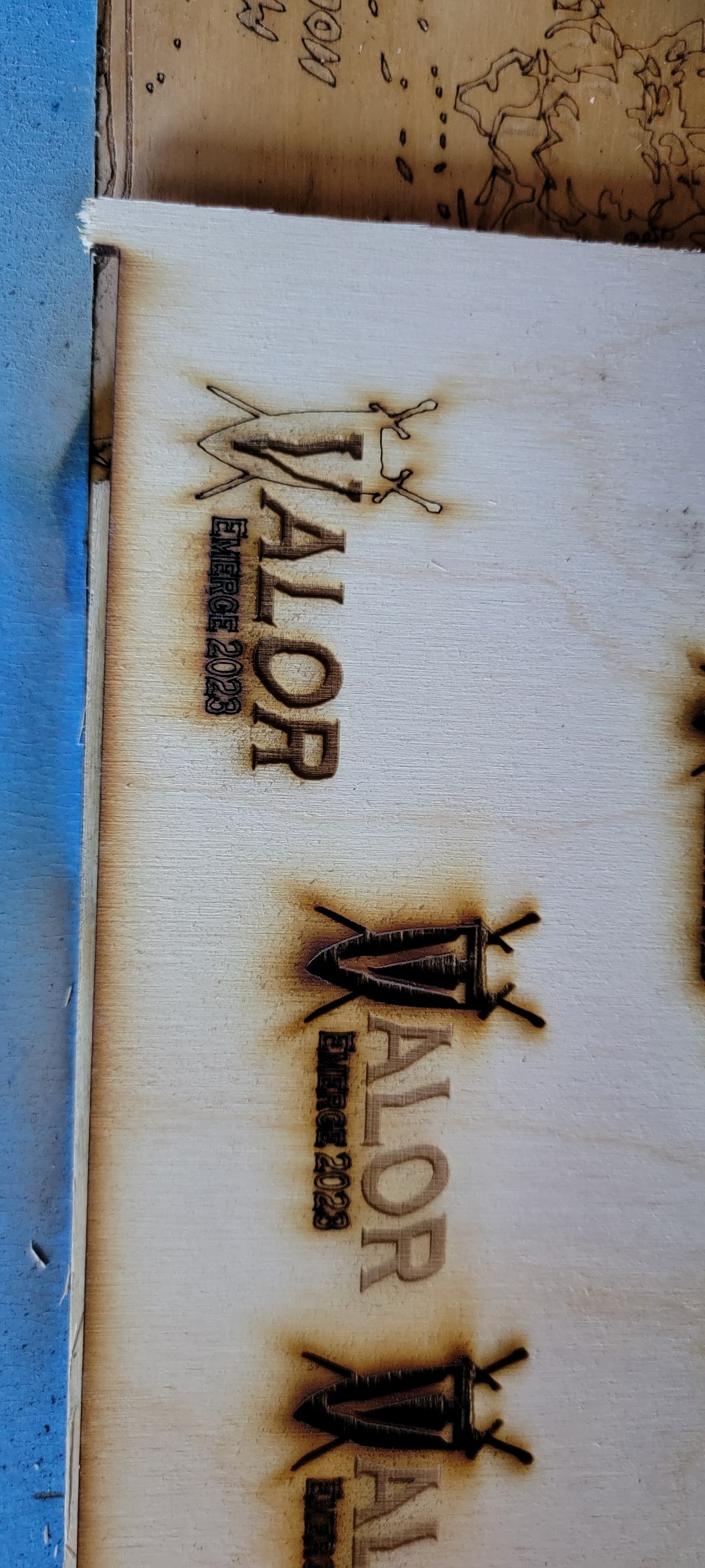

My images are engraving crooked and I don’t know how it became this way. things were perfect the day before but has now somehow changed and incant get a good print. I have sent image to controller and also from the laptop clicking on start. tried slowing down the print and still no good results. What can i do to fix this? I’m using Lightburn on an Omtech 100w.

This could be caused by several things.
Please post a picture of what you’re seeing. It will help immeasurably.

Belts loose? Worn belt pulleys? What speed are you using for that engraving?

With a 100W laser you may be at the lower limit of the tube with engraving attempts.
It doesn’t appear to be losing motion - my first suggestion is cut both speed and power in half and re-test.
