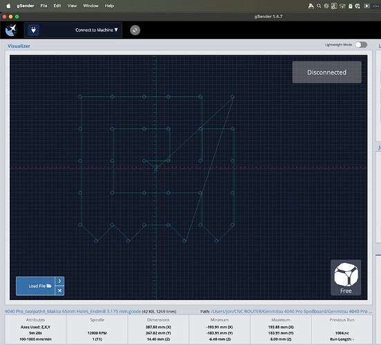

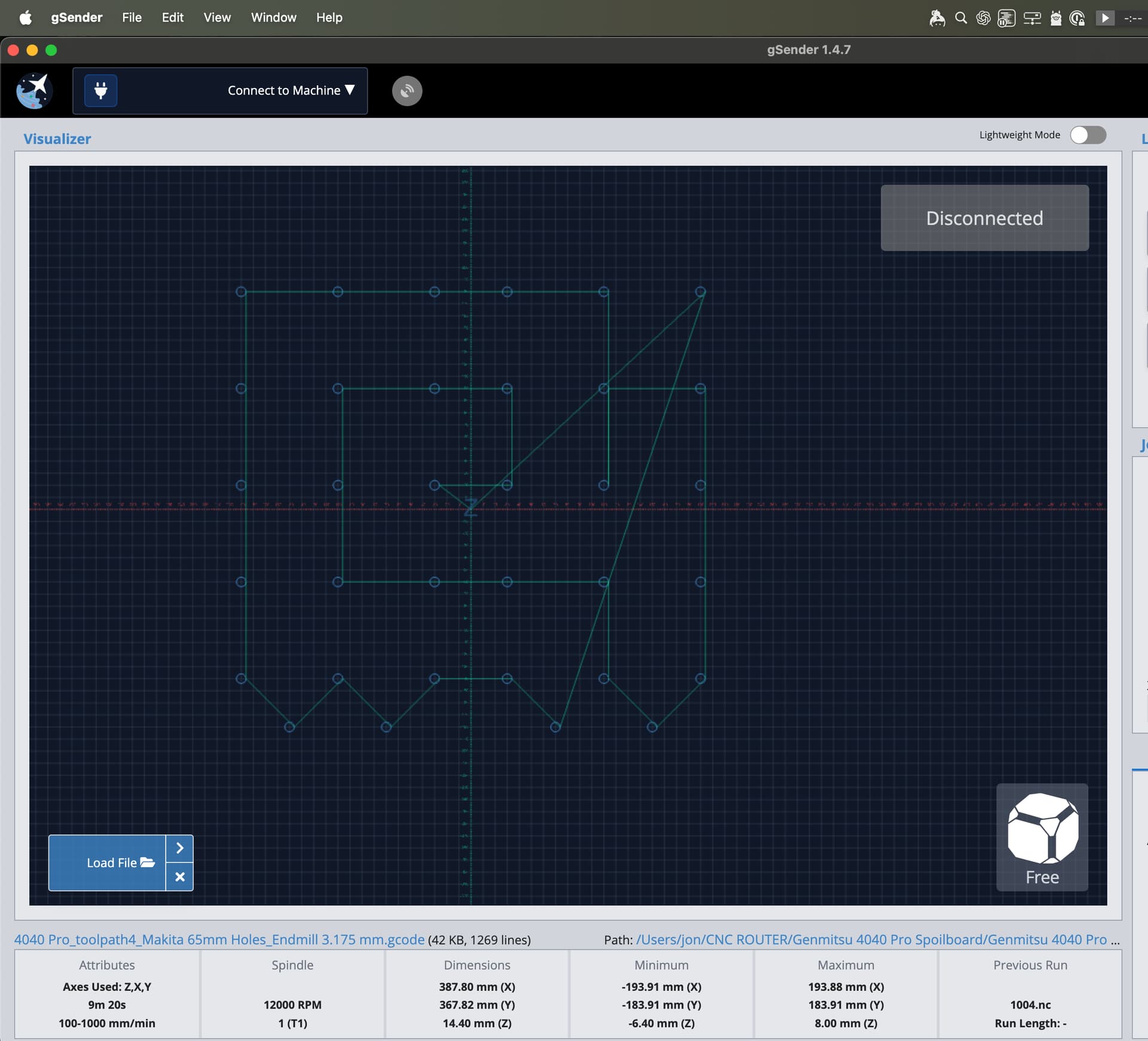

I’m trying to import this gcode (attached - it’s the holes/pockets for my spoilboard) and it silently fails. It works in gSender (screenshot).

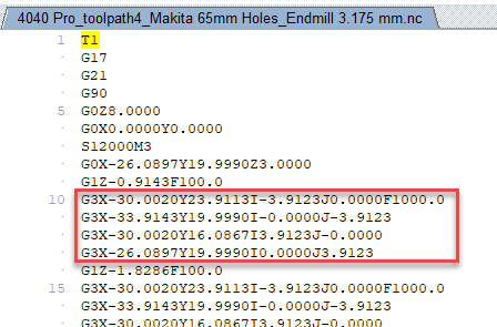

The GCode in your file contains G3 movements with I J arcs that MillMage does not support:
 ![image](https://forum.lightburnsoftware.com/uploads/default/original/3X/9/7/97aa41a912cf6c451c7ddbdab8cc08e34a239e02.png)
Try using this tool to convert each of those arc movements into a series of G1 moves:
> **[Arc Breaker](https://constant-flow.github.io/arc-breaker/)**
Rename the downloaded .cnc file to have a .nc or .gcode or .gc file extension so Millmage will see/import it (remember you can use use drag and drop).

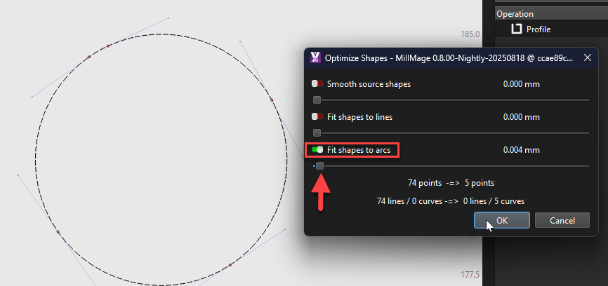

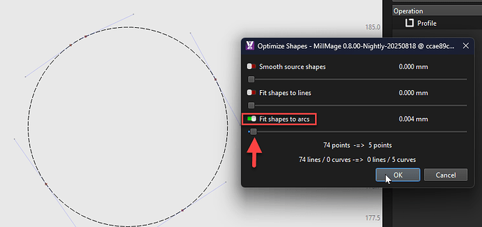

Then, because the circles look like this:
 ![image](https://forum.lightburnsoftware.com/uploads/default/original/3X/1/3/13b68a083a83f7ae784d9871edbb2d07777df32d.png)
Edit\>Optimise Selected Shapes (Fit arcs)
 ![image](https://forum.lightburnsoftware.com/uploads/default/original/3X/1/f/1fc29379fc2ada099eed56a7544dea44accc46d2.png)

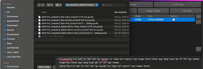

TY for the explanation of the intent from the developer side, however I don’t think that matches the expectation from the user side of things.
The import dialog lists it as a supported format to import, without any indication that it’d work differently than the other supported formats. If there is an “import gcode” function, I expect it to “import gcode” and be able to preview it the same as gcode generated by MM.
If that’s not the case, I think it needs to be communicated inside the app, otherwise you’re going ot have a lot of confused and frustrated users. If it’s just a debug tool for devs, maybe it needs to be hidden from users.
