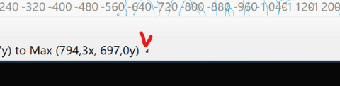

Hello, I need to know how many objects I have in a selection. Usualy yjis information is available in the bottom status (information bar?) bar. Unfortunatly this bar is split in two and the information are only available on the left part, but with the 4 tick boxes and x, y, min and max information there is no available space to see the number of pieces.
So is there a way to manage this bar and select what I want to see?
 ![pieces count](https://forum.lightburnsoftware.com/uploads/default/original/3X/5/a/5abfc402f7d2d11367b89825e5a5338bd31d299a.jpeg)

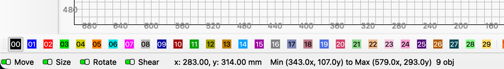

New problem or always like that?
Is your Lightburn Window maximized?

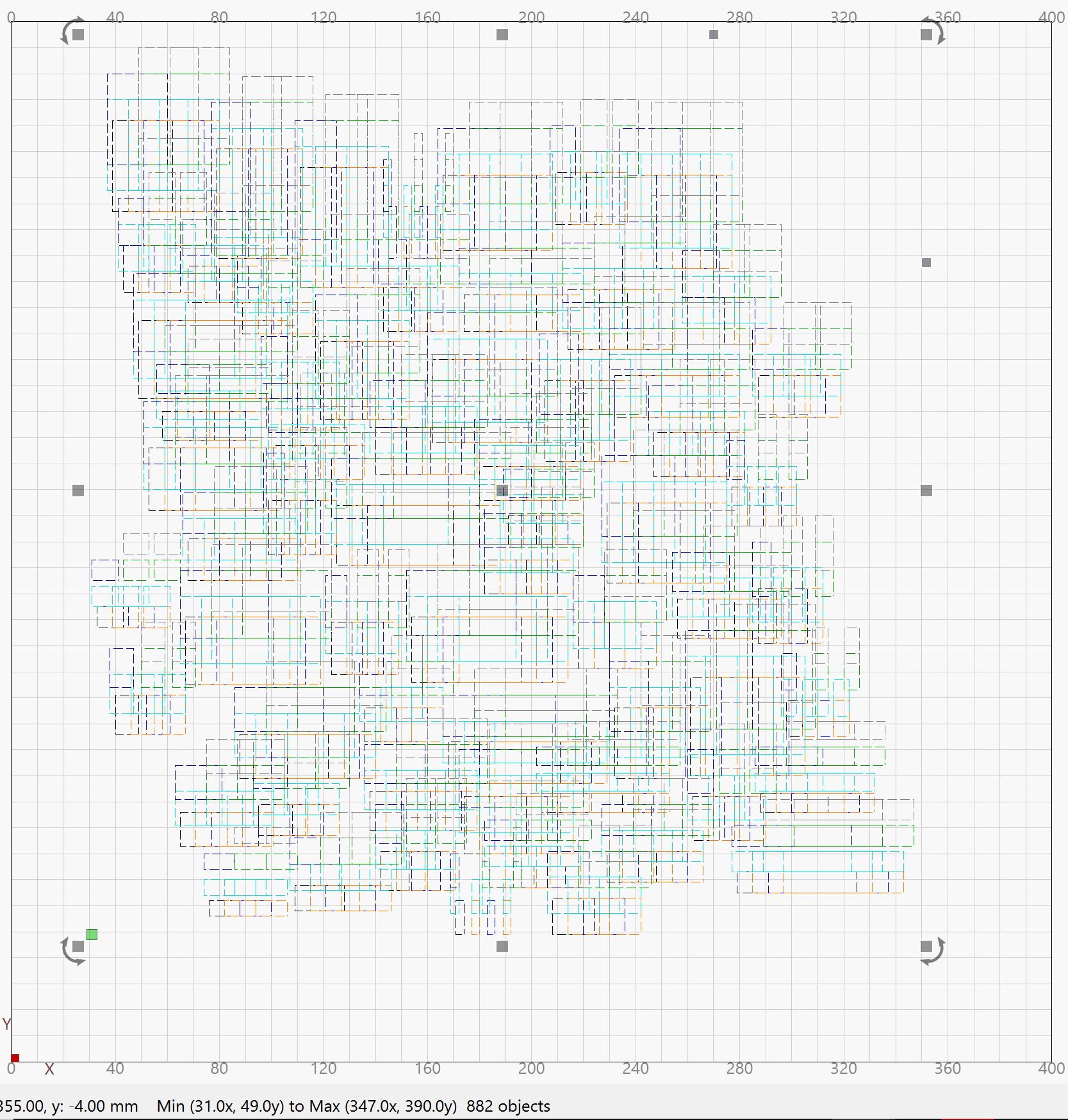

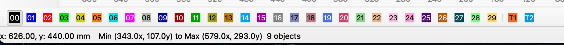

I don’t know of a way to change the available size or hide the transform toggles other than enabling beginner mode. That will hide the toggles, but it also hides a lot of other useful items.
Normal mode

Beginner mode

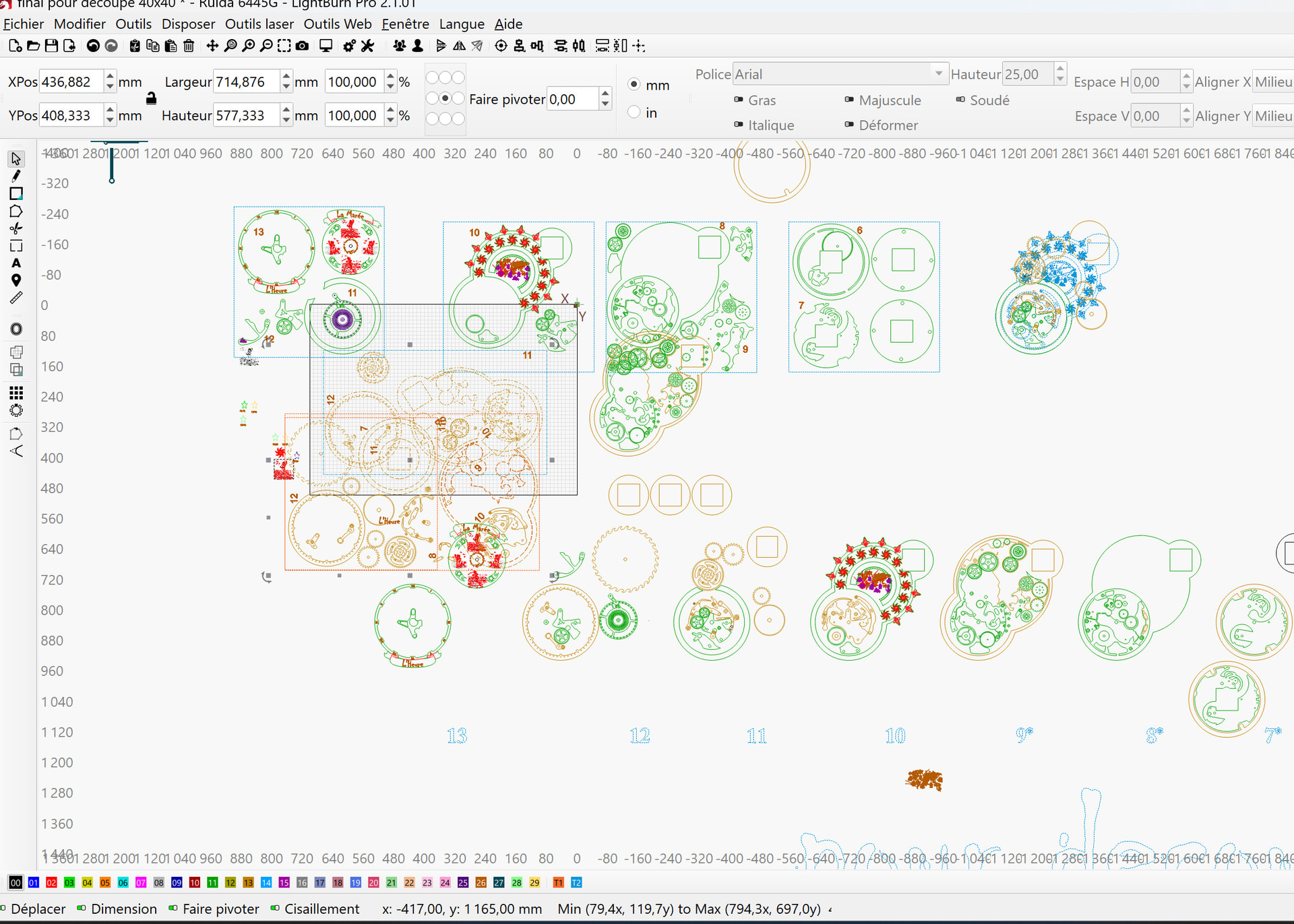

Interesting…
 ![image](https://forum.lightburnsoftware.com/uploads/default/original/3X/4/f/4f38d0ef0baa66deb131141b1d0aab9f96f380aa.png)
I wonder if this is some sort of clipping artifact

> [@Colin](#):
Max character limit cutoff.
