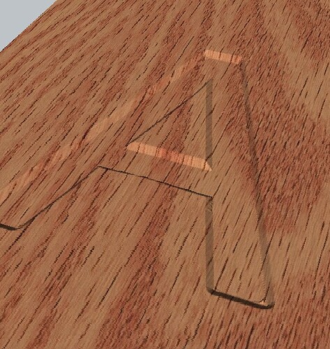

You may be able to work something up with the Fluting Operation. Not V-carve, but you can sharpen the corners with it. I have included a sample file (not my work) so you can see how it is done, and a snapshot of the Preview window.
Quasi V-Carve.mage (24.8 KB)

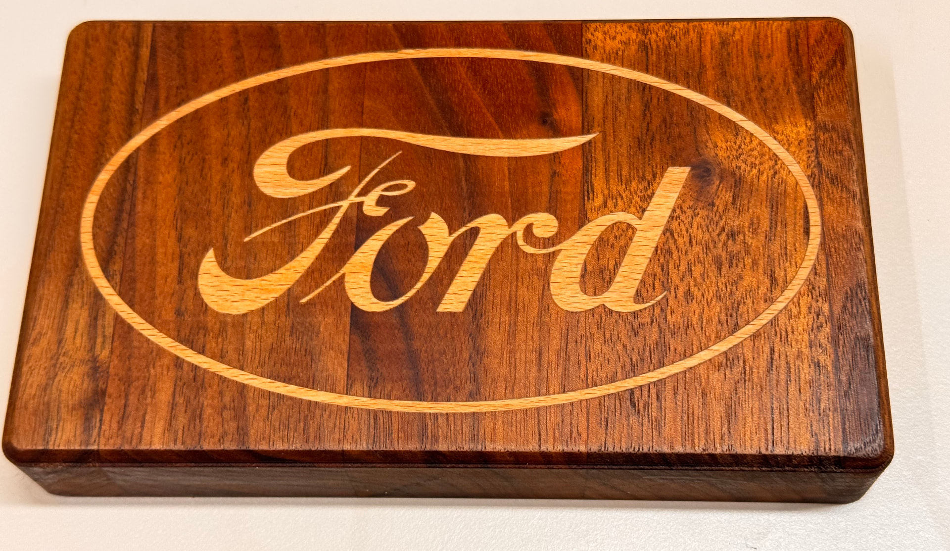

I use F-Engrave for this. It was a bit tricky at first, but it works perfectly. I then stream the generated G-code using UGS. Here’s an example with extreme differences between the thickest and thinnest sections.
Interesting software. I added it to my toolbox.
