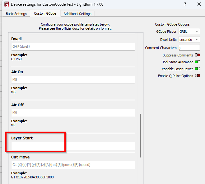

You can also try to add your device as custom gcode device and add manual codes:
I never tested this, so i don’t know if it helps in your case.
