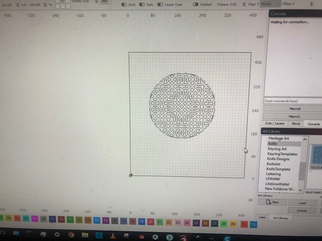

I’m trying to use the weld feature to remove a perimeter from the edges of a keltic pattern. I want to draw a circle of a certain size around a keltic pattern and remove the pattern outside the circle. I’ve tried several techniques and every time it removes the keltic pattern and leaves the circle.
I’m sure the software will do it but I need a procedure on how to make it work.

Select the circle, hold shift and select the project. With both pieces use CTRL+B to open the boolean assistant. Mouse over the selections and click the one that works.
I’m at a loss with Hold Shift and select the project…
I select the circle by clicking on it. Then hold shift
where to I click to select the project?
Is the design a picture or did you trace it? I traced it to make it a vector. Do you want the picture cut out instead?
“the project” means the rest of your pattern. You probably want to group it into one object first.
You can also do the opposite, select your pattern first and the circle second then “Tools>Cut Shapes”. You get two grouped objects—all parts of your pattern that were outside the circle and all parts that were inside. This, however, will not close the cut shapes, whereas Boolean Intersection will.
It is a PNG. I’m working in leather and want the design to fill…
So I need to make a vector to combine them and to a burn with fill?

IMG_1801
Thanks all…
Open the PNG in LB.
Select the PNG in the workspace and trace image.
Delete the image leaving the vector image.
Draw circle the size you want and center it over the vector image.
Select the circle then hold shift and select the vector image.
Press CTRL+B and select the boolean that works for what you want.
Make the layer FILL.
Actually looks like you got it. Didn’t see the image you attached.
@HenryLoenwind I found with Cut Shapes, if the object being cut is set to fill instead of line, when you cut it, it will automatically close the cut areas. You can the switch back to line and Bob’s your uncle. This is near the end of this video.
