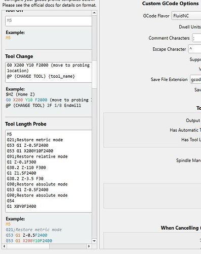

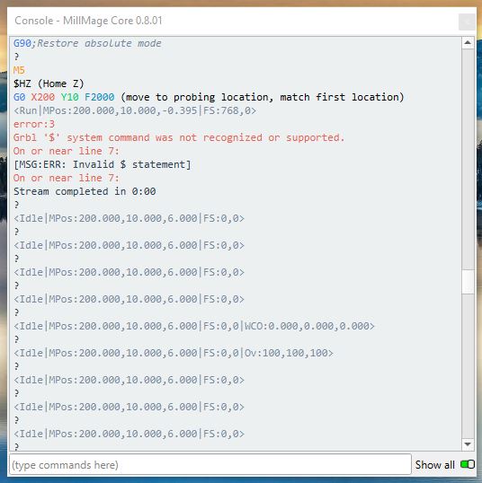

keep getting this invalid message ???
it will home frame do everything except start job

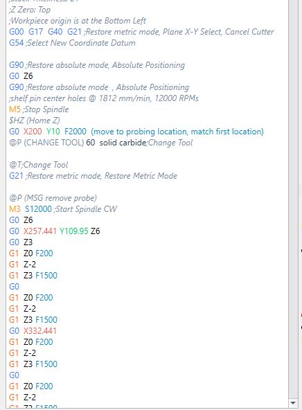

Line 7 is found by skipping over the comment lines.
$HZ is what it seems to be choking on. Can you enter it in the Console window and perform a Home cycle on the Zaxis only?

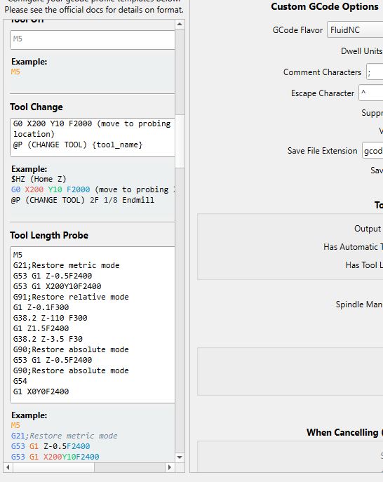

Replace $HZ (Home Z) with just $HZ. FluidNC doesn’t allow comments on lines with $ commands.
