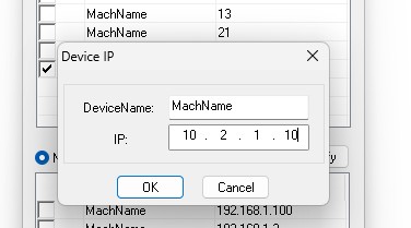

ok, see if you can add an exception in the firewall to allow the program to connect; you may have to change the IP in whichever software you are using to reflect the change
alterntively there is a possibilty that the IP is in use by another machine. try pinging it again with the laser off; if you still get received responses, then change to another one.

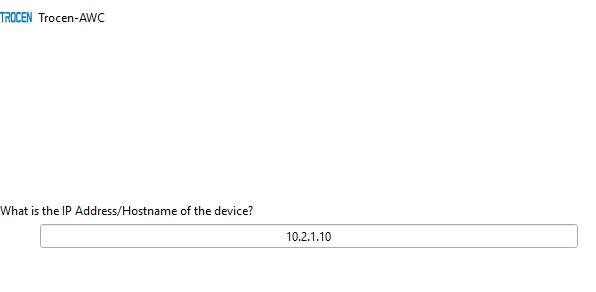

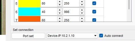

Ok. I found 10.2.1.10 to ping when on and not when off. I changed the settings in the programs to that IP and still no connection SOOOO I am going to assume at this point its a firewall thing?
Sounds like it; If you can temporarily disable it to check, it will confirm. Not a good idea in general to keep it disabled, adding an exception is the correct approach.

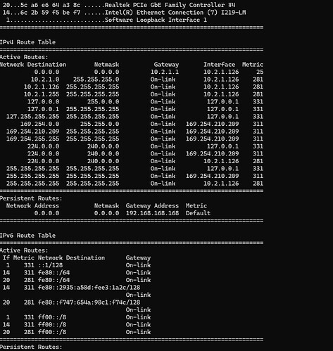

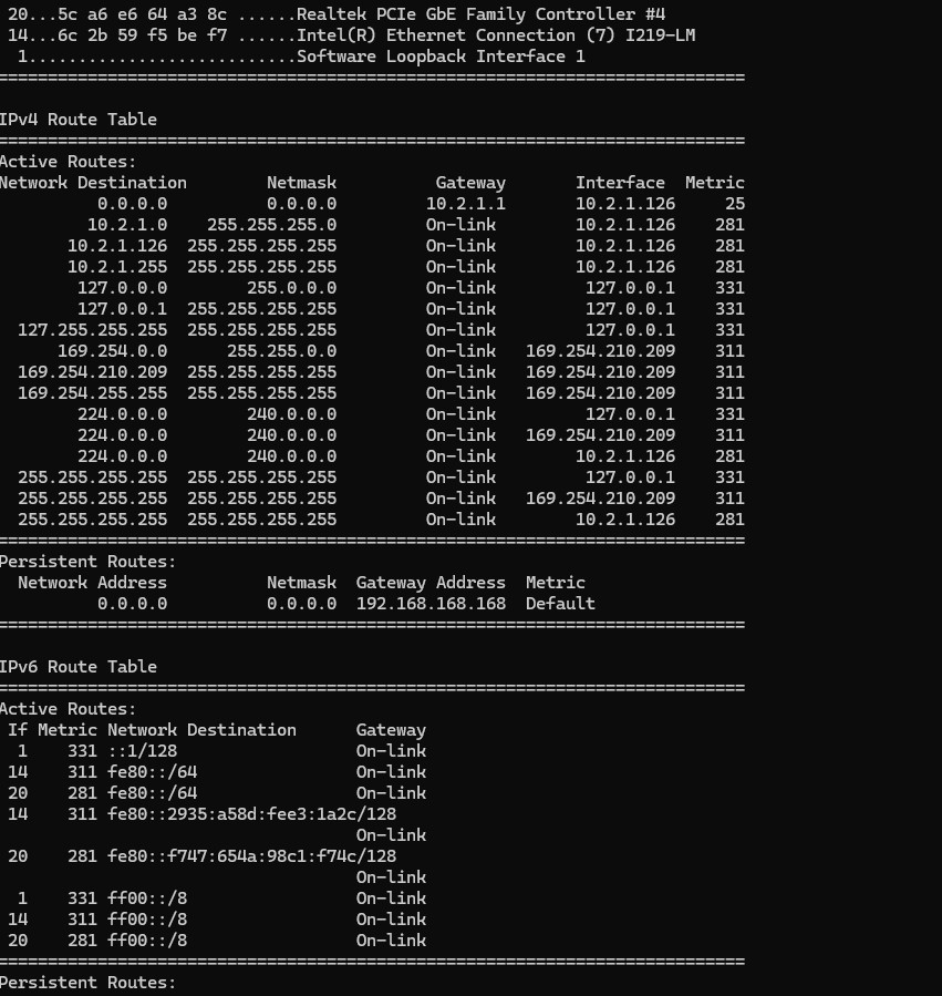

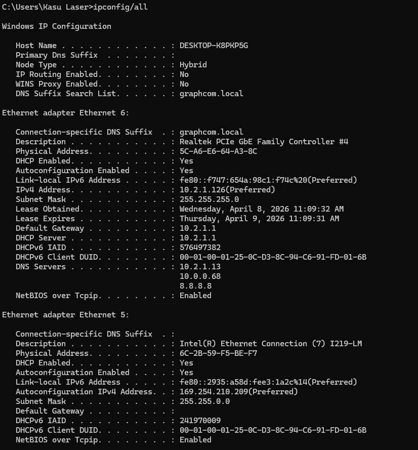

Can you post the output of “ipconfig /all” and “route print”?
After this point I’d fire up wireshark and see what’s going on, but there may be something that sticks out with the other command’s outputs before resorting to that.
sure!
All looks sensible; can’t really go much further without deeper network details; there is a possibility that there’s something blocking it at the router level, although generally traffic is untouched on same subnet stuff; I think the best bet now is wait for IT to return!
