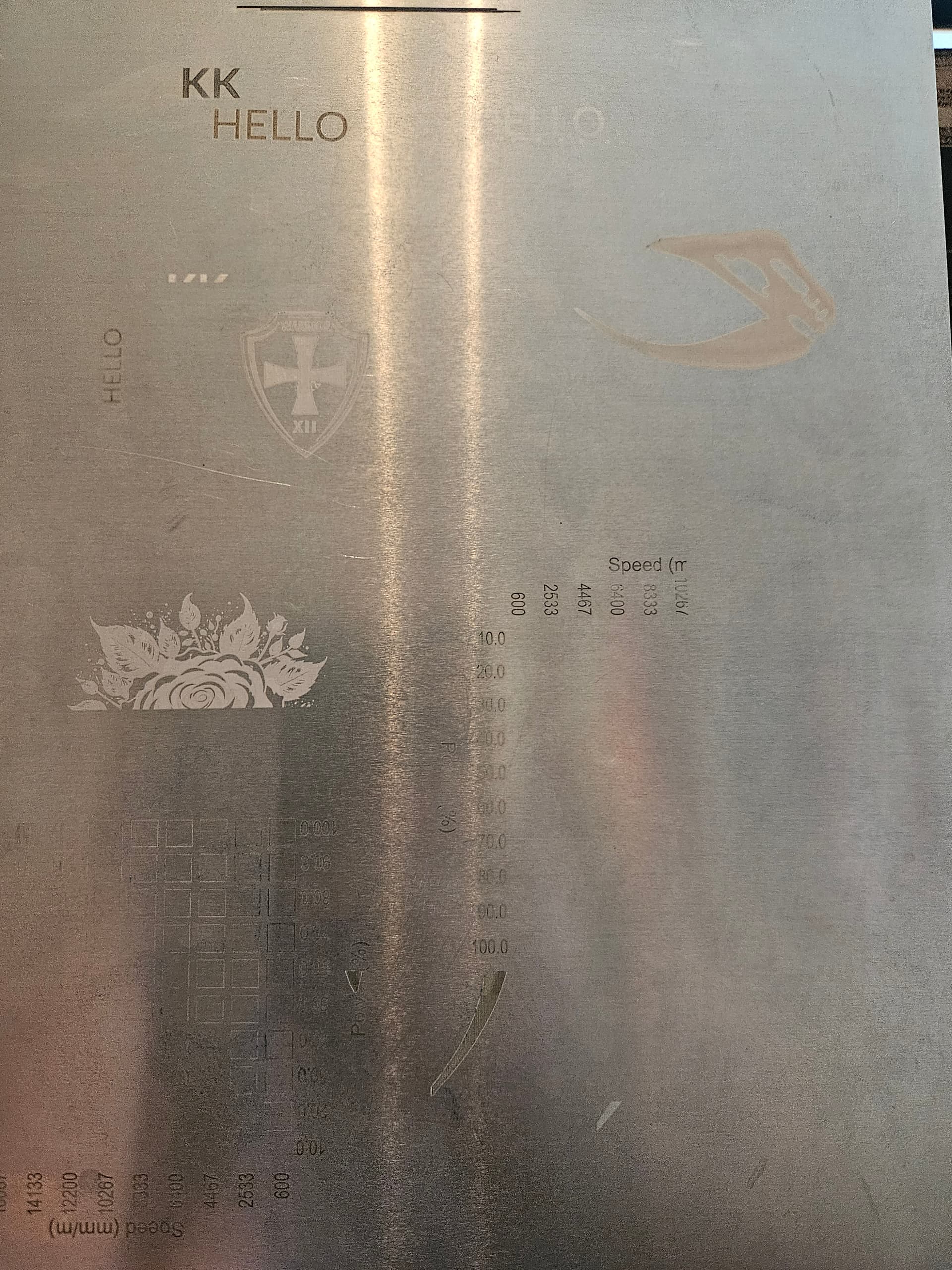

So just got the I.R module for mt xtool. Was doing a test run on some of metal that was sent for practice. And it was only engraving in white. Is there a setting on xtool. Creative space or in light burn.some of the video’s I’ve seen it there results etched in black.any help would be greatly appreciated

I used the aluminum that came with the kit,so guess i just need to back off on the power and speed.

right now i’m using the xtool creative space program, i’ve slowed the speed and power down and same issue. So still need to adjust something some where just not sure what

Just this sample sheet of aluminum. I did do some more research, and one video suggested that the focusing arm for the 1064nm i.r laser isn’t true. That you need to be 20mm from the surface you’re engraving
Did a test run on my wrench and it came out black. So I’m guessing aluminum is going to turn out white and other metal’s black. This is all still a learning curve for me

That was the case on mine, purchased ~14 months ago, some recent ones have been reported to be correct.
If You have focused Yours with the arm, it’s most likely close enough.
Because if it isn’t, the xTool IR head with its 2W optical power won’t make a scratch on aluminium oxide layer.
Or pretty much anything else either.
Even 0.1mm off will unfortunately make a world of difference.
It’s always best to do a ramp test rather than rely on focusing arms or fixed figures.
There’s a lot of variables in the manufacturing process, so there’s bound to be differences between modules.
With such a low power, we’re pretty much only manipulating the oxide layer forming on top of the metal, so the oxide layer determines the colour when marking on bare metal.
So in the case of the ratchet spanner it’s most likely chromium You’re marking.
Or nickel under the protective chrome layer.
