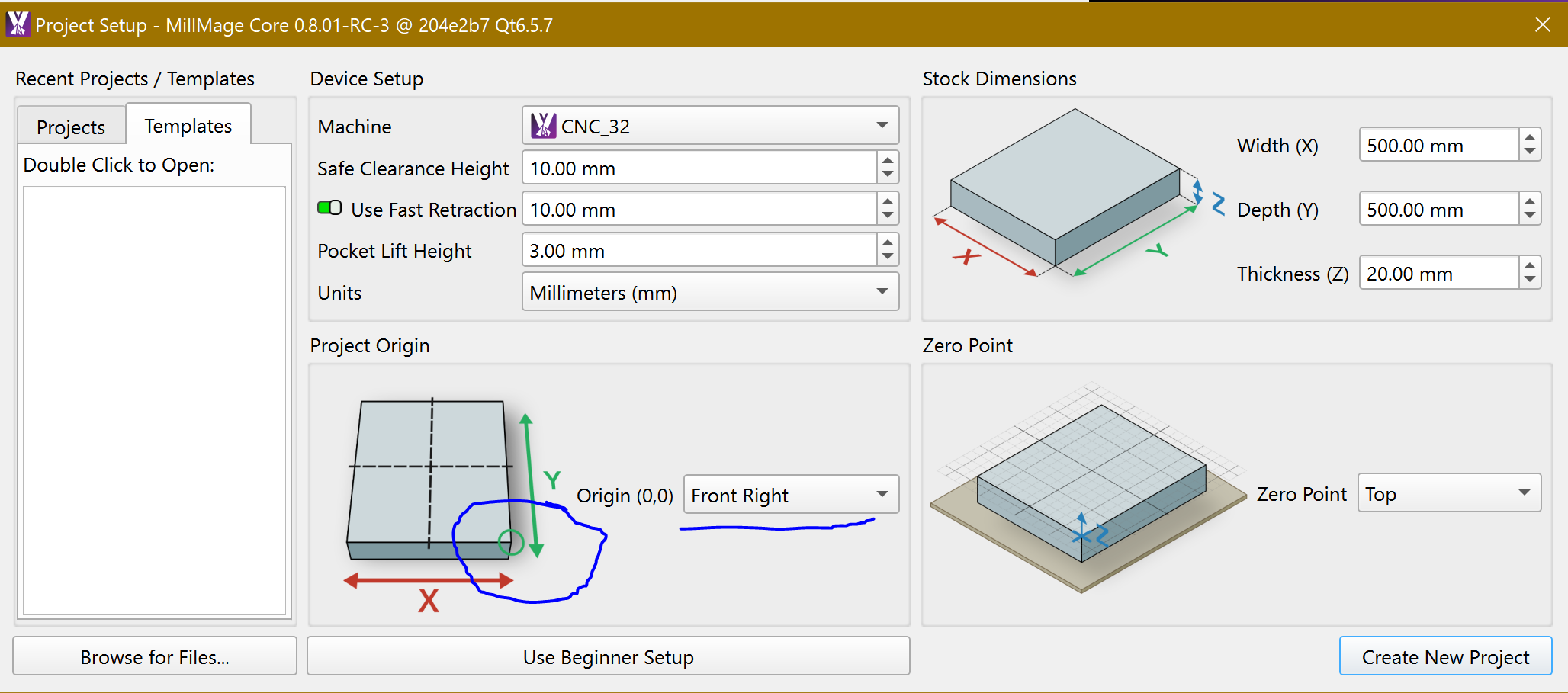

Try Editing your project and set Origin at Front Right:
I’ve done that but the X axis still moves to the left. Caused a pretty good crash.

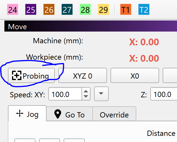

MillMage will execute the probing routine and set the workpiece origin.
The probe sets the program Origin. Can you do a Set Origin in that desired corner and get your program to run?

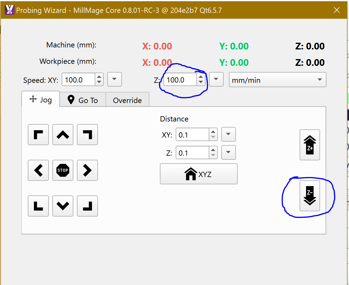

If you Jog to the Front-Right corner in the Probing wizard window?

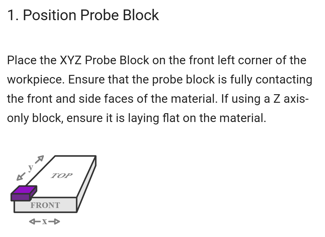

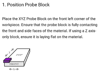

It seems that`s only the Front-Left per the Docs:
