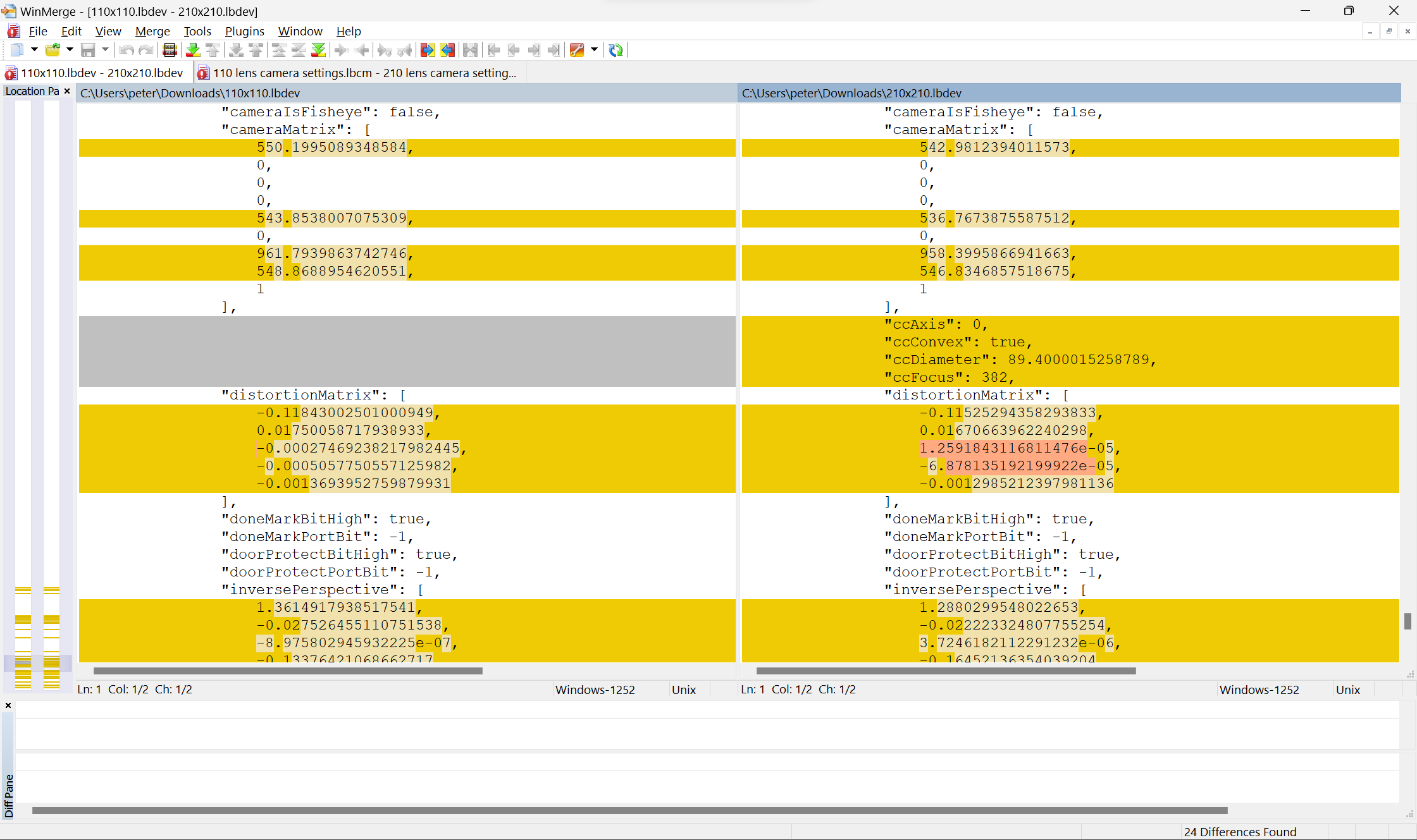

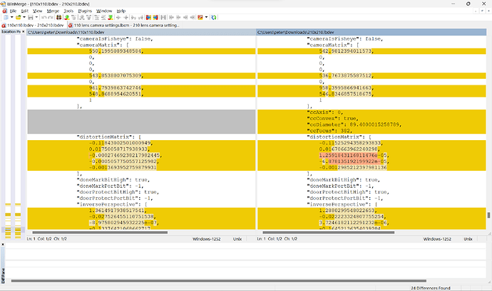

Can you export .lbdev files for 2 lenses and upload here? I’d like to compare them. I’m almost certain that they each should have a camera configuration section but perhaps there’s something else preventing it from working that way.
110x110.lbdev (38.1 KB)
210x210.lbdev (38.3 KB)

I can confirm at least that each device profile does contain unique camera correction data.
I can also see that the saved camera settings for each .lbcm file are also different.

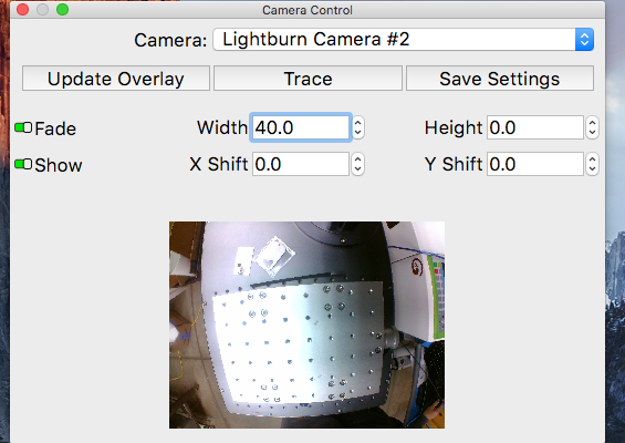

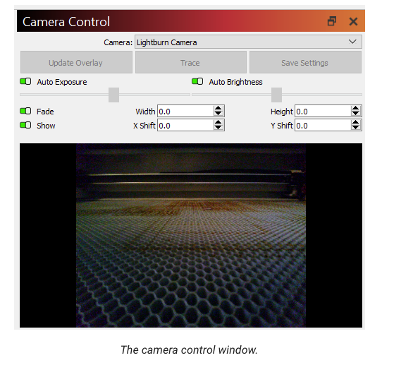

I have found the load and save function by click click the mouse . now my question is why my camera control window doe not have all of the adjustments listed in the Lightburn Doc.
Both of my camera were purchased through Lightburn
Screen Shot 2024-03-11 at 6.40.31 AM
Those controls are only available when using “Custom Capture System” which is only available on Windows.
