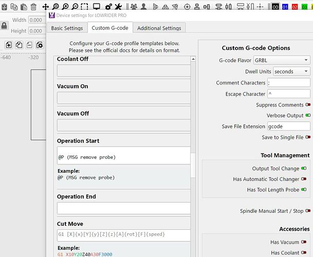

hopefully on right track with what ur asking , @P is MM M00 ,M01 dont recall that on the list there is a list in docs of usable codes, dont ask me which section i cant remember
this is where i installed a pause for tool change
now my machine pauses after its tool probe , which gives me time to add dust shoe etc , re clearing chips i just hit pause button in job control tab mid job, only down side is Z stays where you pause it you cant lift it up, , you could try adding codes to the user start and end script boxes

Oh man, that would be helpful. where do i find the stuff about @P? any actual code documentation would be great. i can’t find it in the documentation.
It has to be added in the Custom GCode section.
It is a MillMage directive. Search the Forum for more info.
