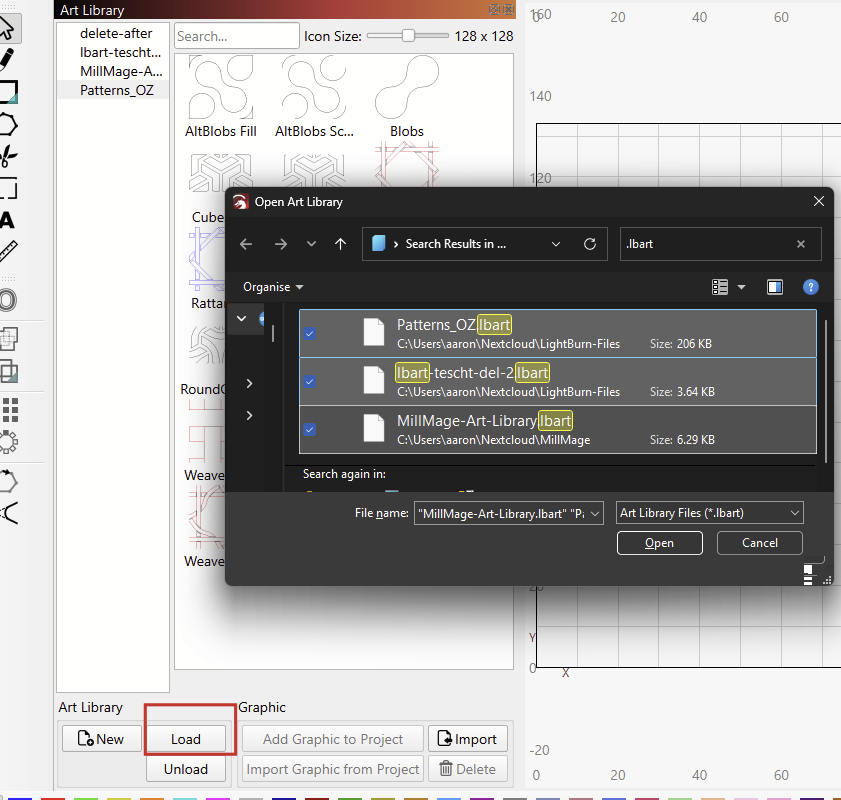

I’m slowly building my LB art library. I like to create my own graphics, but I’ve been downloading some. The first thing I noticed though when I began downloading libraries was that in order to view the files I had to go through the multi-step process of loading the library in LB (Open > LB; click > Material Library; Load > Said library; click > file name). So I got to wondering if there was an independent file viewer for ‘lbart’ files. But I couldn’t find one.
Is there one?? If not, I think it would be very useful. Doesn’t have to be fancy, just to be able to get a quick view of the files content to see if the contents is worth loading into LightBurn.

As Mike pointed out, there’s no Art Library viewer. We store the data in the .lbart file in binary format to make it much faster.
You can however “Load” multiple art libraries all at once if you select them all in this window:

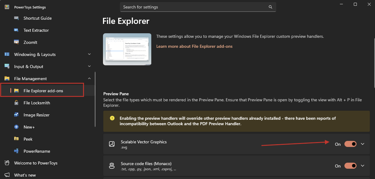

Oh, and: If you start building your own Art Libraries, you might have noticed that by default, Windows Explorer does not show thumbnails for SVGs.
Power Toys brings you this feature
You can then change the View in Explorer to “Large Icons” and drag the designs you like to into the Art Library in LightBurn.

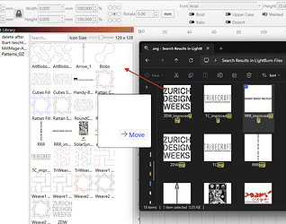

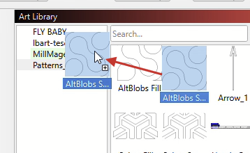

BTW: You can drag individual designs between Art Libraries. Holding Shift moves them instead of copying. Handy when you just want to cherry-pick a few items.

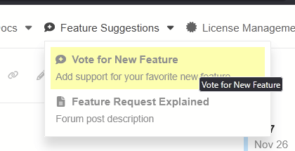

Feel free to create a public one on our Fider page. We use Fider to decide which features are important for us to develop next.
