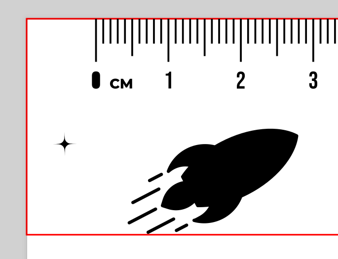

Hello, I actually use Lightburn for design works even while my machine does not support it. I just design in Lightburn and then export to svg.
There’s a known “bug” in Lightroom when exporting SVGs.
“LightBurn exports all the shapes as independent, instead of merging them into a single filled path“ as stated in this comment by Oz.
So designs that looks like this in Lightburn:

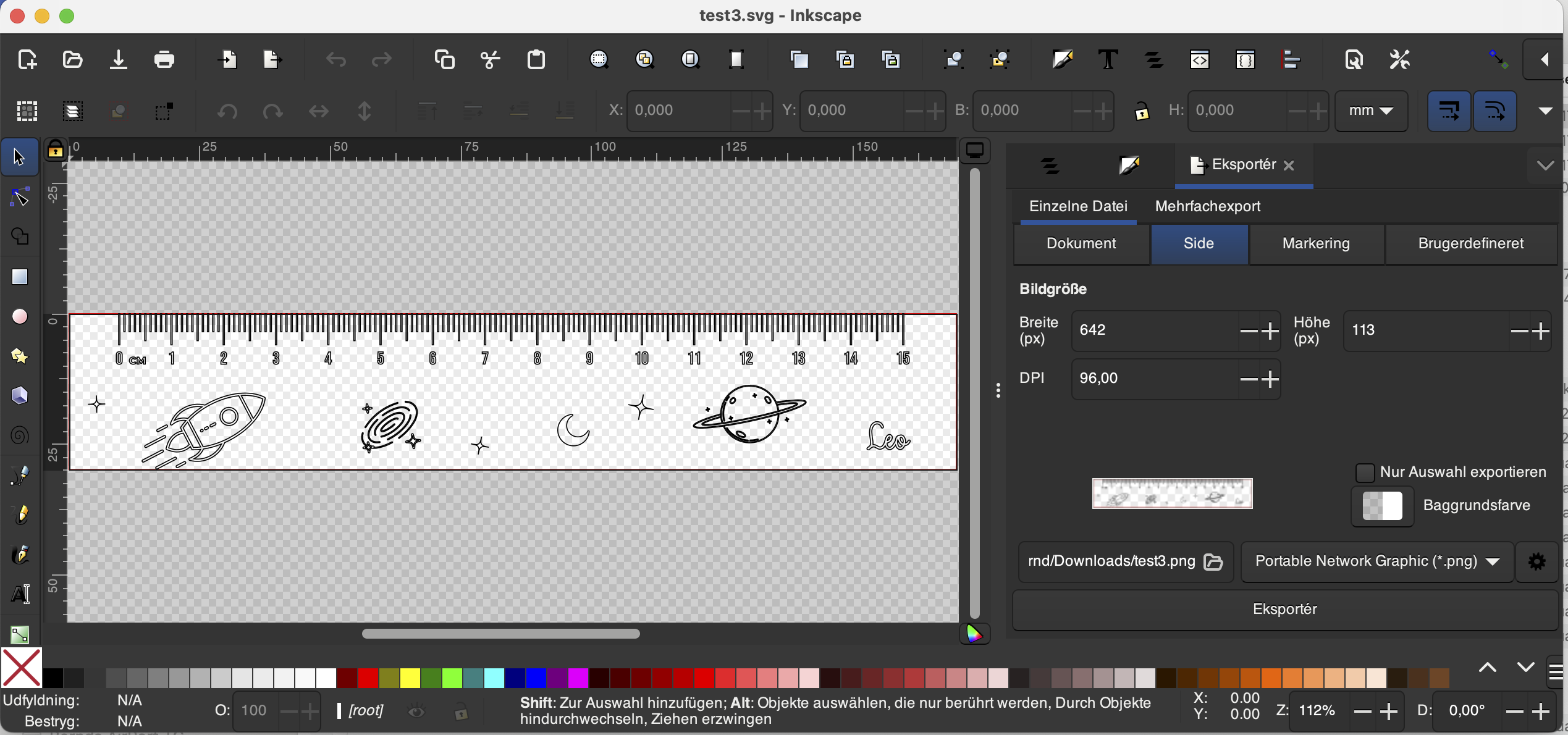

Sometimes look like this in any other software, even Inkscape:
What I usually do is to open the .svg on Inkscape, select same fill colour and “exclude”. The problem is that for bigger/complex desings Inkscape just stop responding even with a powerful computer because there are thousand of shapes to calculate.
I’m currently on lightburn 1.5.06 and I’d like to know if this got fixed in latest version. If so, I would totally buy it again.
Can someone can confirm it exports to .svg as intended using this file?
