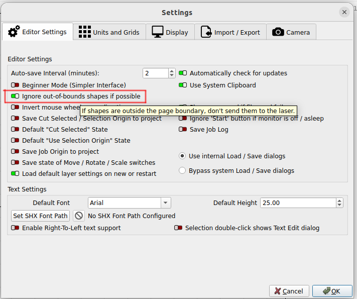

Lightburn agrees. Overscan, where the laser has to stop and reverse, can be out of bounds due to inertia if your Yaxis burn command is to the edge of your workspace. If you are willing to bang the module into the frame, turn off all limits. Of course you will then get positioning errors.
Have you tried toggling this option in the settings?
You can believe the software, which means something likely isn’t setup properly. Not sure what that is or how exactly you’re doing your process.
