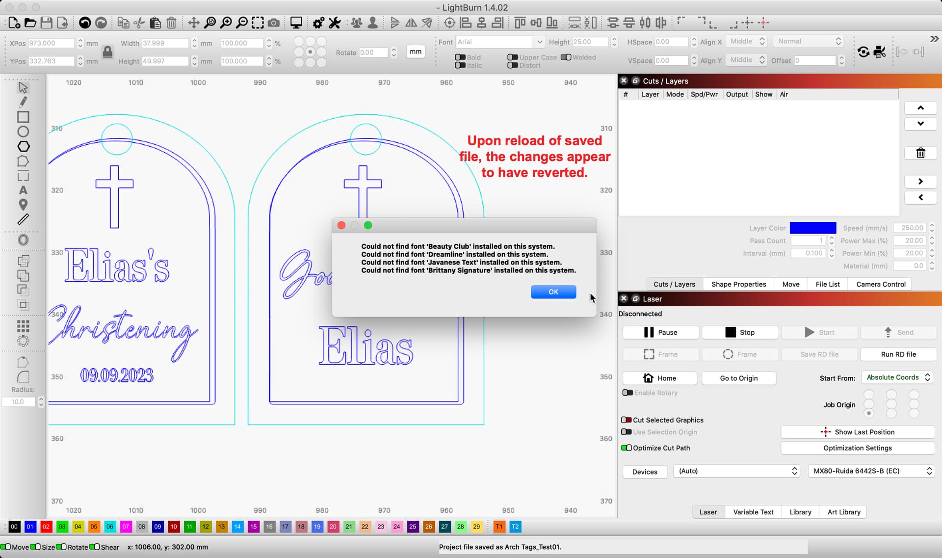

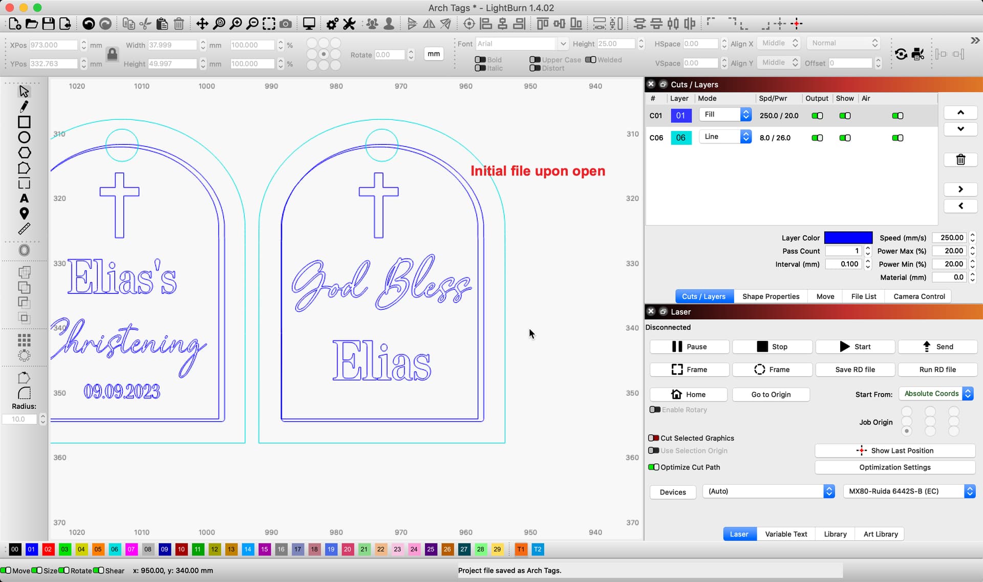

Issue with borders slightly moving after it has been saved and I reopen the file
Having an issue with the latest release Lightburn.
When I save the file everything is aligned to how I want it but when I open the file again it slightly shifts the border each time.
Screenshot 2023-09-14 211444

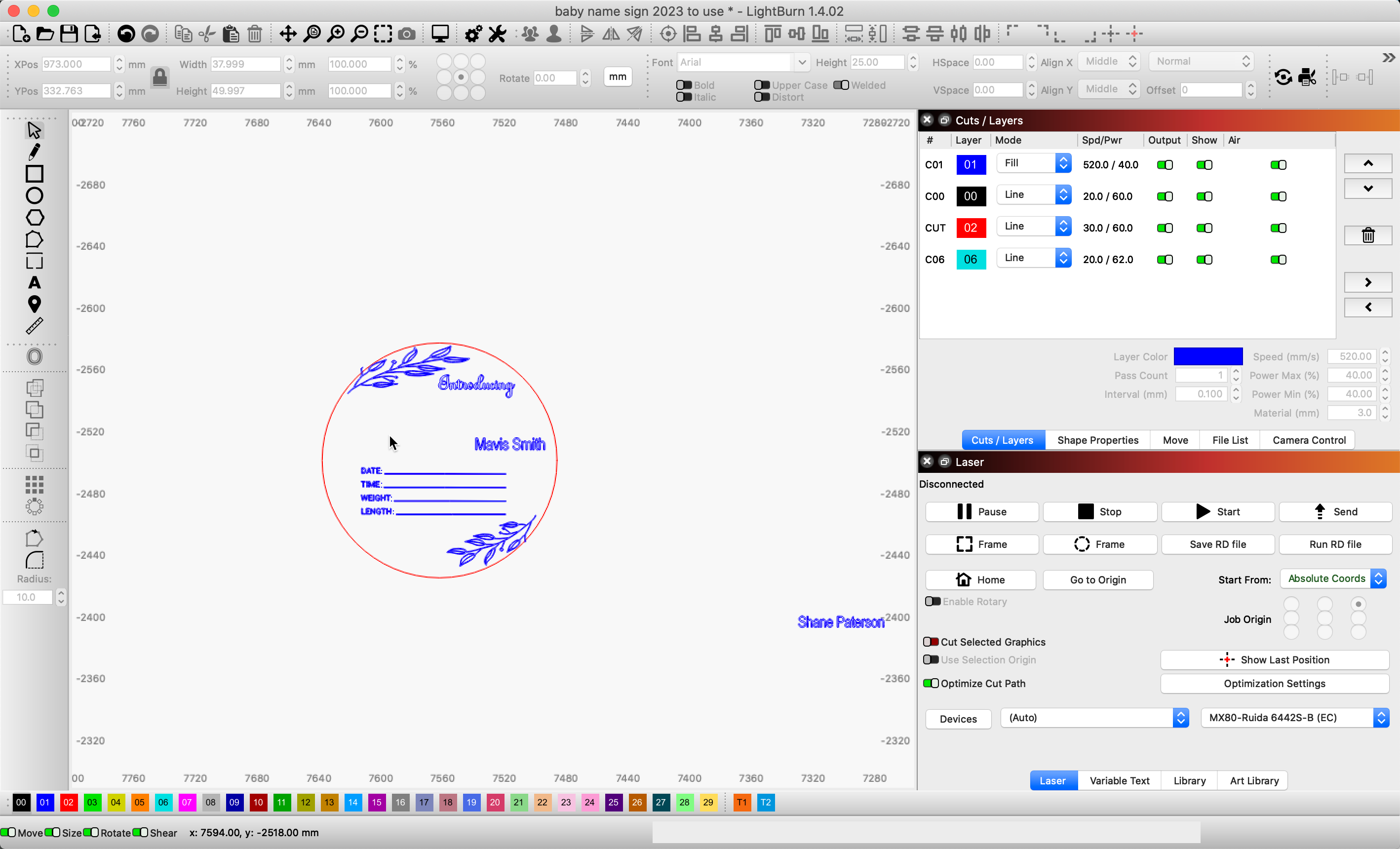

Only issue is that this image is easy to align but I have another file which I will upload later that is a vine leaves wreath. The border shifts in some areas only and I have to readjust it each time after I reopen the file.
Didn’t use to do that with the older version of lightburn
We can review, so yes, please post when you can.
Sometimes only part of the leaves from the border moves even after I group them together. Then I have to go through and adjust parts of the inside of the leaves when I reopen the file after it has been saved.

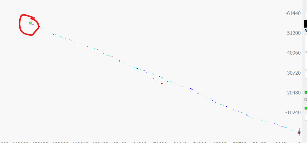

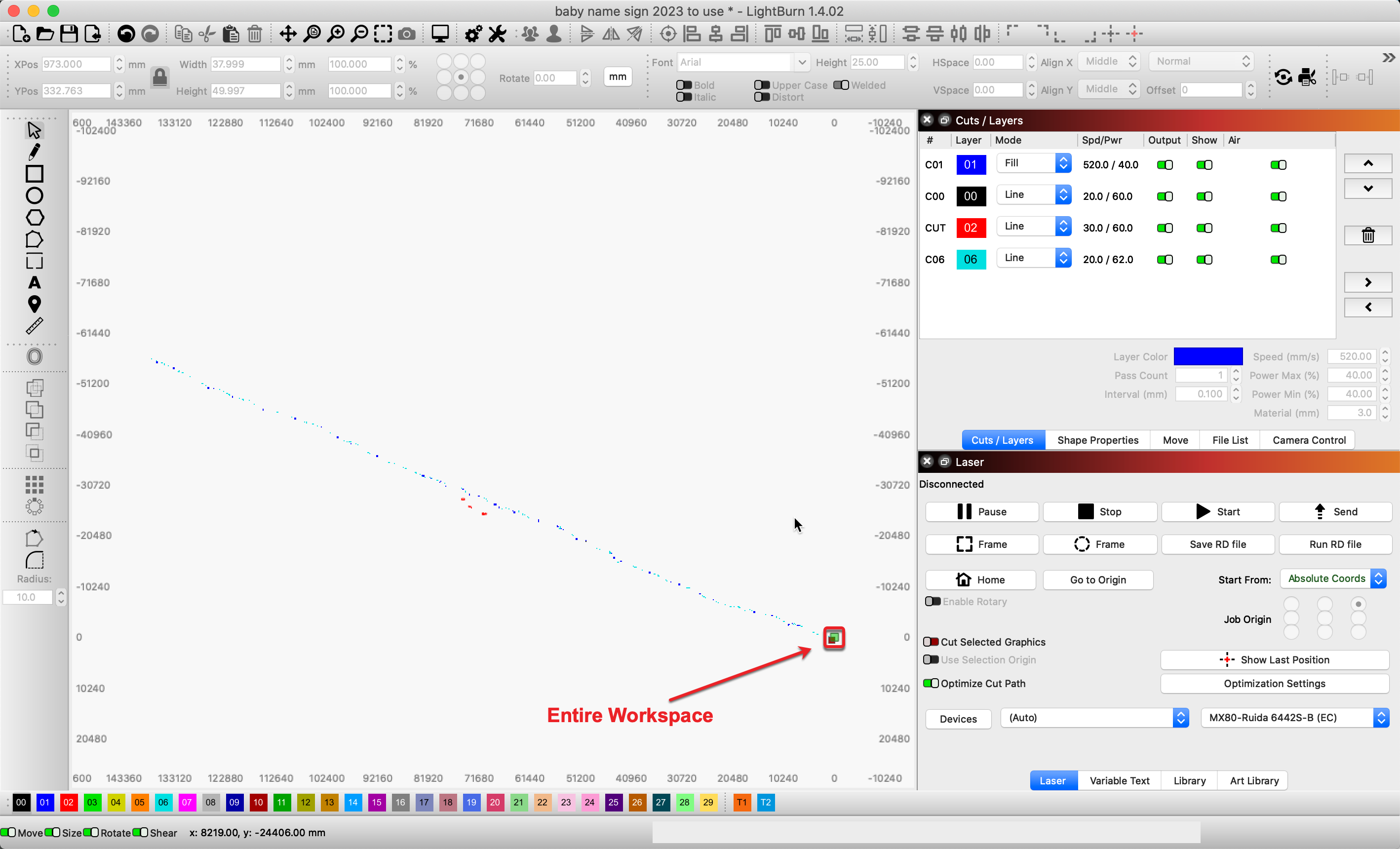

Is this what you see when opening this file? :man_shrugging: I am seeing artwork nearly 150 meters ‘off-grid’. Is this intended?
I had to zoom out a lot to find any content. What do you have set as your device profile? What are the Units set for use?
When I zoom in and pan, I find things (examples), but not sure what part is causing issues. Please direct further.
Not understanding @Jane_nguyen31, what are you showing us? :slight_smile:
I do note the difference in ‘Origin’ in your image from mine, but not following. Please explain.
