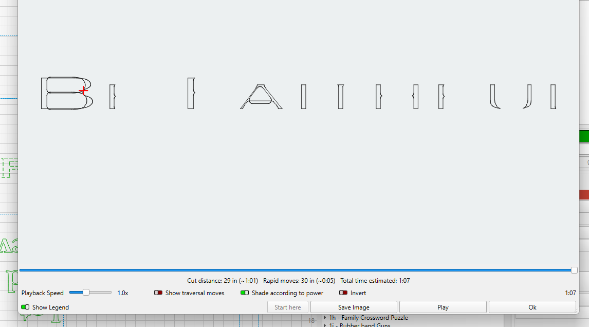

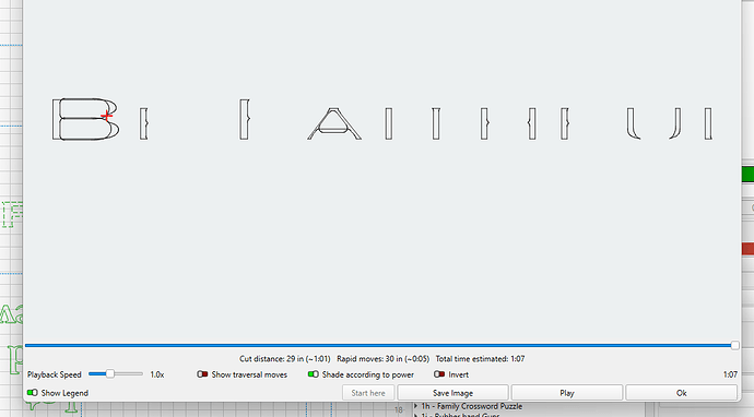

I’m having issues between what is shown on the Machine Workspace and what Print Preview and what is sent to the laser. I’ve included screen shots and file. I’m not sure what I’ve done to make this change and I’m doing some research on my own but I thought I’d ask my favorite forum for answers. I have checked other files and they don’t appear with these issues. So I’m thinking it’s the file somehow.
Text Issue - sending to printer.lbrn2 (30.4 KB)
You have a kerf offset enabled. Remove it and your problem will go away.

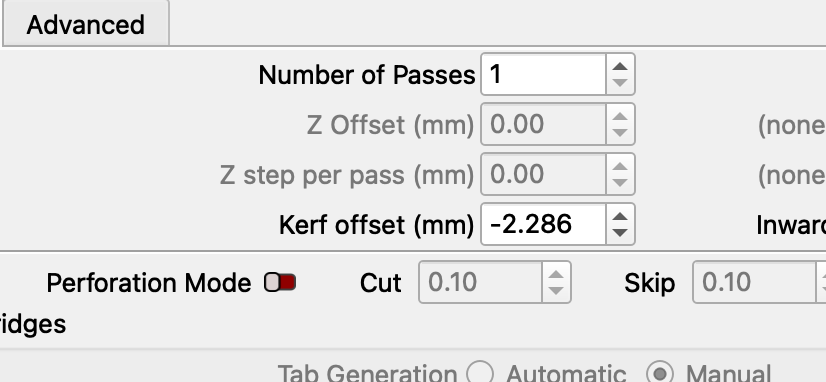

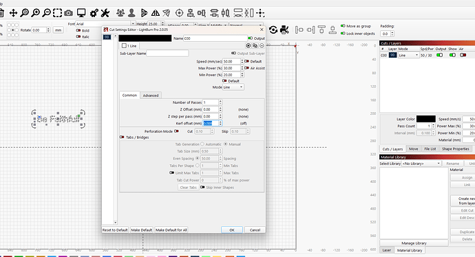

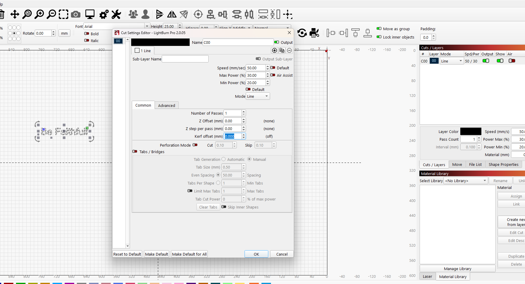

Just to add to @thelmuth diagnosis, in case you were wondering where to find this setting.
The Kerf Offset is managed on your Cuts/Layers window, click the layer you have set, which is presumably in Line mode.
and check for the Kerf Offset.
