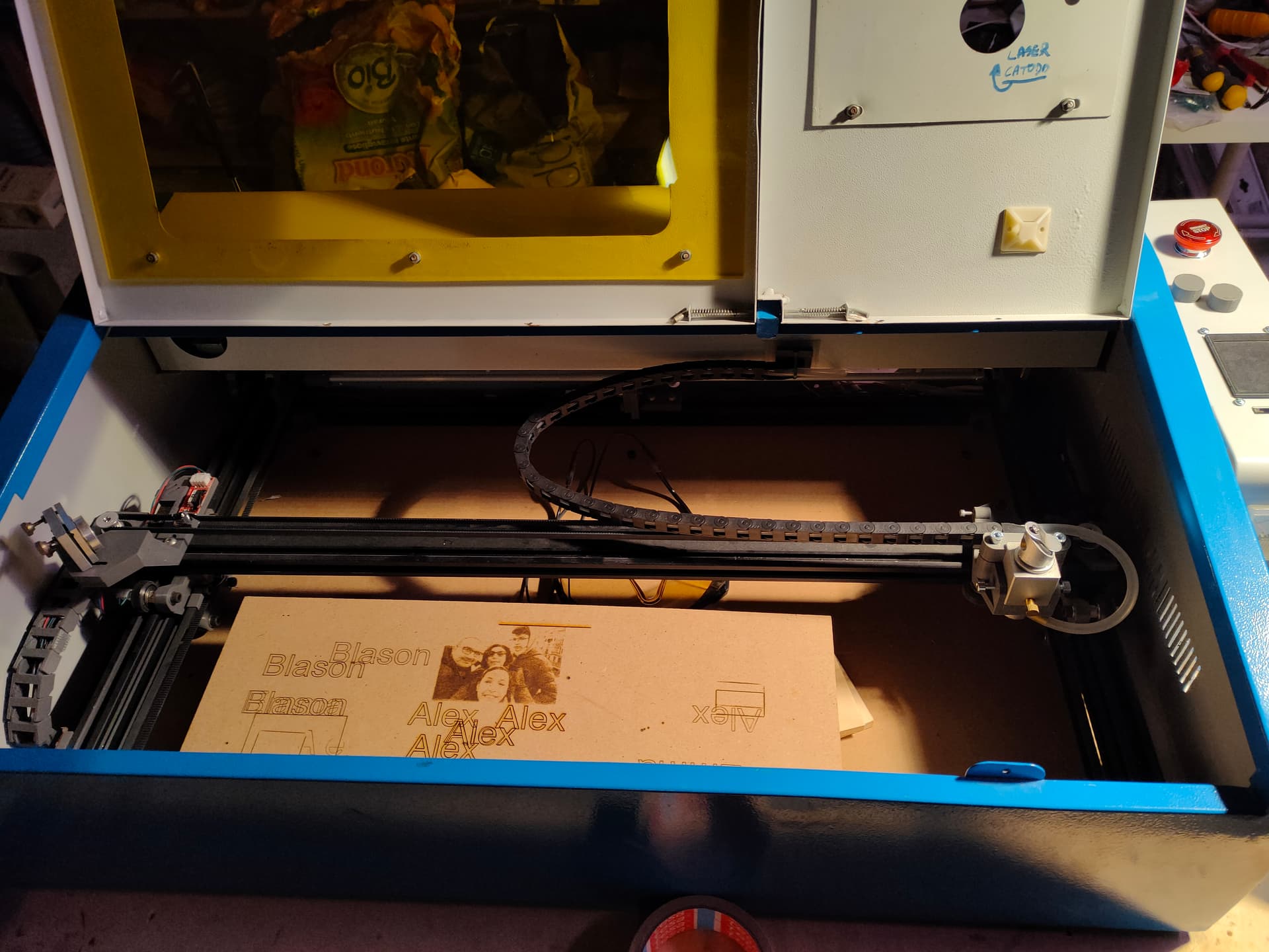

I went crazy about this thing because I am inclined to think that M4 mode is essential for a lot of machining and therefore I need it to work reasonably well
Yes, most likely it all started from here
I am fairly confident that once you have your maximum speed calculated from your processor speed and microstepper controllers (a stopwatch may also inform this) that your engrave speeds will produce the correct behaviour when they are equal to and below the maximum allowable speed.
Angled line segments can cause a speed that can exceed the maximum X and maximum Y speeds and i believe it can call for a reduced power output under that condition as well.
