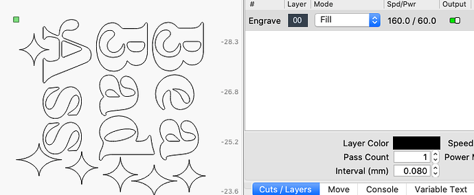

Items that set to fill only shows as fill in preview in workspace shows as a line
Not sure if it’s compatibility issues or settings. I didn’t have this issue until my laptop died and I started using my son’s MacBook Pro (maybe it’s too old). When I work on the item I only can see how engaged (fill) items look in preview it doesn’t as suck in work area, I only see it as it set to score (line). Can it be some settings I need to change or it’s a laptop/light burn compatibility issue?
Check if this option is selected.
By default, LightBurn works in wire frame mode in the design window. Filled renderings in the design window can make things like Node Edit difficult, as well as hiding objects under fills that you can’t see. You can toggle Filled Renderings with the Alt+Shift+W keyboard command.
