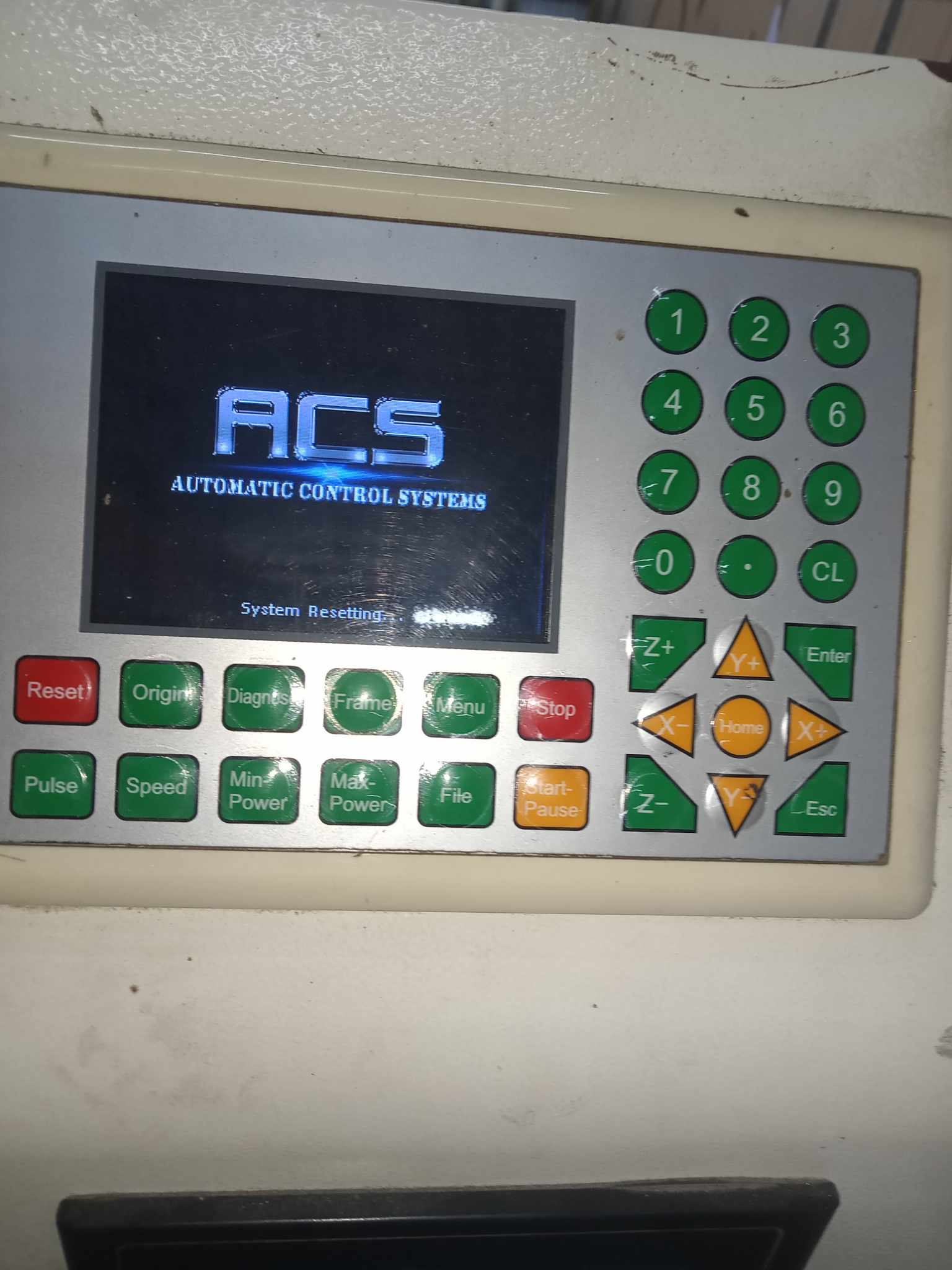

its all about my control panel , when i startup the machine it all shows that there is system resetting , but now it just stuck at the ACS nor the manufacturer logo, and i cannot even click any of the button, its not working when its stuck, i did plug and unplugged the wirings in it already , but still its always happening , whats really matter on this? can somebody help please
i will send a video or a clip later . for the stuck up startup of the machine
I don’t know what to tell you since it’s hanging during the boot sequence.

nope just stuck up on the manufacturer logo , cannot even boot up to home . all wirings was check already
If it fails to attempt to boot, that would indicate a bad controller.
If it comes up with it’s basic splash screen, and doesn’t attempt to home, I’d guess it’s a controller issue.
Does it ever give you any kind of error on the console?

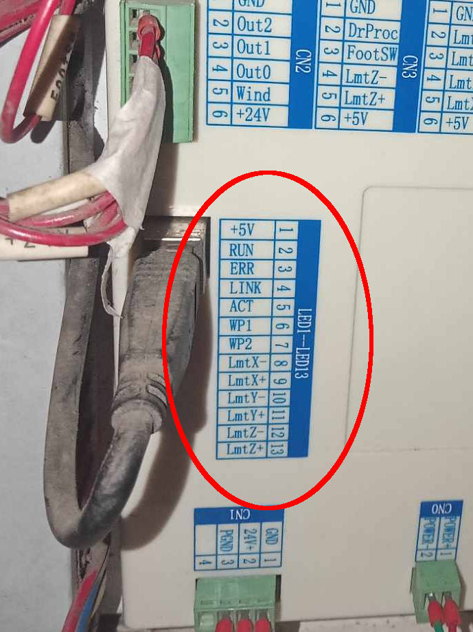

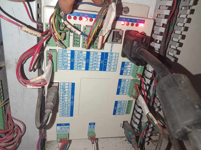

LED 8 being On suggests a problem with the LmtX- X axis home switch, because it should not be continuously active during startup. LED 10 for the LmtY- Y axis home switch is Off, so something is different between those switches.
The other indicators look plausible, so I’d look for a fault in the home switches or their wiring, rather than for a bad controller.
Also, the LED for Out2 is turned on. What is that output connected to?

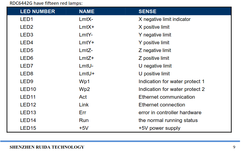

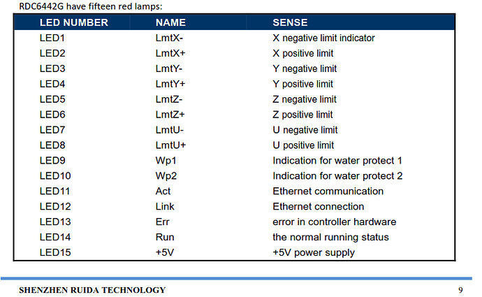

can you give me led identification why its lighting or blinking? i need diaghram to notice which i need to check on , sample LED 8 being On suggests a problem with the LmtX- X axis home switch, because it should not be continuously active during startup. this i would know , thanks for the help
The LED identification is on the controller case:
Without having a manual for that controller, I’m guessing based on other Ruida controllers we’ve seen around here.
In general, LEDs corresponding to input or output signals are On when that signal is active and Off when it’s inactive. The LmtX- and LmtY- inputs come from the home switches, so one of them is different; only you can determine which one is incorrect and why that happens.
If you don’t have a manual for the controller, you can download a few and compare them for hints about what the other LEDs mean.
Which is, of course, completely different from the chart on the back of that controller.
I’m willing to assume “the +5 V LED being On means the supply is good”, but “the LmtX- LED being On means the limit switch is active” seems like a guess requiring some verification.
