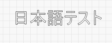

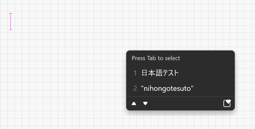

However, I’m able to do this in Windows. As you say, input is not displayed in-program and kanji conversion is not done as-in other programs. However, I’m able to choose kanji conversion in my IME and the final choice will be inputted into LightBurn.
Long story short… it’s not the normal behavior but it does work.
During input:
Post input:
