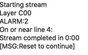

I’m only able to use the software when the job origin is set to the bottom left corner in the 9 dot selection and start from is set to current position.
You’re most likely misunderstanding how that’s supposed to work. Set the ‘Start From’ setting to ‘Absolute Coords’ for now, and read this to understand why: https://lightburnsoftware.github.io/NewDocs/CoordinatesOrigin.html
Screen Shot 2020-10-14 at 12.55.28 PM
I’m still getting this error when set to ab coords
In the console, type $# and press enter. What does it say?
ALARM:2 happens when you try to send the laser outside its known working area - the laser is refusing, and reports the alarm to tell you why (that instead of slamming into the side it just decided to yell at you instead). We just have to figure out why it’s going to be heading out of bounds.
