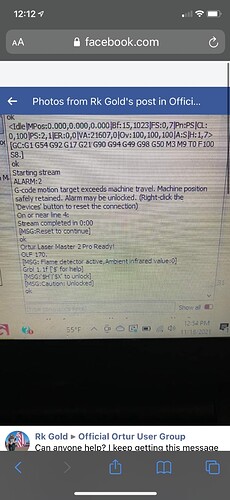

Job quits half way through…
My jobs quit half way through and this pops up on console…

I am using absolute cords
Can you provide some text as to what you’re trying to do? And provide as much detail as you can about what happens before during and after you attempt a burn.
Was this setup ever working successfully? Or this is a brand new installation?
Set up was working completely fine. I started a board one day and it the laser stopped completely half way through with the ambient flame error in the console… always stops half was through now with the same explanation in the console. I have absolute cords set.
