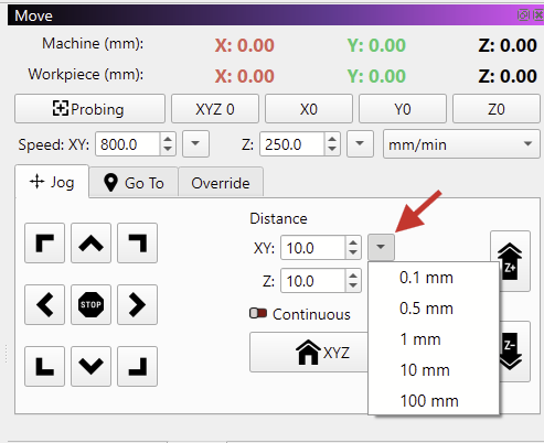

  • I’m finding it hard to get used to having to type in distance, and only having one available. It would be great if there was a quick switch between say 20/5/1/0.1/0.01, rather than having only one value and having to type it each time

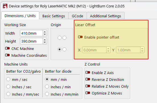

On the other hand, I love the framing. Is there a ‘framing offset’ button like the ‘laser offset’ one in lightburn for those of us with positioning optics?

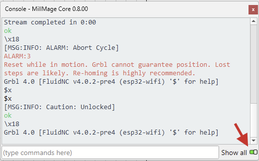

When clicking Stop, we send the controller the “Abort” command, as defined in the GCode tab of the Device Settings.
For grblHAL, that defaults to \x18
I’m guessing, the exact message you got is this:
Reset while in motion. Grbl cannot guarantee position. Lost steps are likely. Re-homing is highly recommended.
You can theoretically clear this alarm state by sending it $X, but as the message says, the controller can’t guarantee position, and re-homing is recommended.

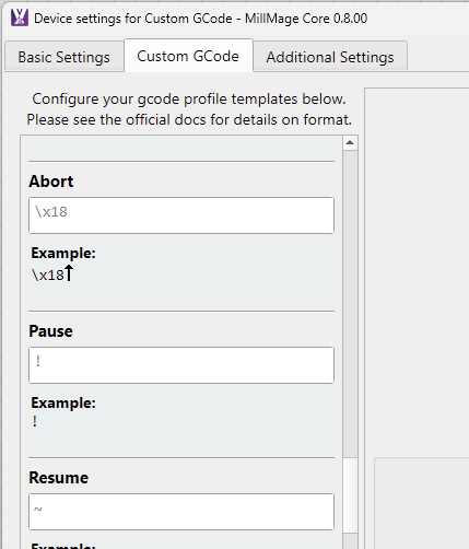

You can add a macro for this:
And (not sure if that’s the brightest idea!) even change the “Abort” Custom GCode to
\x18
$X
I’d be curious to know which other senders you are using and what they send when you click the Stop button.

We used to show all those step sizes at once, but I personally prefer the new condensed look.
Can you elaborate on what you mean here?
I’m pretty sure he means ‘laser offset’ for using with a laser pointer for positioning.
ah of course! I didn’t think there were spindles with a red dot pointer.

Exactly this. (in my case it’s a camera which helps with tramming and alignment, but I think a laser pointer would be more common here.
Drill the side of the spindle clamp, add a fixture for a camera or pointer, install and wire through cable chains. A big QOL improvement for 30 mins work :slightly_smiling_face:

Thanks. :slightly_smiling_face: I think this is more a case of me trying to get used to different workflow than anything else. I’d definitely like the option to show a couple of them, though the UI looks neater like this, so its a bit of a ui vs UX issue

Yep, that’s correct, and may be why I’m finding direct control a little problematic too. Assume that I can edit all this in the config settings, and if not there’s maybe some sort of config file I could hack around in?

But you can enter \x85 ; Jog Cancel in the “Abort” block here:
Just be aware that the Stop button in the Job Control window will stop working as intended while a job is running!
I’ve just created a request to have a separate Custom GCode option to send different commands with each of those stop buttons.

I won’t stop you from doing that, but try the “Show All” toggle in the Console window first :wink:
You’ll see exactly what MillMage sends the controller
