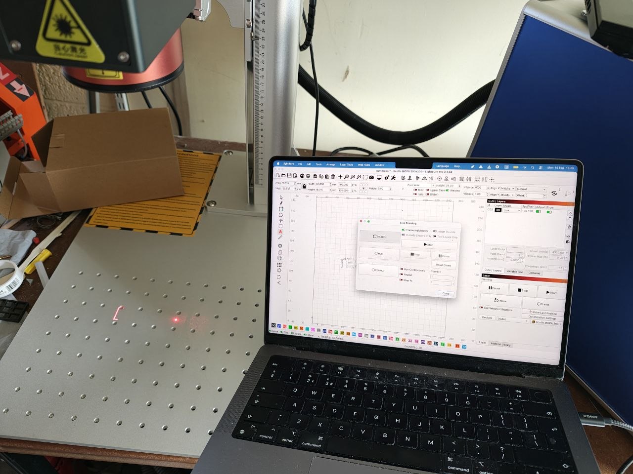

First oddity/potential problem noticed: after framing, the red laser stays in whatever position it was in and doesn’t return to origin after a short pause like it does in EZCAD3.
I tried doing a test grid, but I’m not sure if it ever did anything. There’s possibly a really faint test grid, but it’s hard to be sure. Tried multiple times, even swapping to some black anodised material to try and make it easy to spot. The laser just wasn’t firing.
I swapped back to EZCAD3 on the original Windows machine and couldn’t get the laser to fire. Spent half a day trying various things. Eventually installed LightBurn for Windows and saw that it offered an EZCAD2/3 driver, which I let it install. Still no laser output.
I tried EZCAD3 again and noticed it no longer recognised the controller and reported an error. Checked Device Manager and saw there was now a LightBurn-prefixed device and no JCZ one. Uninstalled the LightBurn one and rebooted again. The JCZ one showed up again, EZCAD3 stopped complaining, and, to my surprise and relief, I could get the source to fire again.
I would still like to try LightBurn for Mac, but I’m getting the feeling something is currently causing it to make my source lock up in some odd way (plus the framing weirdness). I’ve tried searching but don’t see anyone talking about this, so wondered if anyone has encountered this?

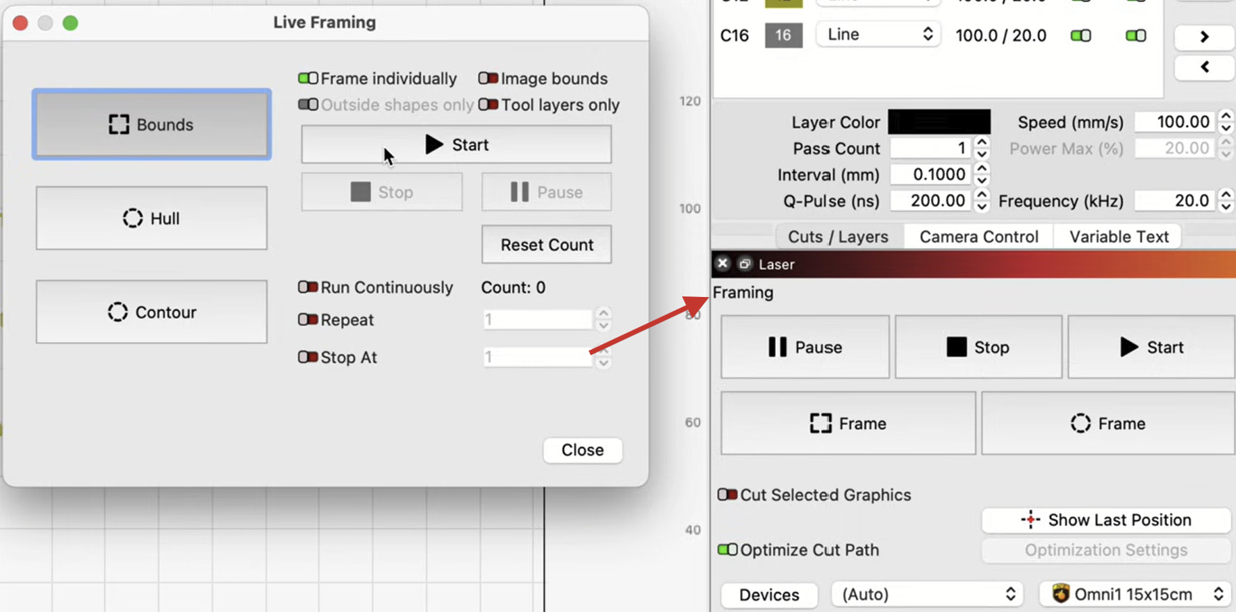

The framing behaviour is the first obvious oddity: EZCAD3 returns the red aiming point to centre after framing, whereas LightBurn leaves it wherever the galvo mirrors happen to finish. This feels like a candidate for a config issue, but could be a bug.

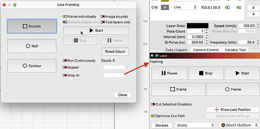

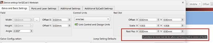

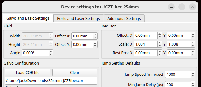

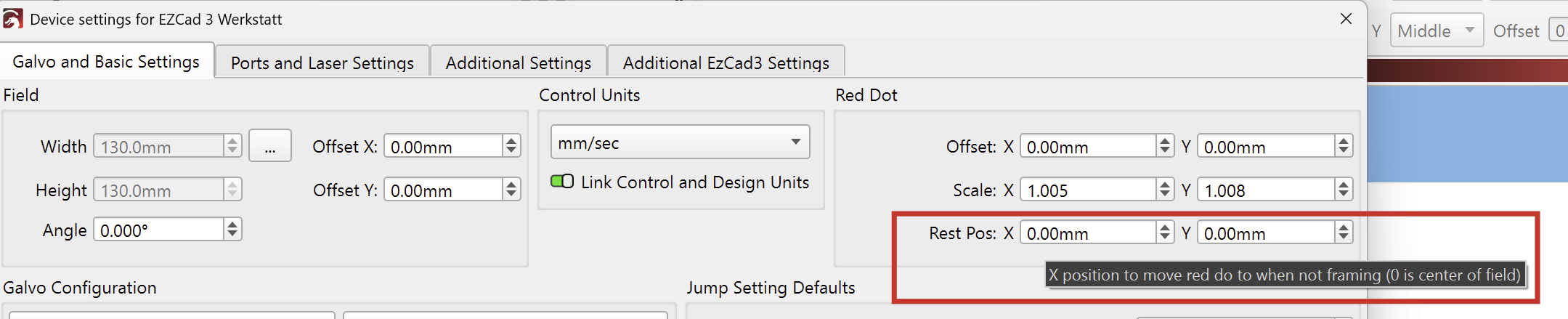

The framing red dot should return to the “Rest Position” after framing. What’s your value here?
Can you see if the laser goes to the rest position if you set x 10mm, Y 10mm for testing purposes?

I did also try setting a small Rest Position offset while investigating the framing issue (changed from X0,Y0 to X0.1,Y0.1), but it didn’t change the behaviour. I’m happy to try the specific X10/Y10 test you suggested, although given that the laser is working again I’d prefer to first establish whether there is any particular information you’d like me to capture in case the no-fire state occurs again.

When you click “Frame”, does the status in the “Laser” window here correctly change to “Framing”, and then “Busy” or “running” when you click start in that window?

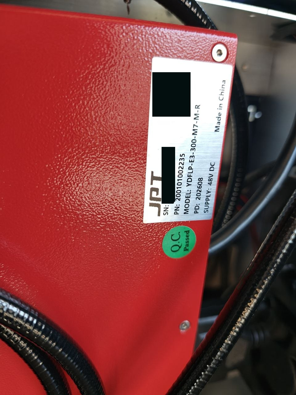

If you can paste a link to a listing page of your machine where we can see the exact laser source and galvo head that would also be of help.

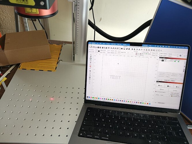

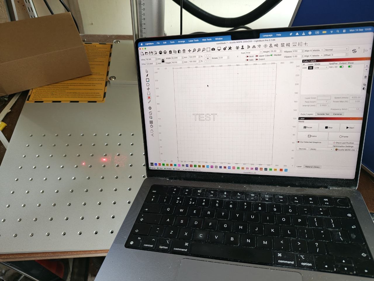

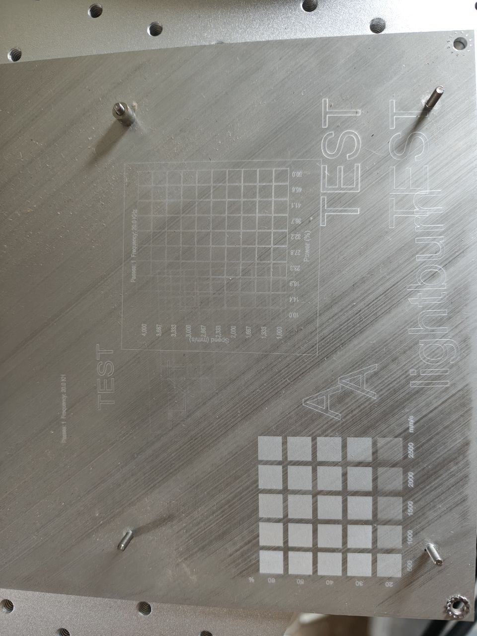

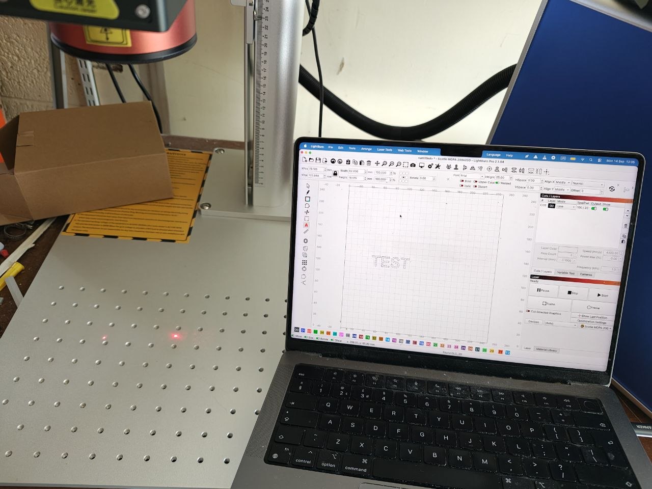

So I went back to check things, live framing window opens, and I was actually able to laser a few things without it breaking, even tried stopping a test grid mid way to see if that got it into the odd state again but it behaved normally.

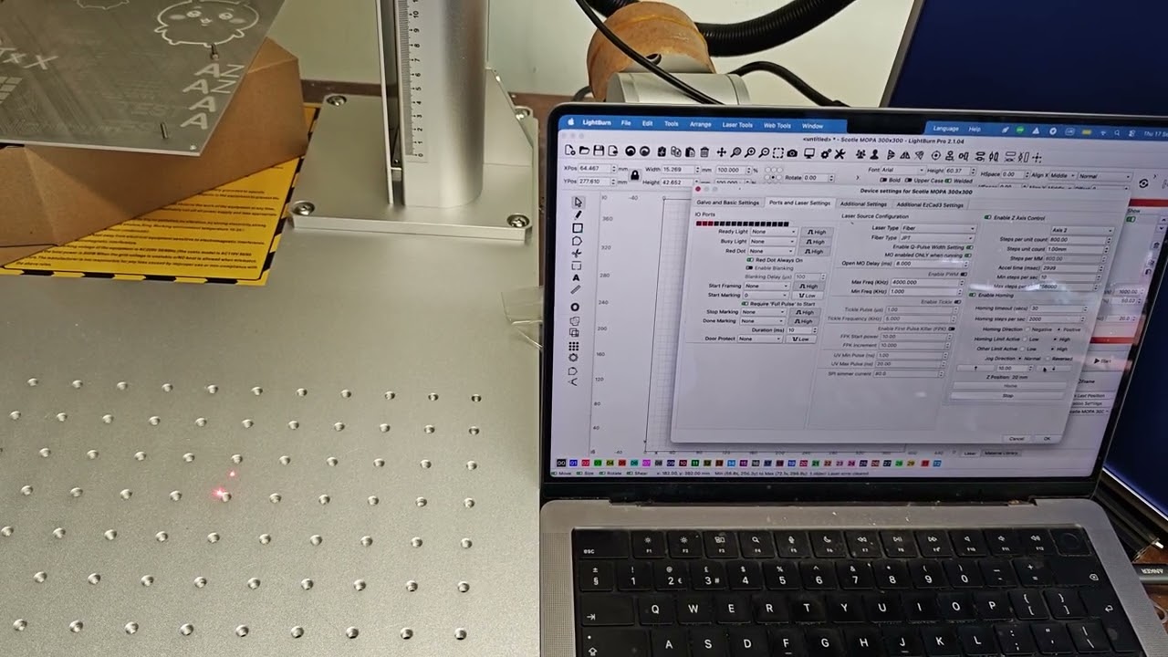

The red indicator still never centres no matter what I tried putting for the X/Y rest position, it always stops in a position somewhere along what it was tracing. If fire a job and it completes it goes back to tracing the outline.
A couple of photos showing what I mean
But at least I got this test grid and text samples to match my EZCAD3 ones which is a significant improvement.
So maybe before was just a random occurance for locking everything up, I will continue to monitor.

When you create a device for Lightburn, you load the controller information, via the mark7cfg file. This may be a different file name for EZCad3, but it needs to be configured. When you switch to the device, it again, loads the configuration that you told it to use.
Mine returns to the center, directly under the beam, using Lightburn on my galvo.
As far as I’ve been told, the home location or 0,0 is front left, mine goes back to where it started. I believe my visible light led is within the fiber source.
What I’m saying is the control board is loaded by each piece of software, either EZCad3 or Lightburn loads the controller configuration, there is no default state, that I know of.

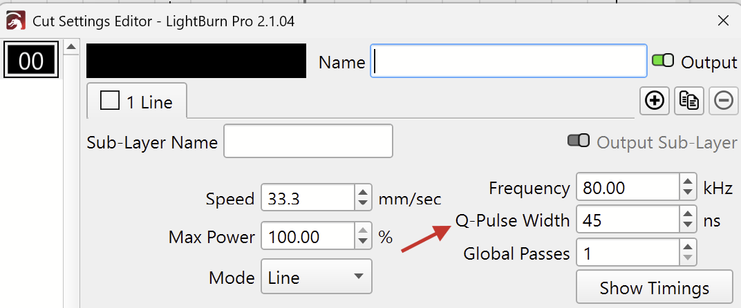

(You probably enabled the Q-Pulse setting, because this didn’t get set correctly from the config file. We’re looking into this.)

Your JPT YDFLP-E3-300-M7-M-R is a MOPA source, so it should definitely have the “Q-Pulse Width Setting” enabled in Device Settings. Otherwise, you don’t get this in the Cut Settings:

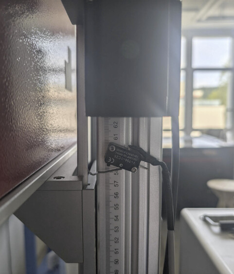

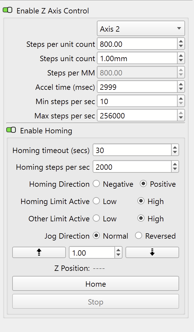

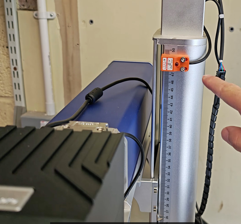

Homing should work, if you have a motorized Z axis and a limit switch.
The Motors.ini config file you importet sets “Axis 2” for Z.
Does anything happen if you click “Home” here?
You change it to a different Axis (there are 6 options), and tweak the “Homing Direction” and “Homing Limit Active”
The “issue” being that the red dot laser doesn’t return to the center after framing?
To be sure: Did you exit the framing window? At least, on connecting to the controller, the red dot should be centered.

Q-Pulse Width Setting - No problems
MO enabled ONLY when running - No problems
Jogging up and down - no probelms
Home with various different settings no movement of the Z at all

Thanks for the confirmation. Good to hear that the Z-Axis moved with the jog buttons.

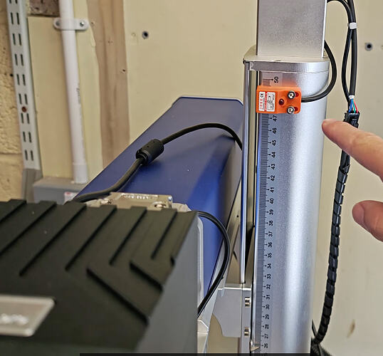

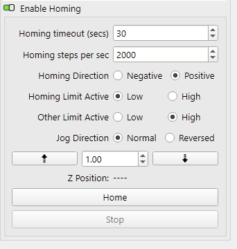

Does your home axis have physical limit switches?
On one of our machines, that’s just a regular switch mounted on the collumn, that gets triggered then the way up
Did you try changing the “Homing Direction” and/or the “Homing Limit Active” here?
For example: if the endstop switch is “Active High” (electrically closed when triggered) the above settings would tell LightBurn that the switch is closed when it’s open.

I have one of those cheap chinese non contact sensors I think, not actually checked which type it is but tried a few different settings in the homing stuff
I’ll have a proper look tonight.

The red dot not returning to the rest position is a bug. I haven’t seen that on our machine. (Using a similar-looking galvo head with the integrated controller.)

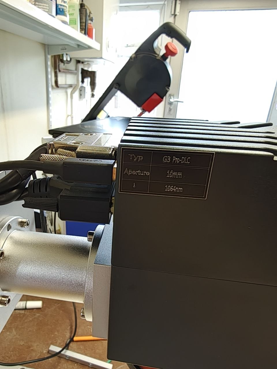

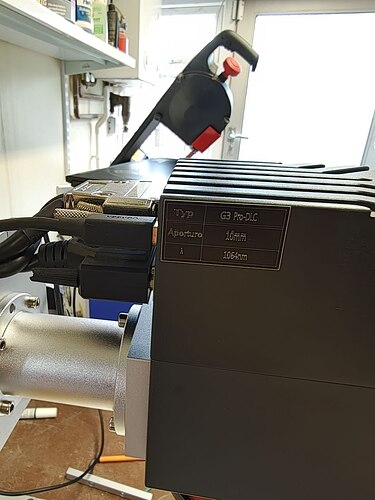

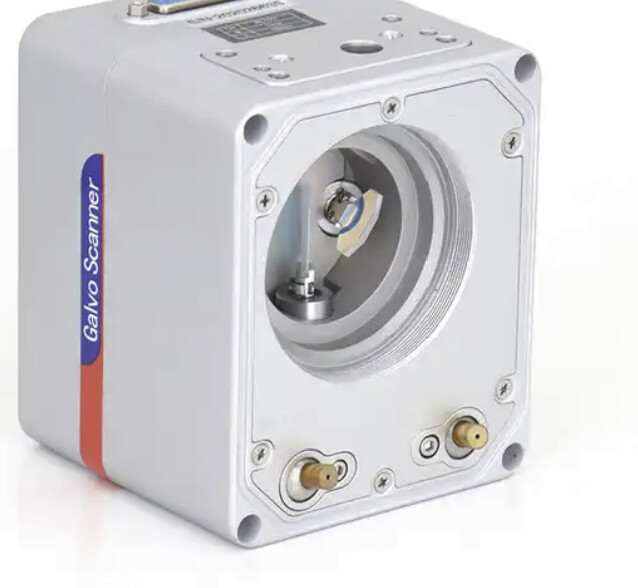

Usually, the stationary red dot is mounted next to the lens and needs to be adjusted to converge with the other dot at the focal distance. This one has two with set screws:
Your G3 Pro DLC-10 doesn’t have this, so I’m unsure how to adjust them.
Possibly with an offset in the Device Settings.
