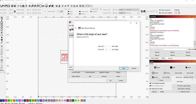

Just getting started with my Sculpfun S9 coming up on screen ( error 5 ) dont know what to do can you please help?
new to laser got a Sculpfun S9 coming up with ( error 5 ) can you help please

I have done all this as shown but Laser wont do anything after i get it to move to center it just stops and the window on lightburn program is error 5 I dont know what to do next

“Disable Auto-home at startup”

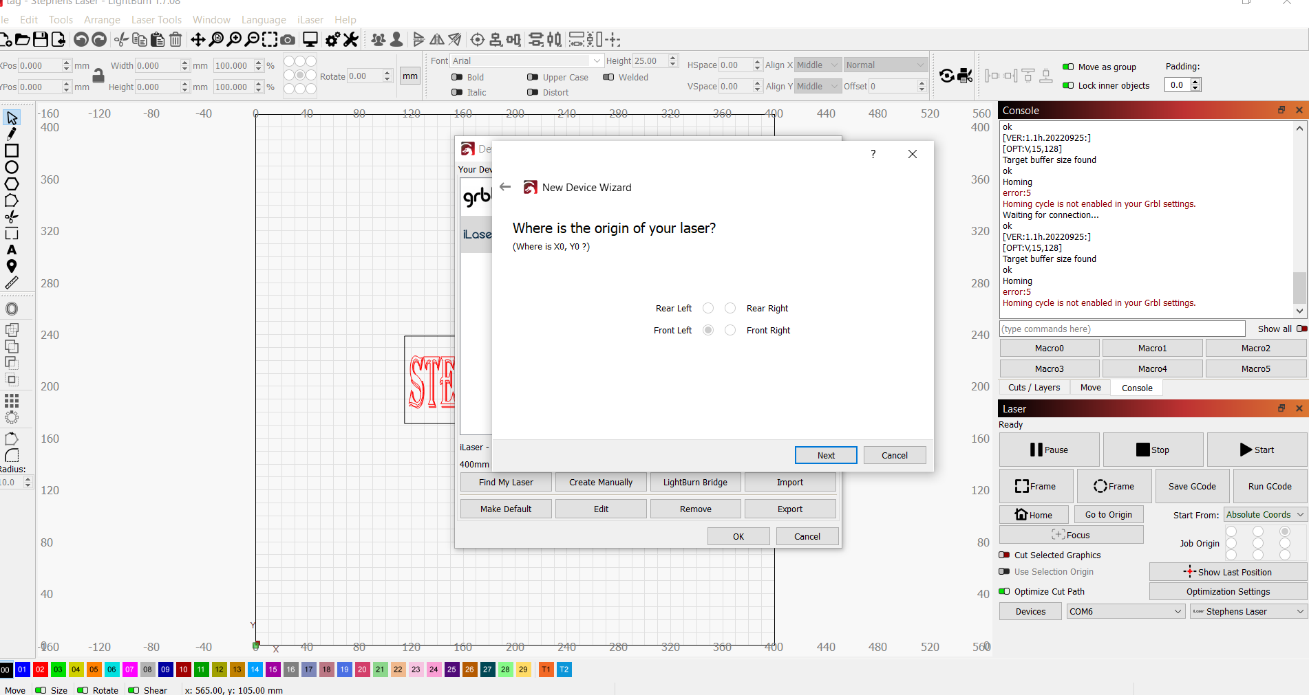

how do I get the device settings back up ?
I have Clicked on Device
then selected device.
clicked on edit.
next. selected my Laser
next. laser name and dimentions
next start position (bottom left ) but no auto home and unable to edit
next click to finish

The error 5 is not really an error, it’s just a warning and does not prohibit the function of the laser.

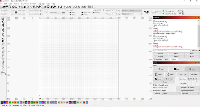

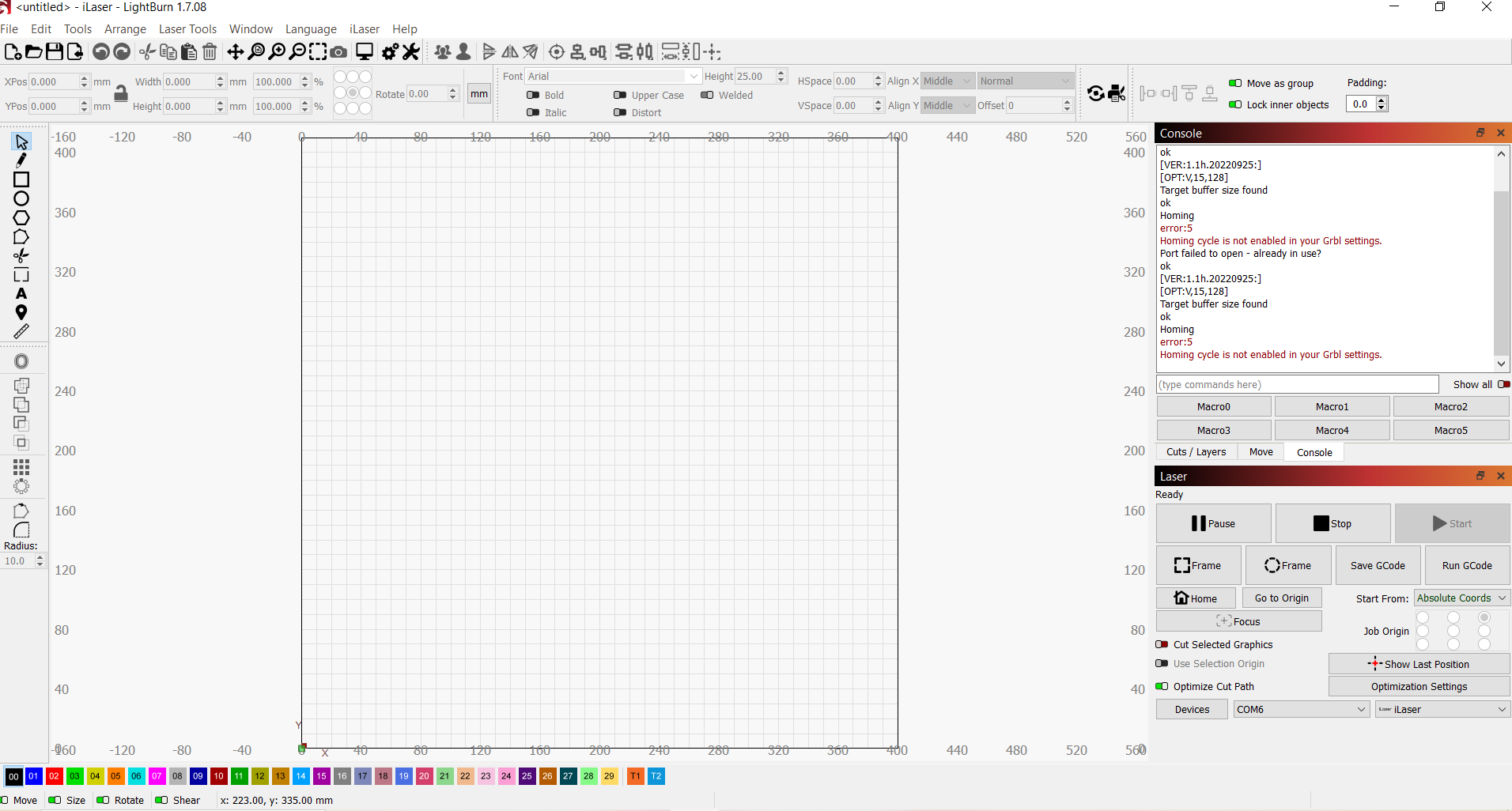

i also have error 20 coming up when i try to do a material test
error:20
can someone please help
Unsupported or invalid g-code command found in block.
On or near line 0:
Job halted
Stream completed in 0:00
ok
This error sounds like you are either using the wrong device type ( it should be grbl) or you enabled gcode clustering in device settings. Turn that off.
