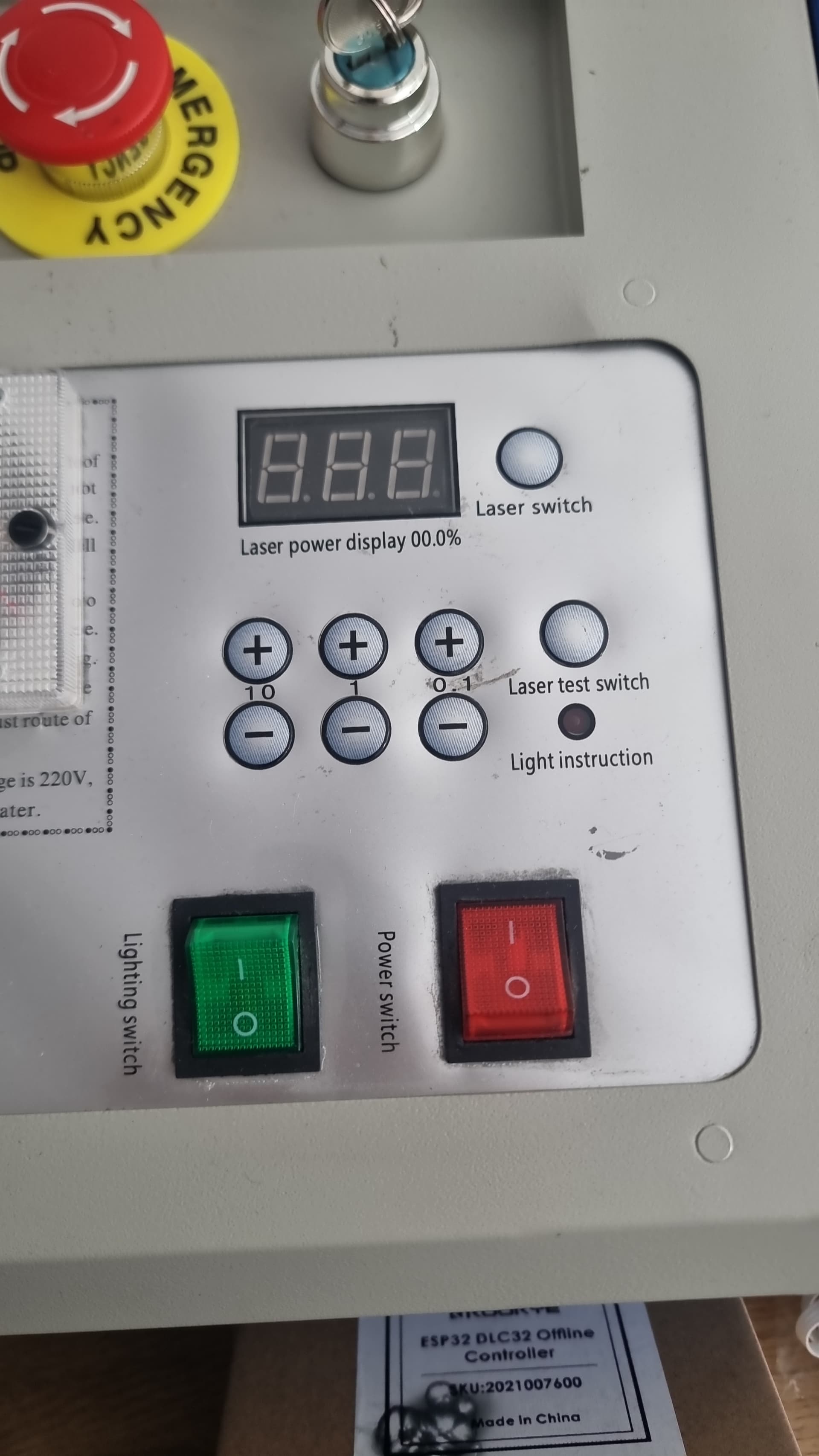

Has anyone ever set up a k40 with an aurdino due board to run lightburn.
I have been told it can be done but im having a nightmare figuring it out
Any help would be greatly appreciated

Its mainly thr pin outputs. I have had a bit of sucess today as i managed to get the board to shownon lightburn and can control the stepper motors but im stuck on the pins for laser control

Do you have a pot/meter on your console for power control?
There are a couple of ways of wiring these, but I don’t really know what you have there…

How does your power meter work? I don’t see any connections for it in the information …
Many times this is used to supply a dc voltage to the IN terminal of the lps… where does it go?

If you’re building a controller, It doesn’t Run LightBurn per se. The controller you’d want to build would just be a friendly robot that LightBurn talks to.
Step 1 for a project of unknowns is a Literature Review. 🙂
> **[Porting GRBL to DUE](https://forum.arduino.cc/t/porting-grbl-to-due/405937)**
> Simple : Will GRBL run "as is" on the DUE or will I have to do a lot of troubleshooting first? The story: The UNO/MEGA boards are simply too "light" for what I need to do. I doubt very much if they can handle a genuine independent 4th axis (if...
> **[Arduino Due CNC Protoneer v3 · grblHAL/core · Discussion #120](https://github.com/grblHAL/core/discussions/120)**
> Hi guys, my previous \>\>link\>\> discussion has been closed. I don't know if this is a good place to start this topic but in other places like here (https://github.com/grblHAL/SAM3X8E) I can't start a...
> **[Genuine Protoneer CNC Shield v3.51 for Arduino Engraver CNC GRBL 1.1](https://www.zyltech.com/genuine-protoneer-cnc-shield-v3-51-for-arduino-engraver-cnc-grbl-1-1/)**
> Price: USD 14.95
> **[Arduino CNC Shield – 100% GRBL Compatable](https://blog.protoneer.co.nz/arduino-cnc-shield/)**
> Do it yourself CNC projects are popping up everywhere and we decided that we wanted to contribute to the growth. Here are a few of our design goals: Modular Design – We wanted to do more than…
> **[Arduino CNC Shield V3.XX – Assembly Guide](https://blog.protoneer.co.nz/arduino-cnc-shield-v3-00-assembly-guide/)**
> This is a quick guide to help with assembling the Arduino CNC Shield V3.XX. We also have a discussion forum for this board :  Contents: Assembly Steps First Run Jumper Settings. 4th Axis Configurat…
These might get you moving toward your goal.
