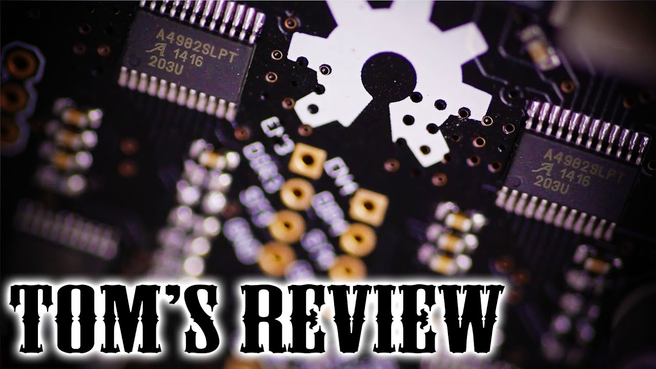

Thomas Sanladerer has done a good review, obviously geared towards his environment of 3D printing, but goes over a lot of detail
[![](https://img.youtube.com/vi/vsu_vAKvRO0/maxresdefault.jpg "The Smoothieboard") ](https://www.youtube.com/watch?v=vsu_vAKvRO0)
