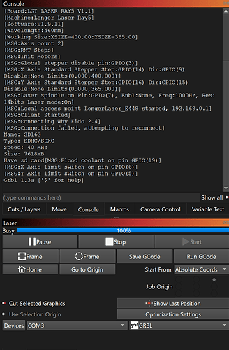

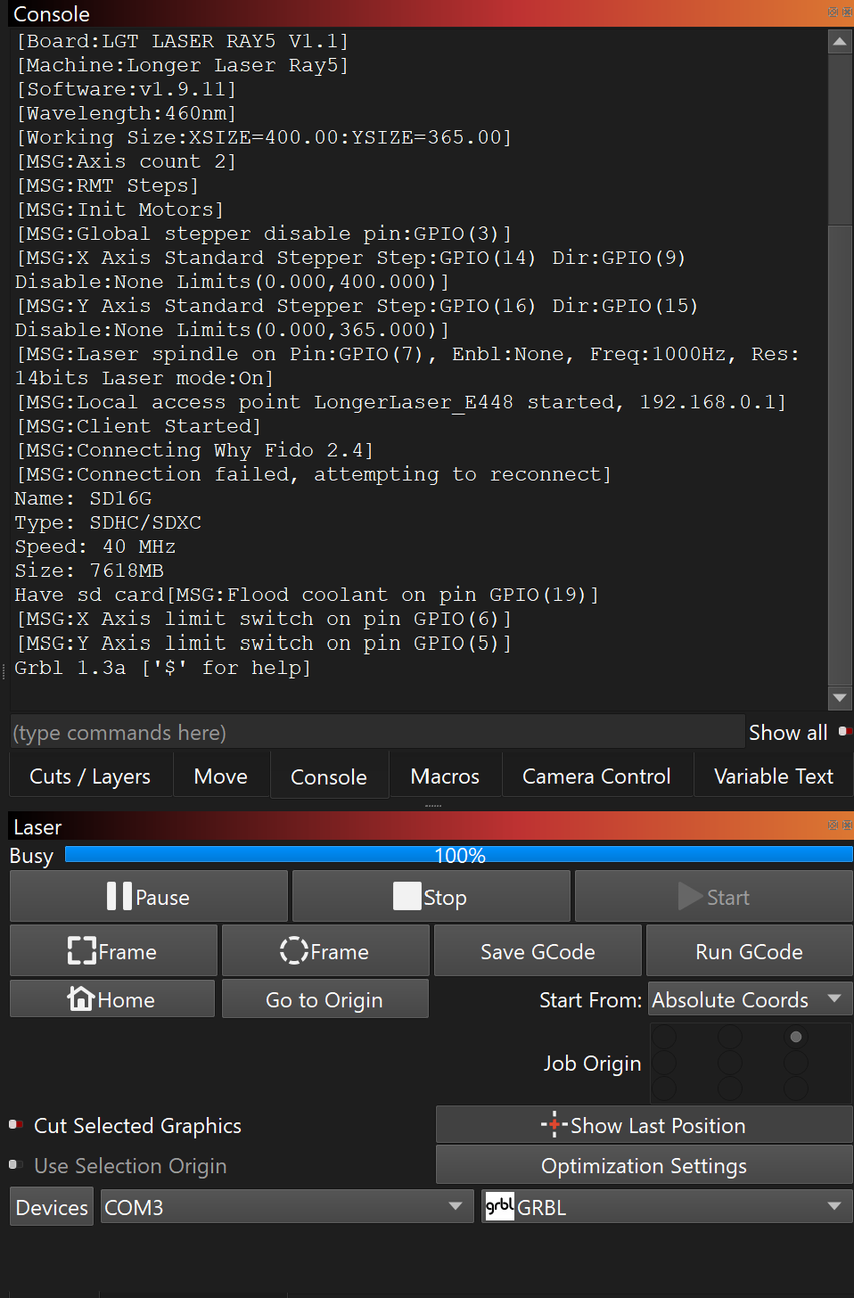

Keep getting this same error :/
Okay same thing with COM 3, busy.
Try clicking the ‘Stop’ button when it’s in this state.
I have, it doesn’t do anything.
What about toggling the ‘Enable DTR’ setting in device settings?
That fixed it!!! Thank you so much! What is DTR?
UPDATE: As soon as I posted this, I saw you had solved it with the DTR switch. It is a communications setting that used more handshaking, like yes/no, during data transfer. Glad you are up and running!
Techie Talk: Lightburn has no control over which COM port it is allowed to use. This is decided by Windows when the laser is connected. The decision is made during the handshake between Windows and the laser. Usually, based on the GUID of the laser controller, Windows will assign the same COM port, but NOT always. If that COM port is already in use by something else, you get the “Busy” message.
