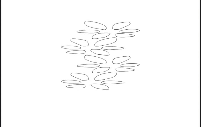

Keeping original shape
I havean issue with my project. I’m trying to twist
or turn this shape and keep it
exactly the same. When I do
it, the shapes change and stretch.
How to correct this?

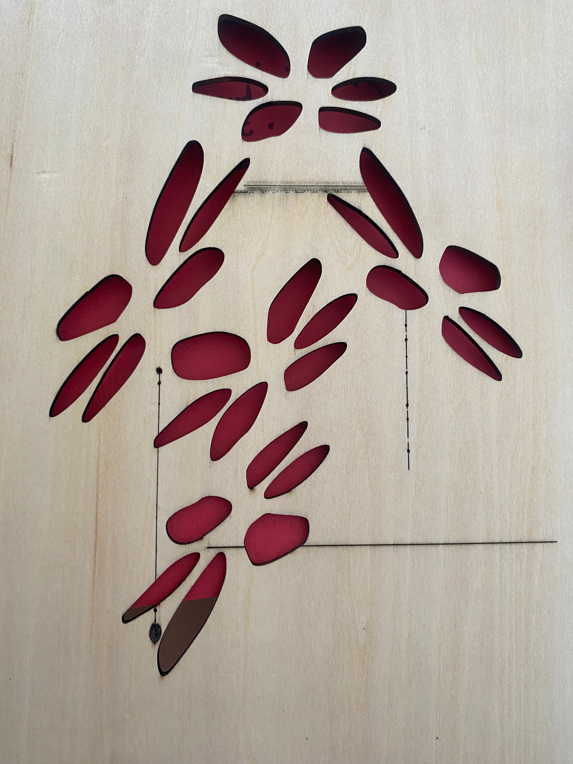

Hi again, this is the method I’ve been using all along. I realised the difference between the two tools, one stretches and the other one in the corner SHOULD ONLY TURN NOT CHANGE THE SHAPE. As you can see in my picture, this is not happening, my flowers are getting distorted as if I were using the stretch tool.
Please help me figure this out, it’s becoming very frustrating and yet it should be so simple.

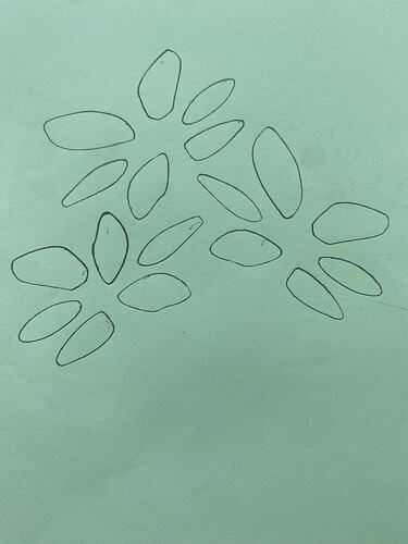

This is what we’re trying to accomplish. We even tried to disable the Size, shear button, so that we could only move and rotate without distorting the size but still it still strech and distorted.
I can’t see how this is happening without something strange in the file.

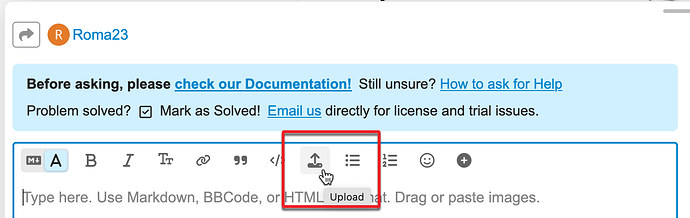

If you’re willing to share the file. Please send it to me directly.
I’ve been waiting for the reply, but it seems like my file didn’t get through. Is there any way I could send the file?
@Roma23, Please upload your .lbrn2 project file here, and we will review it.
