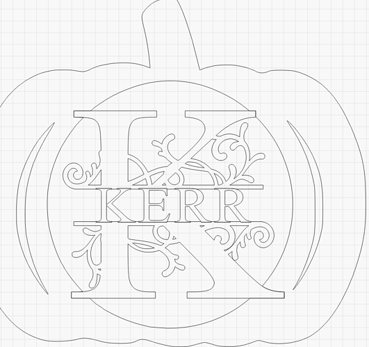

Boolean operations are performed on closed areas, so the results will always be a closed shape as well. Can you show what you were working with, and what you wanted as a result? There might be a different tool, better suited for your goal.

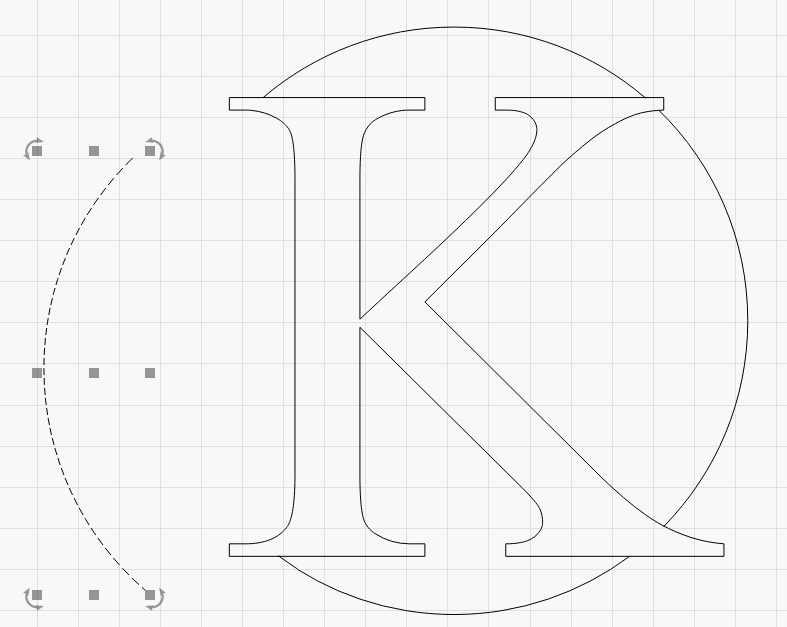

That’s a tricky one - If you’re just vector marking the whole thing, I’d recommend using the Edit Nodes tool and using ‘T’ (Trim) to remove the sections you don’t want manually, like this:

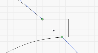

Select the shape to edit, and make sure it’s a path (Convert to Path if necessary), then go to Edit Nodes, hover over the line to remove, like this:

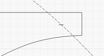

Pressing ‘T’ to trim the line under the cursor will do this:
The result is just lines, not closed shapes, like this:
