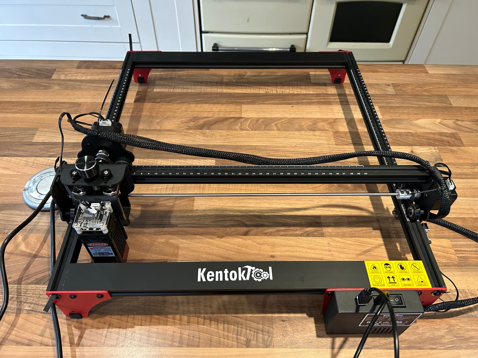

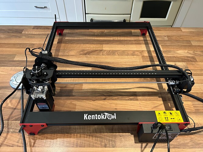

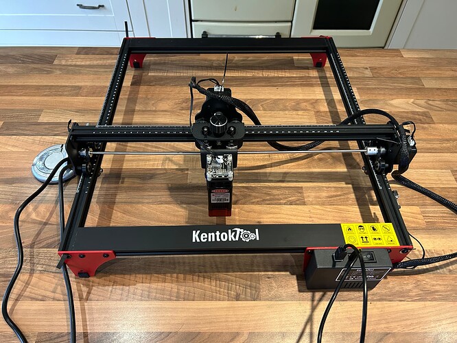

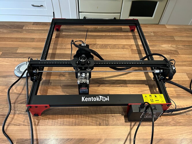

I am pretty new to using Lightburn and am having some issues with getting it to work as expected with my Kentoktool LE400 Pro machine.
It seems that there is somthing not right with the amount the X axis travels. I have readjusted the belt tention for the X axis but still the same issue;
-I home the machine:
-I send the laser head to 50mm on the X and 50mm on the Y and get this:
-Then try sending back to 0,0 and get:
Am I missing somthing or being really stupid? Any help anyone can offer is appreciated.

Looks like sending it to x50y50 gets you more like x200y50 and sending it back to x0y0 gets you x150y0?
When is that hard limit trigger error popping up?
Yes, that’s about right i’d day.
The Hard Limit is triggering on the Y but not the X when sending it back to 0,0
