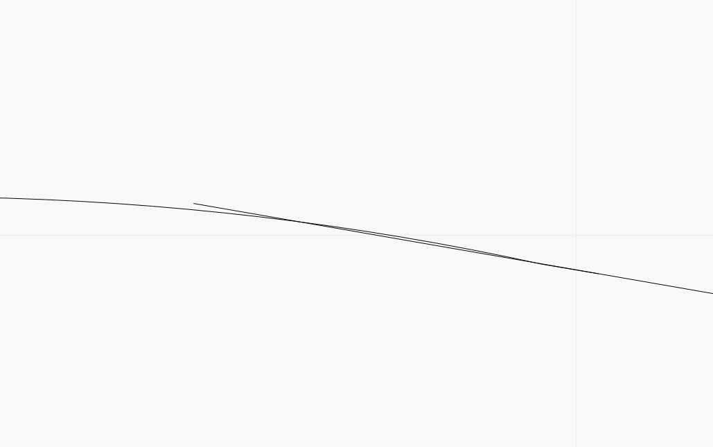

Trying to apply a kerf to a shape with holes in it. The kerf applies fine to the holes but not the outline (see picture-I’ve exaggerated the kerf for illustration).
Select open shapes shows the outline as open, yet it is not. I’ve broken it apart and reapplied auto join and it is selectable as a single continuous line.
What could be causing this? I’ve tried recreating my steps a zillion times, but no luck.

The large shape is not closed
If LightBurn indicates that the shape is not closed it will treat it as so in any case.
Looking at your outline it looks like there’s a problem at closing the start/end segments. There was overlap of the segments rather than the end nodes joining.
I’ve separated them out here to illustrate:

You will have to move the nodes to see the overlap. They’re literally on top of each other. I’ve moved them in my screenshot.
Disconnects will by definition occur at the start and end of a shape. When editing nodes you can see the green squares representing the start/end nodes. For a closed shape you will only have a single green square node. When moving that node both side segments of that node should move along with it. If the node separates from adjacent parts of the shape then the node is not joined.
Imagine a loop where the ends are not joined. You can select the whole line but still not resulting in a closed shape.

Well, it tell you the shape was open is the first indication. Then you go looking for where that might be. The method I conveyed earlier is a way to do that.
In this case I reviewed the model again and you can visually see the separation at the ends.
I guess this depends on what you could possibly expect it to do. I don’t see a practical way of automating this without a fundamental change to your design.
You could attempt to use “Close shape with tolerance” to do this but this wouldn’t be acceptable solution for me given the type of change. This will be up to you in terms of your work tolerances. In this case if you close with tolerance you’ll have areas burned more than once and slightly off from one another. Additionally if your plan is to incorporate kerf that would need to be accounted for. That might actually “even out” the issue caused by this but sounds to me like if you’re at a point where you care about kerf for a better fit that you’d want ultimate control over how the shape is closed.
I guess the real question is how did the design end up in this state? Any proper design would not have left this in this state to begin with.
