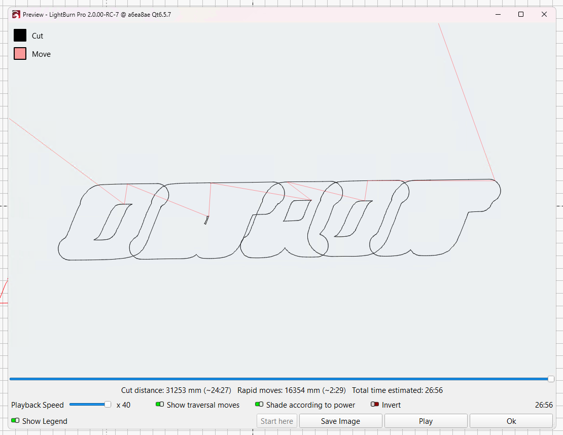

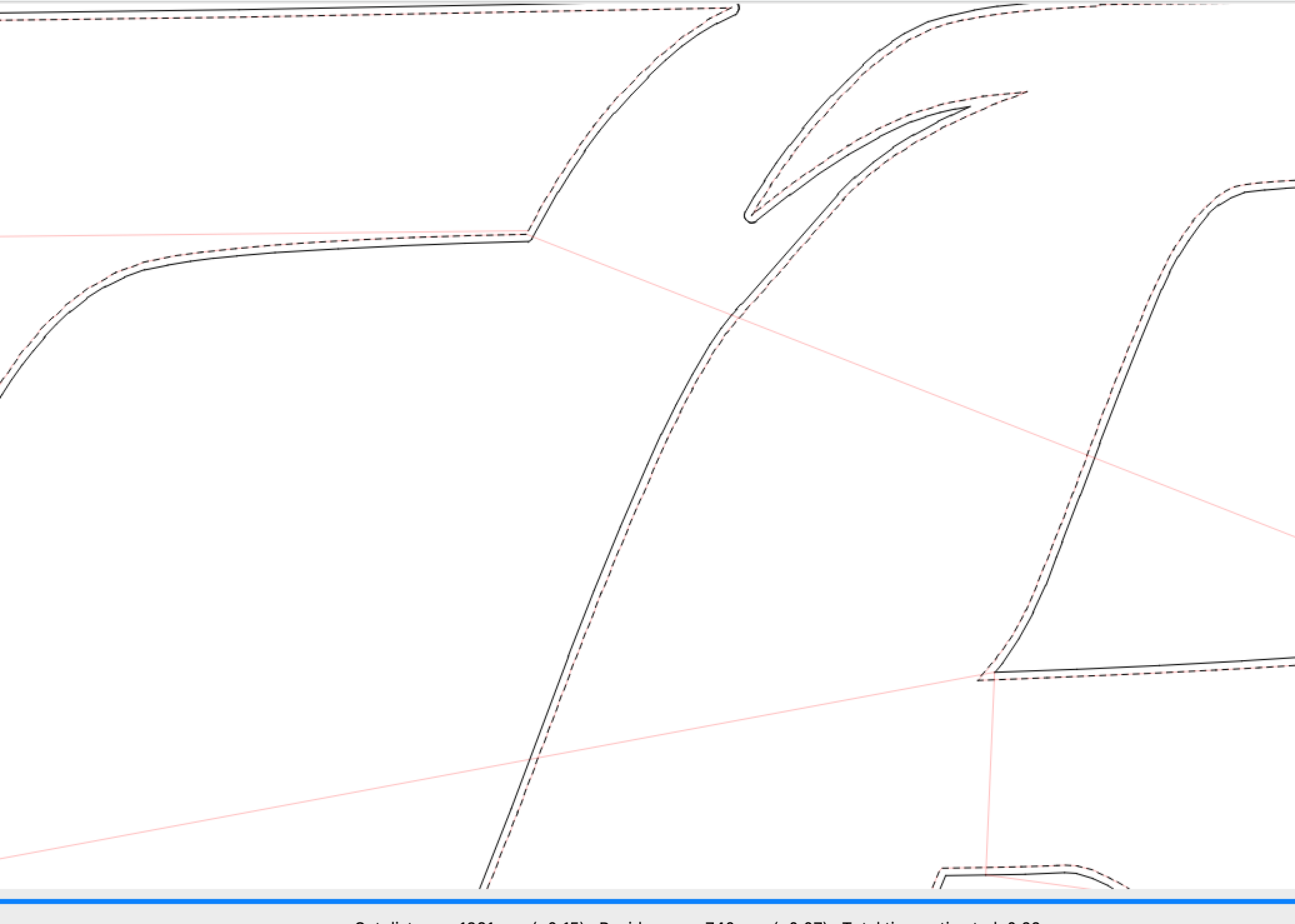

I duplicated the design and put the duplicate on a separate layer then added the kerf offset to one of the layers only. Opened the preview window and this is what I got. The preview window won’t show the kerf offset by itself, you need a copy to compare it to. I put the non offset copy into perforation mode to help verify which direction the offset actually goes. Once you verify the offset in preview, you can delete the perforated copy.

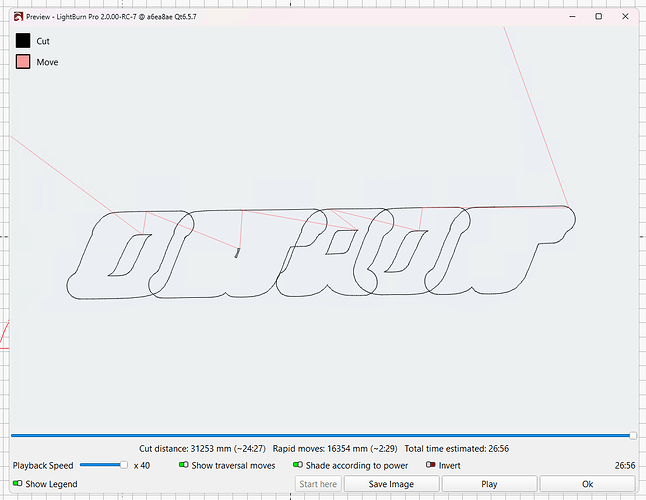

Loading the file, selecting the “DETROTT” shapes (because I have Cut Selected Graphics turned On), and running Preview produces this:

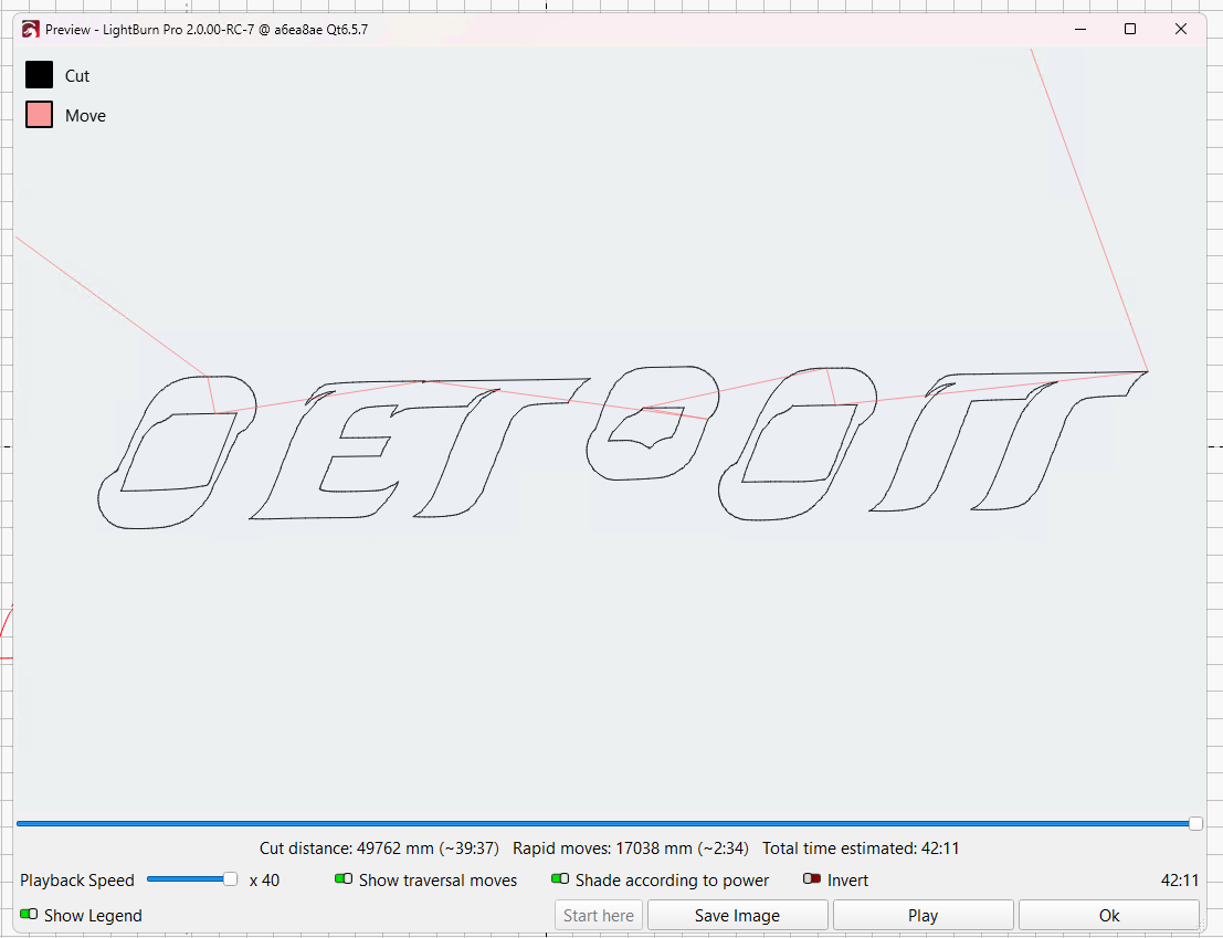

Setting the layer’s Kerf offset to -5 mm (inward):

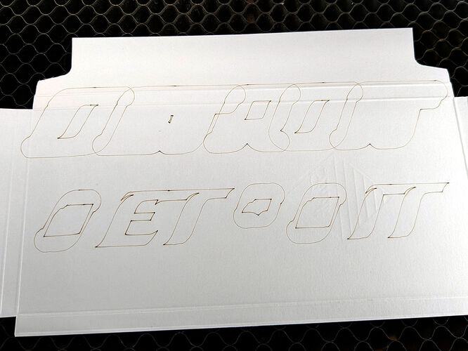

Setting the speed & power to mark cardboard produced these results:
So the Kerf offset behaves as expected on my machine for the “DETROTT” shapes in that file.
