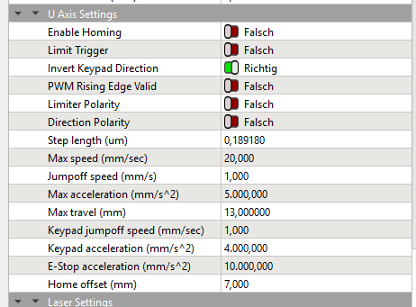

Likely the Z axis (or U axis, whatever) speed or acceleration are too high and the motor is stalling.
In Machine Settings → Vendor Settings, set:
  • Max Speed = 10 mm/s
  • Max Acceleration = 100 mm/s²
If that doesn’t improve the situation, other problems rear their ugly heads …
I agree, it sounds like someting with the speed and/or acceleration settings is not right. In this type of controller, both axis (Z and U) are available in the vendor settings. I would simply recommend setting both the same way.
Ed already mentioned the max. speed & acceleration settings… According to the description of the problem, I would also take a look on the setting for the jumpoff speed. Set this to 4mm/s.
And please also check the Home offset setting of each axis. If this is set to 0,000mm AND if the Focus Distance under the Miscellenous section is set to 0,0mm as well, the autofocus won’t work at all. It will engage the limit switch and stay where it’s at….

I finally had some time to go through your tips and do a few tests. Here’s what I did:
These were the original Vendor Settings:
These are the changes I made:
I changed the value for “Max Acceleration” from 5000 to 100. It seems to behave a bit better now, but the motor still sounds strange and sometimes stops completely.
I’m also not really sure about the meaning of the other settings like “Enable Homing,” “Limit Trigger,” “Invert Keypad Direction” (I don’t even have a keypad!), or “PWM Rising Edge Valid.”
Which of these should be copied from the Z-axis to the U-axis, or the other way around?
Should I really increase the Jump-off speed so that the motor starts moving more reliably from a standstill?
