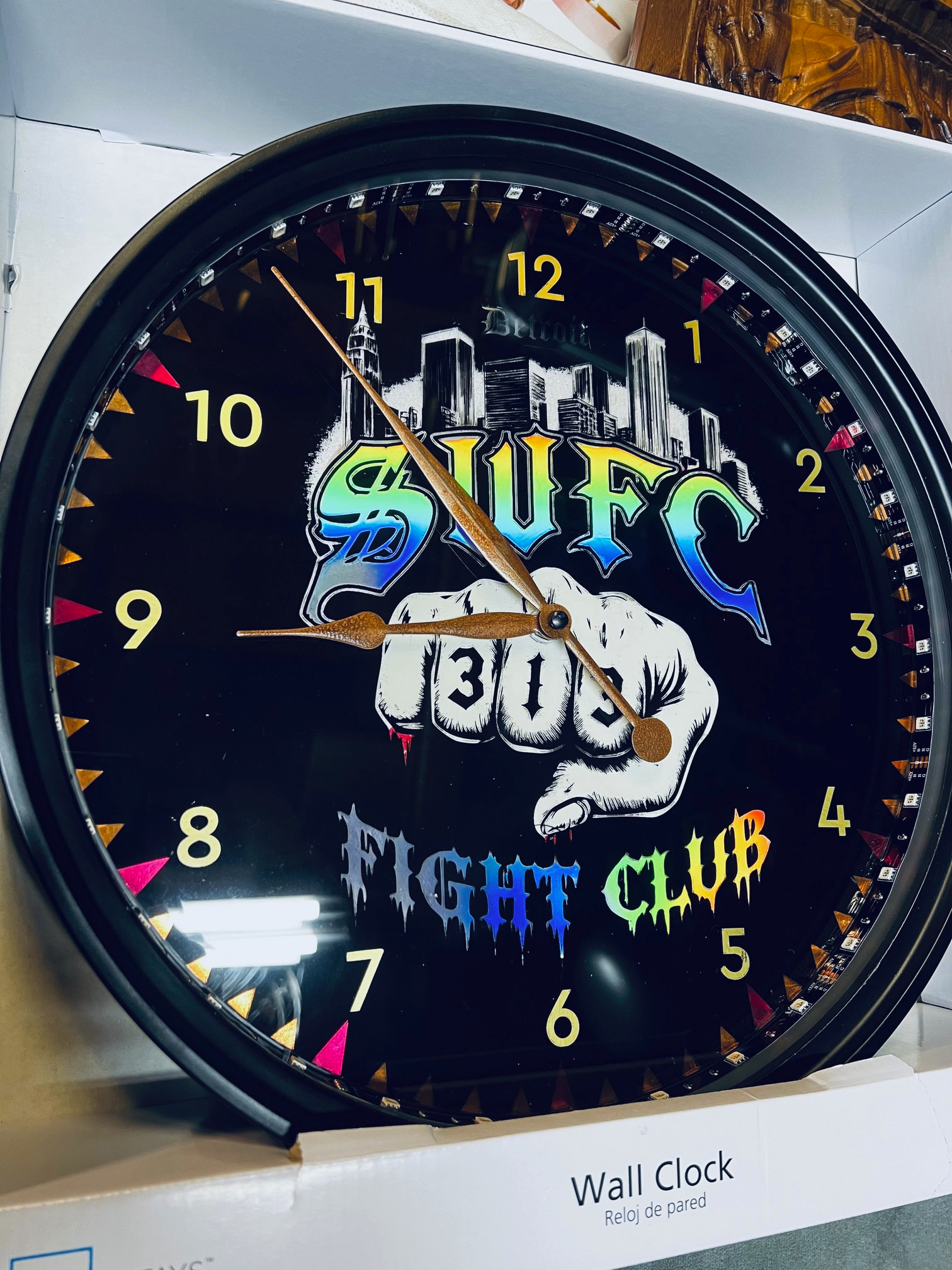

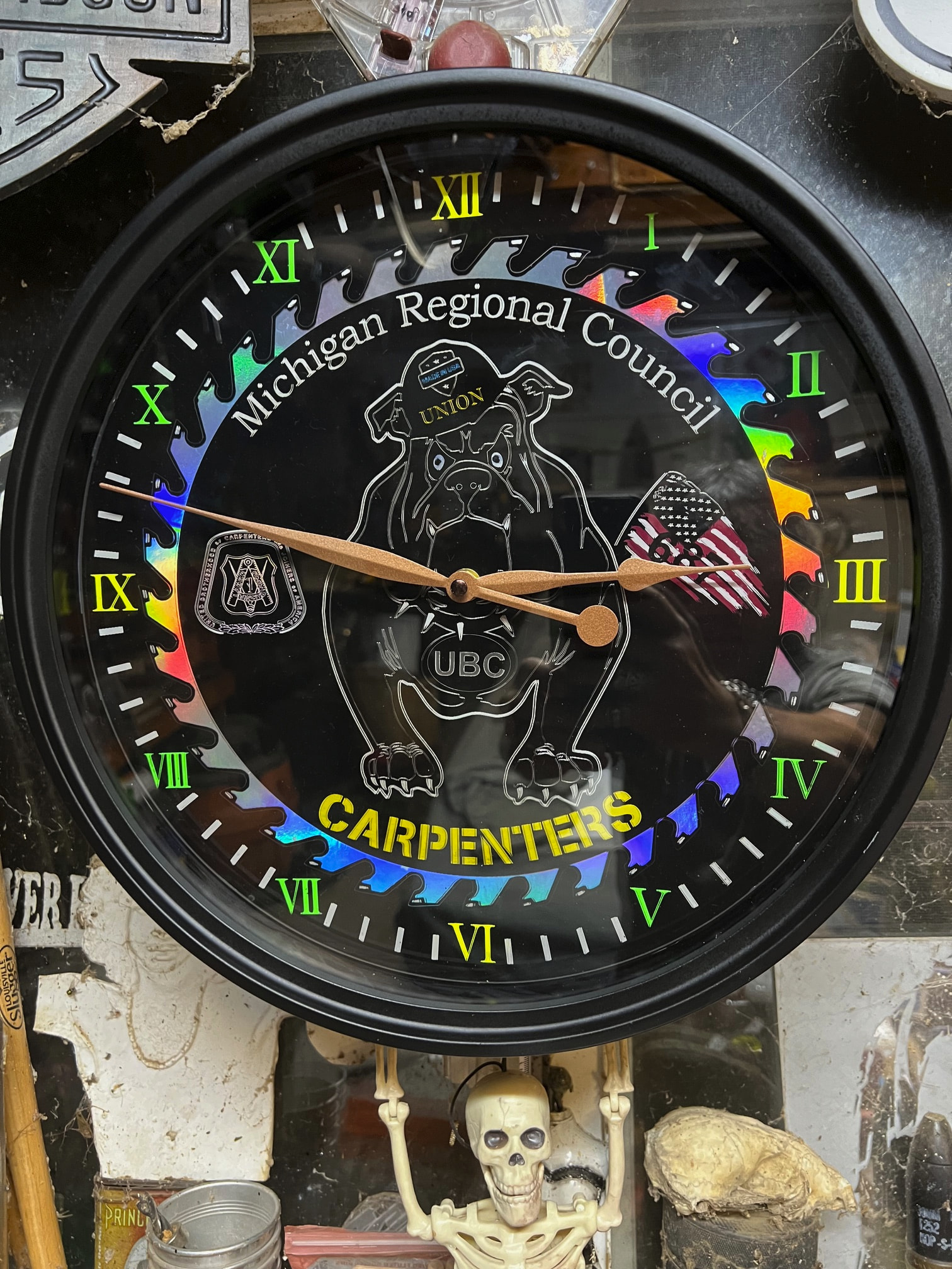

Got a clock from walmart, disassembled it and basically created a new face for it. I used a .125" plexiglas circle cut the same size at the old clock face, spray painted it black. Once the revered image was lasered onto the plexi, everything was clear, then I just used whatever color backings I wanted - This was made for a buddy of mine who runs a fitness/boxing gym for kids, just about any design/logo can be made, I did one for my carpenters union too. Notice the 1st one I installed a LED ring, other one is unlit, personally I like them better unlit. I can only use black for the initial background because my fiber laser won’t touch light colors, but I think black is best anyhow. total cost for the clock, plexi, led’s/controller/plug is around $30-$35
