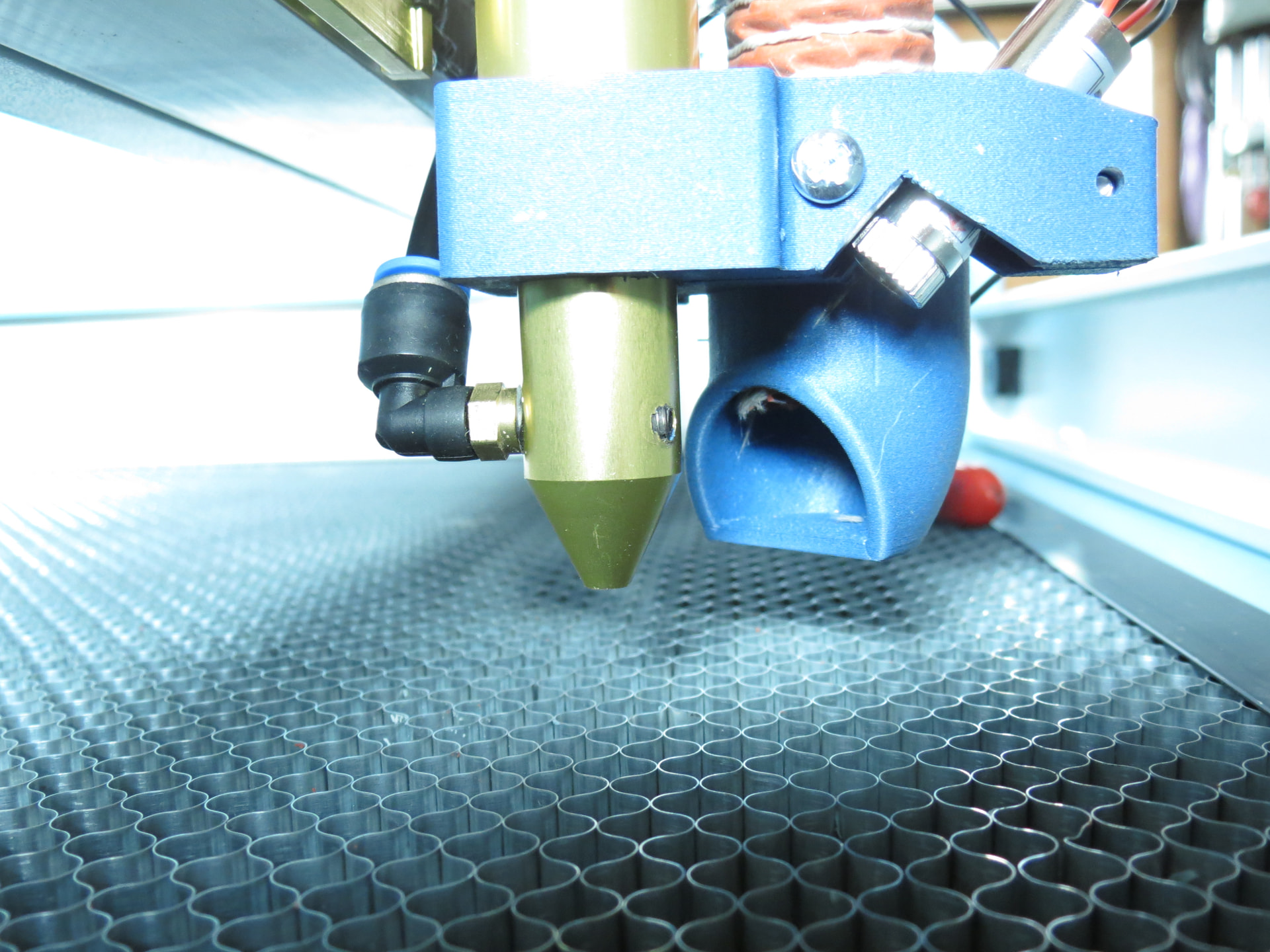

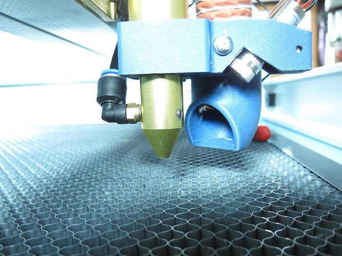

Hi,
I’m currently fumbling around with my yet unused 100W cutting laser.
I mounted a carrier for laser diodes and a vac hose, therefore I had to turn the nozzle for 180°:
 ![IMG_3205](https://forum.lightburnsoftware.com/uploads/default/original/3X/9/f/9fe8e5df84814feea9d7efa0bd9ae57040771744.jpeg)
The air assist inlet is now at the back side, was in front. Therefore the vertical nozzle position changed for 1/2 the thread inclination…this should only affect the z laser focus afaik?
First check showed that the laser cut is oval - what happened?
Did I disasjust something…can’t imagine where as the laser beam should be round at all times.
Is it a manufacturing fault? A mirror not plane?
I tried this tiny screw in the nozzle without visible change…what is it for? I assume it holds the optics inside?

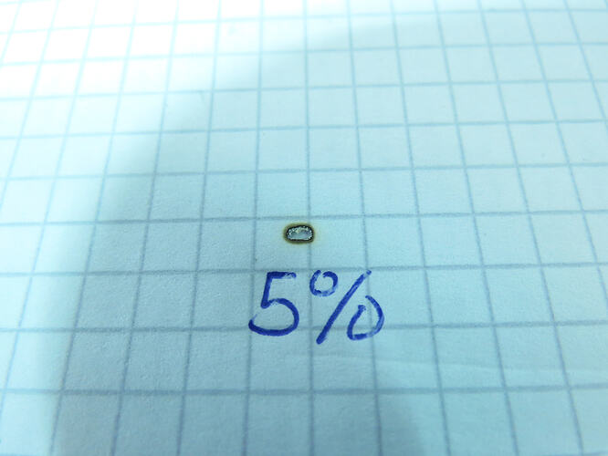

Ooookay…beginners mistake, learnt a lot now: it was a manufacturer adjustment mistake.
After some thinking I got to the conclusion that it must be a question of focusing the beam to the lens. Too much out of center will produce a distortion in x or y.
So I fumbled around with a 5.5mm wrench, a pinpointed pliers and some chilling music. On both mirrors.
In the end it’s quite logic: swiveling the beam in y (middle mirror) will produce blurr in y, but it’s the trick to do it at the right mirror. A biiiiit to much and the beam is gone entirely.
You will have gone through that…
I assume this result is ok, not in focus, just the shape and almost no blurr:
 ![IMG_3212](https://forum.lightburnsoftware.com/uploads/default/original/3X/5/3/534ae5daaeda90e53e0d3f31fa1f766cc3e53811.jpeg)
It’s still a tiny little bit oval in 45° to x, but this might be a result of burning the paper?
Any recommendations?
Cheers,
Dirk

> [@Relleumdesign](#):
> Any recommendations
For all pulsed measurements, set a manual power and pulse duration on the Ruida controller, so that you get a mark rather than torching the paper.
For a 6445 controller, I _think_ this works:
The Power button sets the pulse power. I generally use about 20%.
The pulse duration is (probably) at the Menu button, then `Functions` → `Laser Setting`:
- `Laser mode`: pick `Manual`
- `Laser time`: about 20 ms works for me
The values differ depending on the material and purpose; they will _definitely_ be different for your machine. The point is to have a repeatable pulse that doesn’t depend on your (well, my) reflex time.

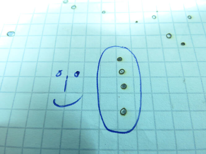

Ah, ok, didn’t know there is a pulse time. Makes it easier. I’m donwn on 5% (less ist not possible), with a short touch I can avoid burning through.
But I’m not done yet, despite the first successes.
When I move the table down to go deliberately out of focus to check if the laser is vertical (yes, it is) and my crosses still align (works), I see an oval burning in x with some blurrs in x.
So I tried to swivel the middel mirror up and down, but this seems to have no effect on that.
When I swivel the laserhead mirror the beam wanders out of the center and is no longer vertical - quite logical.
I hope I don’t have to fumble around on the first mirror…how do I check if the wide beam is centered to the apertures, looks most important to me? I can’t see the beam on paper, obviously. What’s the trick?
There wil be plenty of videos on YT, I guess? Any recommendations?

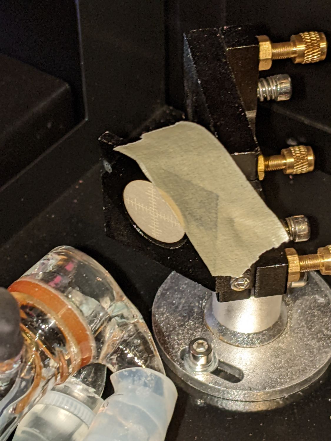

Ok, with the next try it will be dark tape and a bit more power to find and adjust the centers.
I’m looking forward to find the reason for the oval blurring.
I’ve skipped through this video:
[![](https://img.youtube.com/vi/G-HhArItCqQ/maxresdefault.jpg "How to align your mirrors on your Chinese / OMTech CO2 laser") ](https://www.youtube.com/watch?v=G-HhArItCqQ)
but there are many others.
That’s [what those short pulses are for](https://softsolder.com/2024/06/05/laser-cutter-fourth-corner-adjustment/):
[![](https://softsolder.com/wp-content/uploads/2024/06/beam-alignment-initial-m1-m2-2024-05-31.jpg) ](https://softsolder.com/wp-content/uploads/2024/06/beam-alignment-initial-m1-m2-2024-05-31.jpg)
The [targets are surely over-fancy](https://softsolder.com/2023/09/12/laser-cutter-print-and-cut-alignment-accuracy/), but I like 'em. 😁
The mirror targets mount flat on the mirror at 45° to the beam, so the scorch is elongated horizontally, but they verify the beam is centered on the mirror. You’ll also want targets [mounted perpendicular to the beam](https://softsolder.com/2023/10/03/laser-cutter-beamline-realignment/) to verify its shape at the entry to each mirror:
[![](https://softsolder.com/wp-content/uploads/2022/03/pxl_20220322_193755350-omtech-60w-laser-beam-test-mirror-1.jpg) ](https://softsolder.com/wp-content/uploads/2022/03/pxl_20220322_193755350-omtech-60w-laser-beam-test-mirror-1.jpg)
If it’s not round at Mirror 1, then there’s definitely a problem upstream of all the optics.

Ok, I did all this and it came out that the beam is kind of oval all the way before it hits the last mirror and the focusing lens.
Then I discovered the beam is not in the center of the nozzle which had the effect that the beam wasn’t perpendicular to the material, so moving out of center with z movement.
So I centered the beam everywhere as good as possible.
All this corrected it looks now quite round and cuts nicely through plywood.
